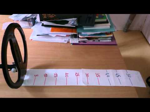

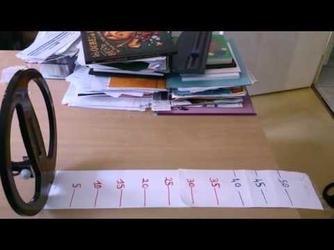

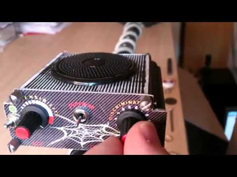

    • here is the test video of my idx pro light version without display and without multi-tone mode. Depth level is not bad on a 35 cm ring bronze.
      • blank
        • second vidéo
          • third video

                  • here is the 3rd re-encoded video, it was of poor quality on youtube.
                    • Looks pretty solid - what coil do you have on that?
                      S
                        S
                        golfnut hello, my coil is a double D 27 CM house.
