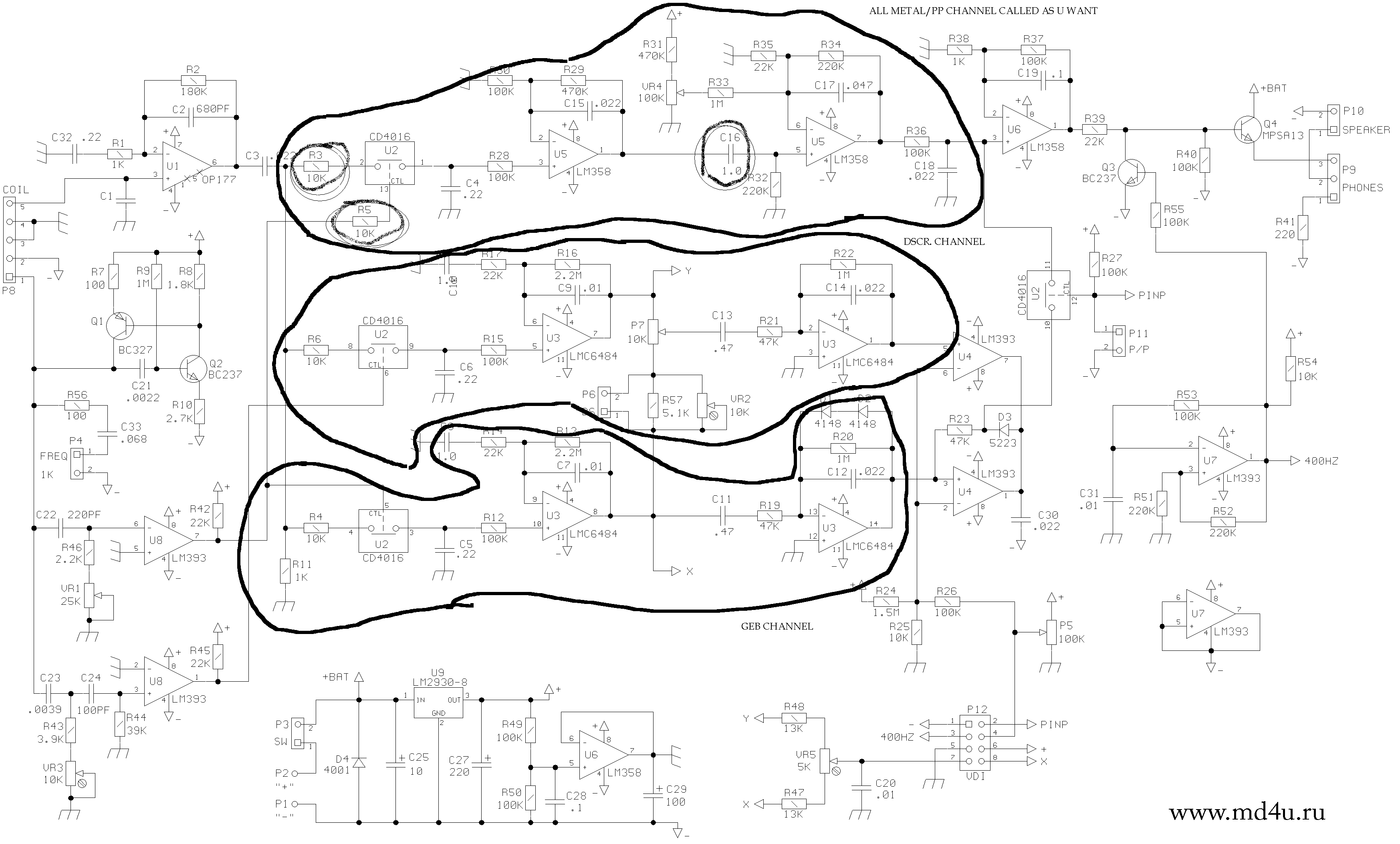

  • "golfnut: Soe how do You set your ground balance without all metal channel now? Earlier i tried too to cut all metal channel while using a discrimination by a switch. but i haven`t noticed any differents."
    There are 3 ch on IDX
    PP,
    Disc
    GEB
    I cut the PP out.
    Geb as normal
    S

        To disconect pp channel is it necessary delete those R3 and R5 resistors, it can`t be done deleting only C16 ? I`m asking because i want to use double switch of chosing all metal/discrimiantion mode, and he can also at the same time cut of C16 when you are using discrimination mode. But in all metal channell PP will works too. What do You think?
        • As always there is some plus and minus of any mod. I will try this too.
          The man good effect was raising the Tx rail.
          I dont get much advantage removing PP - it was there, I dont use it so I took it out.
          A small amout of Rx signal was being consumed needlessly, as preamp signal was being shared into 3 loads - now 2. A small amount of noise is added by PP circuit when Disc mode.
          The PP circuit is no longer clocked/gated, consumes no Rx signal, contributes no noise.
          I think you believe there is an ALL Metal Channel - there isnt.
          There is Geb, Disc and PP
          In normal Disc use all there CH are on. The PP channel is backed off a little and contributed almost nothing.
          In PP mode the Geb and Disc outputs are isolated using the cmos switch - So in PP there is only PP running.
          I would leave all the same just try the supply mod to Tx cct.

                        Man You don`t understand me at all. I know where are all channels in circut
                        I asked You twice about something else with no answer. How do You want to set up properly your Ground Balance potentiometer now in the field/terrain without working channell PP (call as you want) ?? Because we all IDX users adjusting it like this: switch to pp mode,turn the treshold to min heard, pump the coil up and down, and adjust the GEB pot. to get the same voice pumping it up and down.. and as You see without PP it is imposible.
                        • Your right, I dont get what your on about.
                          This dont mean jack to me, sorry.
                          The top Ch in the drawing does get all metals - its function is for Pin Pointing.
                          The Disc Ch with pot rotated to one extreme is the ALL Metal mode on this kit.
                          to tune up - In Disc mode, Turn Disc pot to all metal, lower the threshold for detect on Sens pot, pump now will sound if Geb not set to average out the ground return. Or another way rest tip of coil on ground and adjust geb for minimum chatter, again have threshold for detect low so you hear the ever smaller chatter.
                          PP ch is not really adding anything in normal use, as its gain is lower - the main contribution is the other 2 ch's. Which I call disc and geb.
                          when u req PP mode you flip the switch and raise the pot so the PP CH becomes live, - in this state, disc and geb ch outputs are isolated.
                          You wouldnt search in pinpoint mode for all metal as its filter is wide noisey and slow.
                          "Because we all IDX users adjusting it like this: switch to pp mode,turn the treshold to min heard, pump the coil up and down, and adjust the GEB pot. to get the same voice pumping it up and down.. and as You see without PP it is imposible."
                          I dont. Im not saying Im right either. My machine ground balances really well and No PP CH. Like any other 2 CH machine e.g. golden sabre.

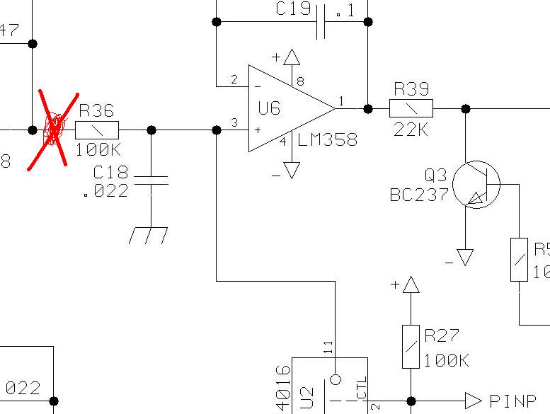

                          • Now it is clear
                            Here i just wanted to say that also tried to cut off PP while using DSCR. I put switch here:
                            But i can`t saw any difference, less noise or something, just it.
                            Your method to set up GB is new for me and for sure will try it outdoor. Just i`m not sure if i will be able to here something, now when turn tresh. and sens. to full in disc mode is silent in speaker, but maybe pumping at the ground it apears some chatter.
                            On top of that don`t You noticed less sensitivity for small object with higher Tx voltage?
                            • Now it is clear
                              I didnt observe any tangible difference either - but I never tried to measure it either.
                              Yes give it a try ground balancing really works.
                              Not observed that, found some tiny lead and bronze with 30Vpp on Tx coil.

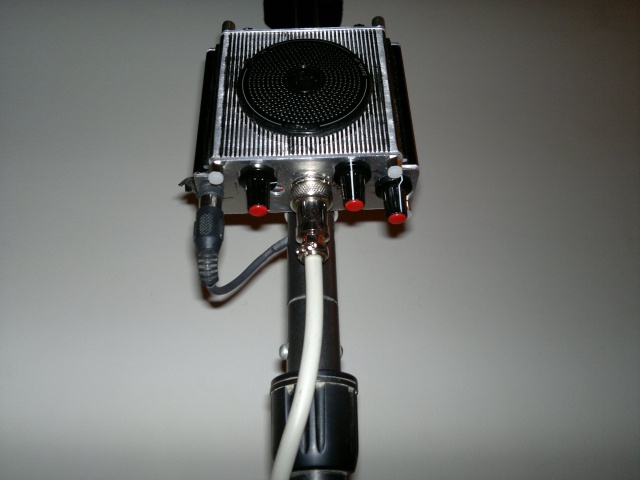

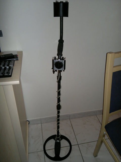

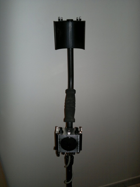

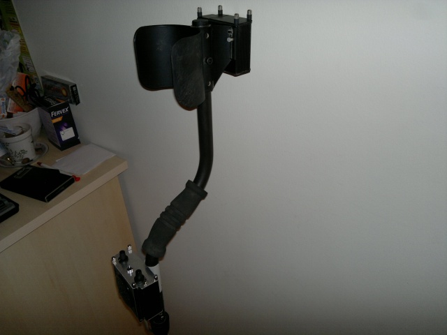

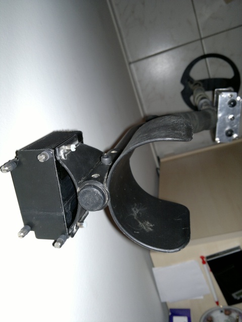

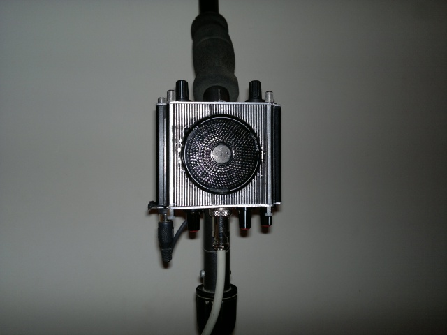

                              • hello, having finished my idx, here some photographs of my detector. it is thus the initial version without the multi mode tons and without the bill-poster and with a head D 27 CM house doubles.
