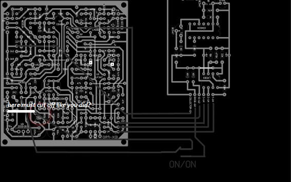

  • I guess without a coil - a mode you would not normally use for fault finding - Q2 in on, as a result, Q1's b-e junction is also on. You are then measuring the 8v supply minus Vce of Q1.
    S
    • With the coil I get almost 0v

        • Put the meter on ac with the coil on. should see about 15v AC.
          post a good pic - get access to a scope.
          Without any useful info we cant put right your error.
          S
          • I get with a working detector 16v peak to peak with a scope but when measured with a digital fluke meter on AC I get just under 4 volts and 0 volts DC that's with the coil connected.
              I read the datasheet for your chosen darlington and it has only 1/2 of the gain of the designed part.
              S
              Just an update to say it worked
              MPSA13 arrived yesterday been testing and much better THANKS again
              It's near enough twice the detection range on both PP and Disc modes than an original "Classic I" using the same coil. More than happy
              Might be getting greedy here but I think there might be less missed marginal targets in the real world a bit more punchy audio.

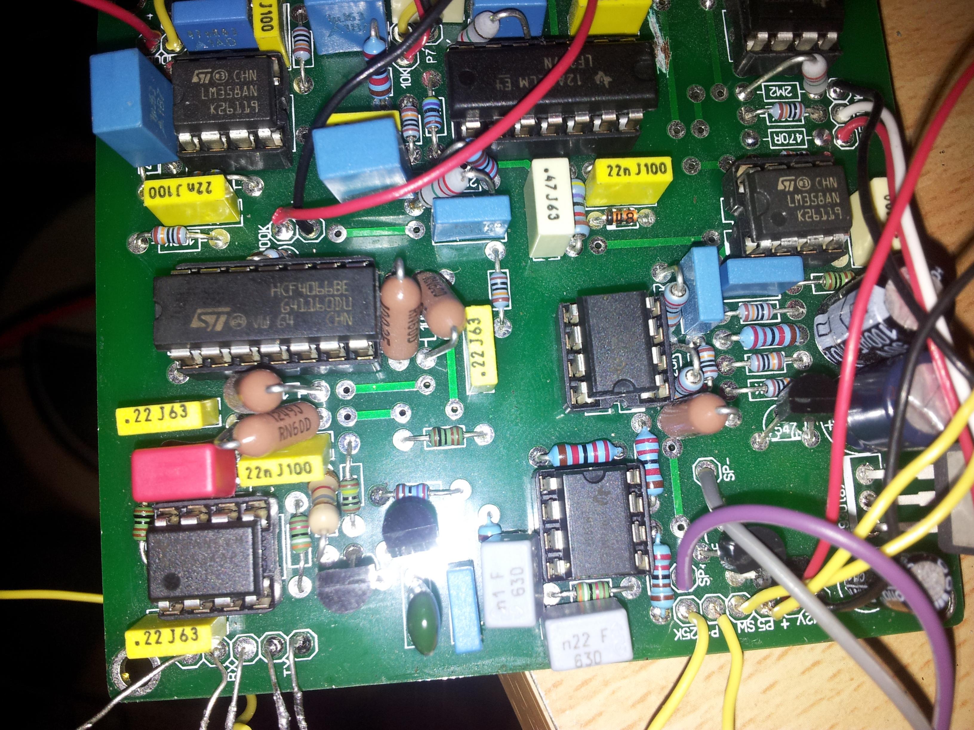

                    • Ok so I have 0.04v ac with coil.
                      I am going to go to my local electronic repair shop and see what it would take to do a couple of tests with a oscilloscope.
                      This is my board.
                      • Did you use BC327 BC547 or equivalents some of the equivalents have different pinouts. Check they are in the right placement. Is the missing resistor top right on the other side of the board. Have you measured the + and - volts of the PSU.

                          Replace the 39k on the Tx oscillator with a 39 ohm
