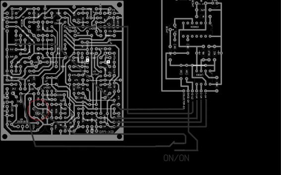

                        • Originally posted by Schatztaucher View Post
                          [ATTACH]25731[/ATTACH]
                          sorry, my picture is not correct!! i need more times to make it new!!
                            oh ok mate no problem.when you finish can send me PM
                            • now its correct i think....you have to do this little modification
