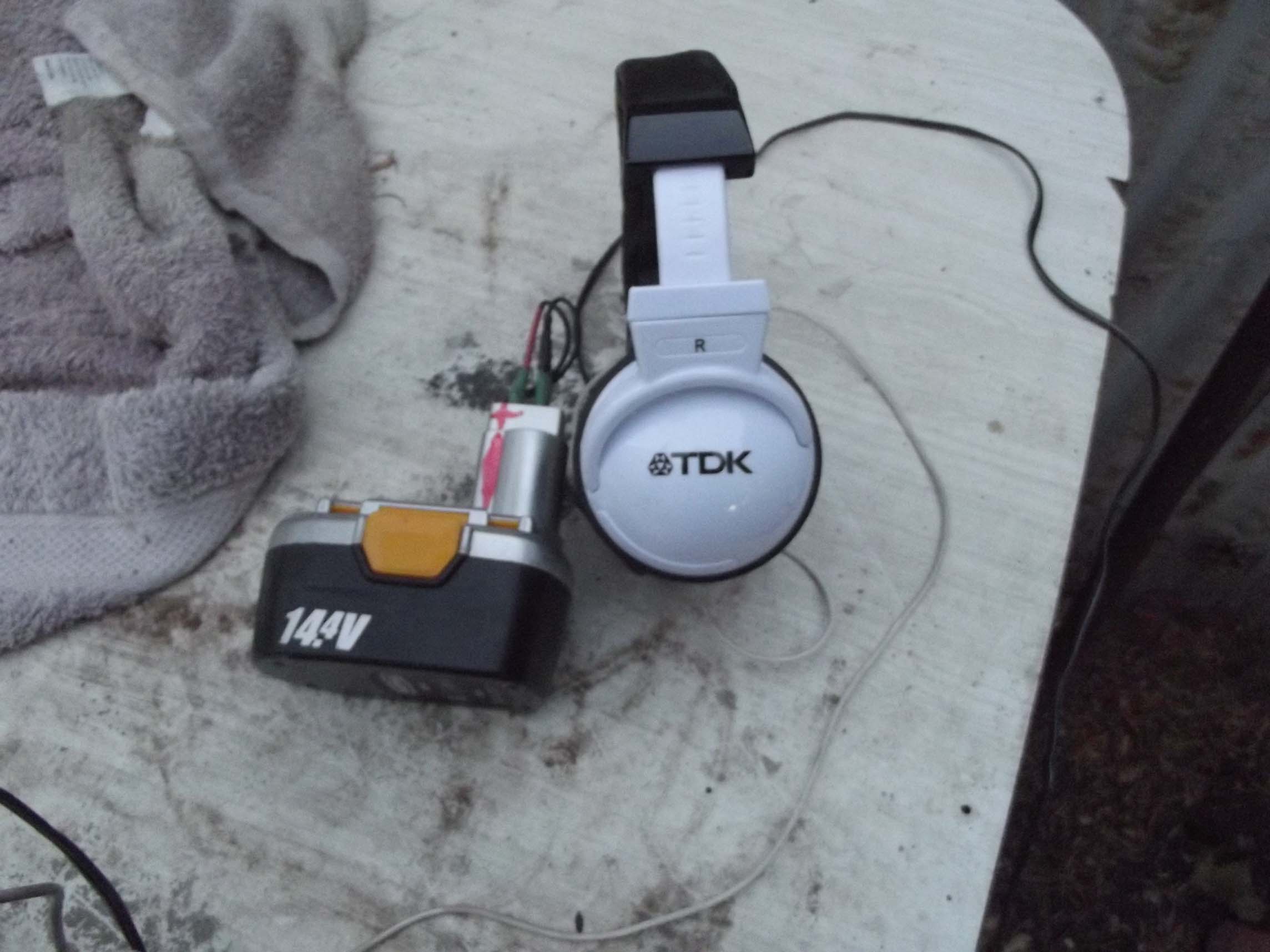

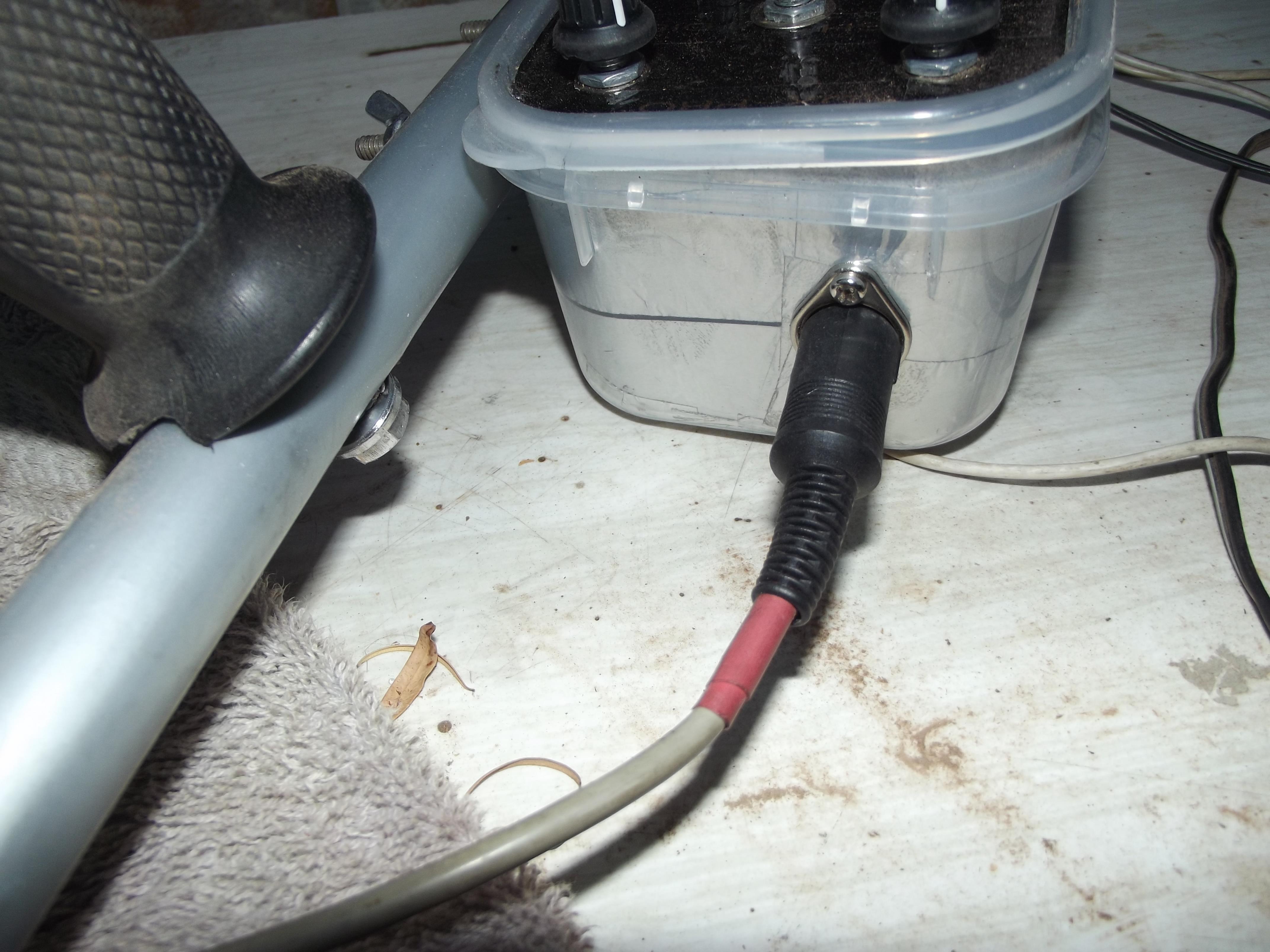

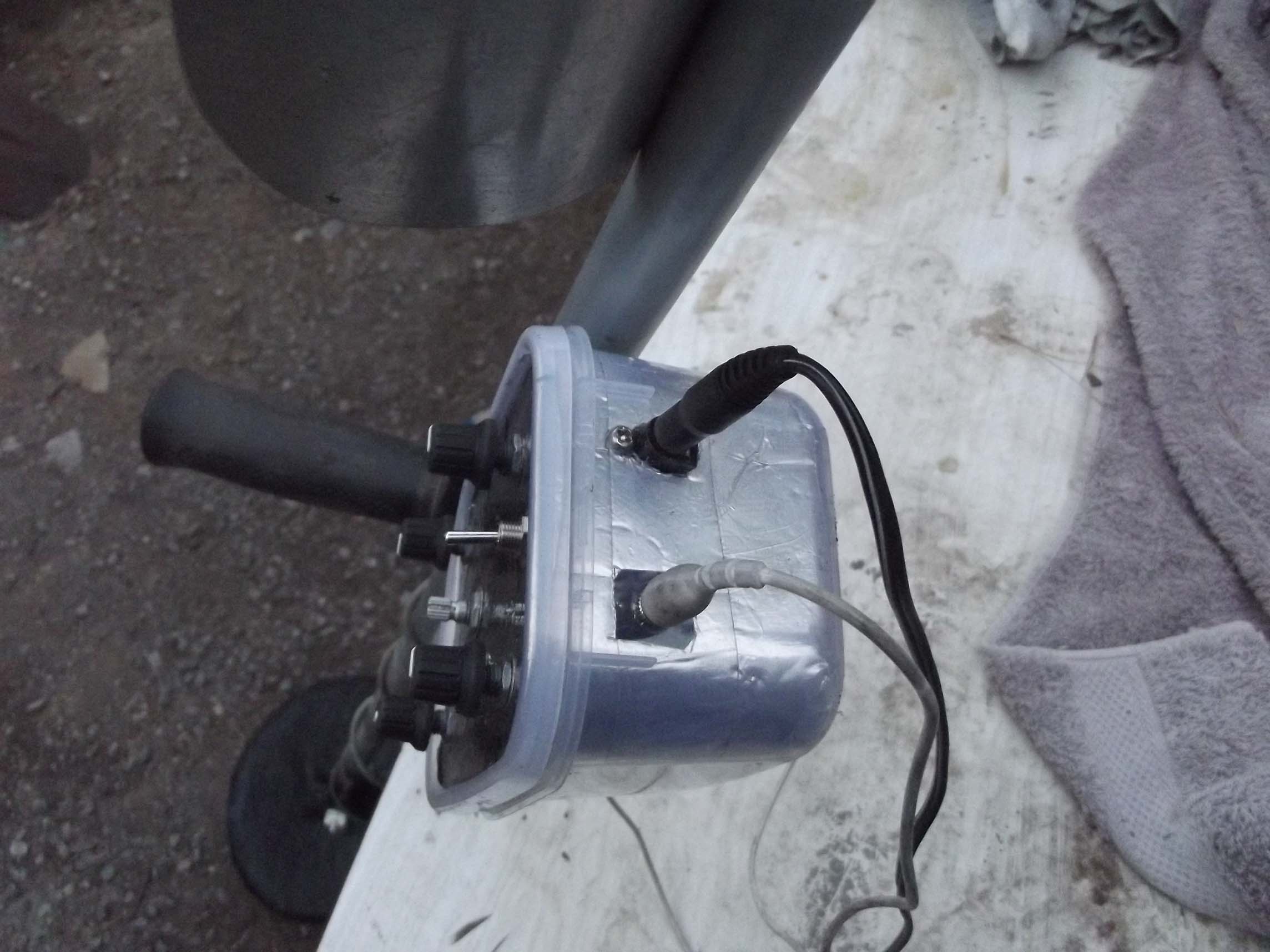

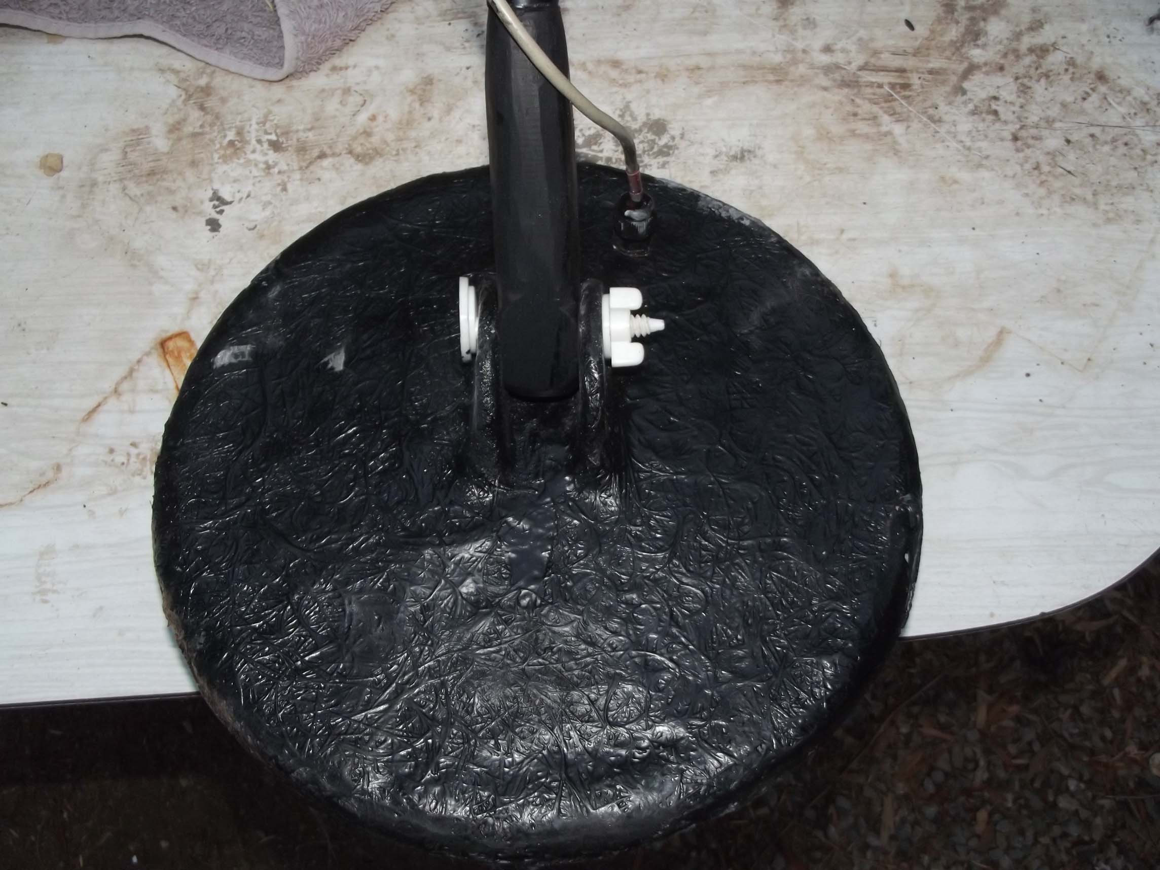

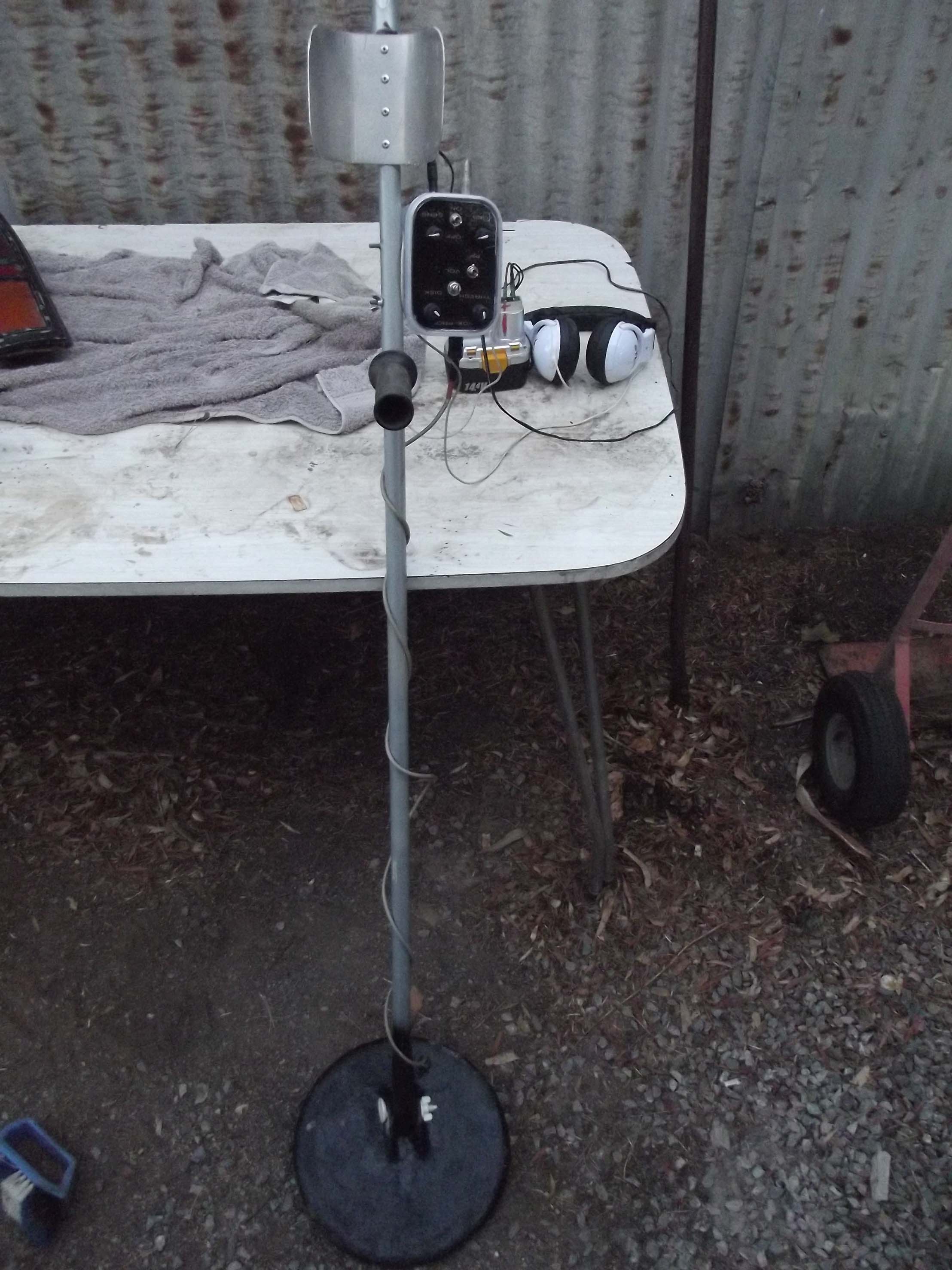

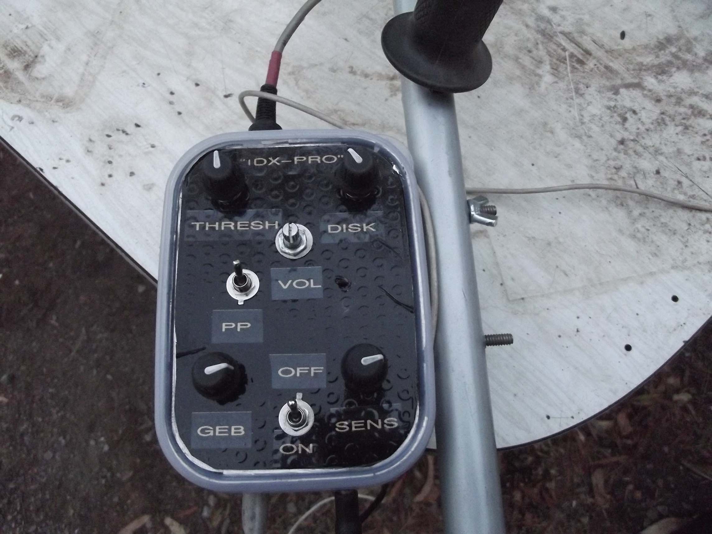

    HI ALL ,,& MANY THANKS To those who helped me ,including ,EDUARDO ,who srarted this IDX thread ,STEVE,DON,KOALA ,Silver-Dollar ,,ETC ETC ..GREAT STUFF BY ALL..
    THIS is my fist ''AUSSIE-ROUGH'' DIY detector & it works!! Not sure how good as yet not time to test yet but it seems Ok outside of the Shed ..

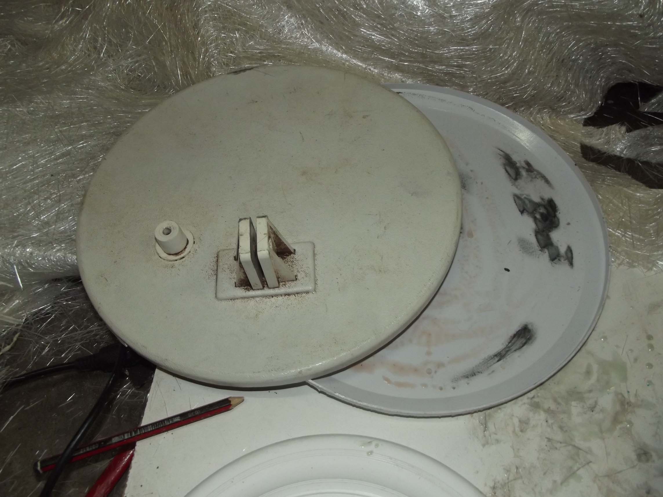

    MY Fibre-glass Shell with the coils & bottom attatched is Quite heavy !!
    My next coil will be lighter as I have now 0.2mm wire for RX ,where as this coil RX is from 0.32mm ..
    The pole-wand was a quick 1/2 hour job an old Mop handle with a wooden piece to attatch to shell ;With Toilet Bolt .HA,Haaar..,alluminium arm rest pop rivetted etc etc..

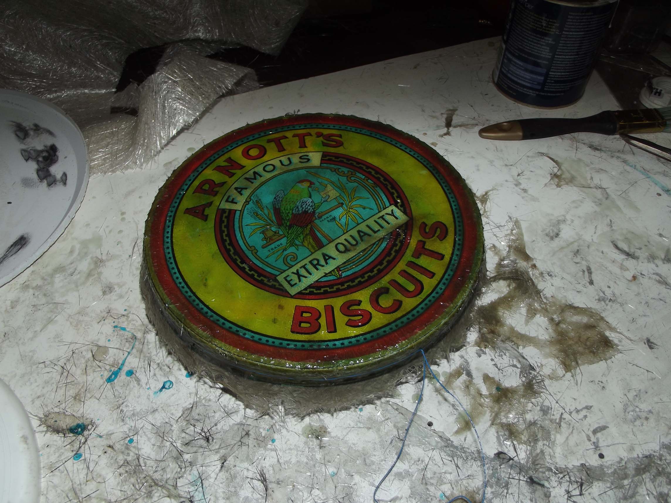

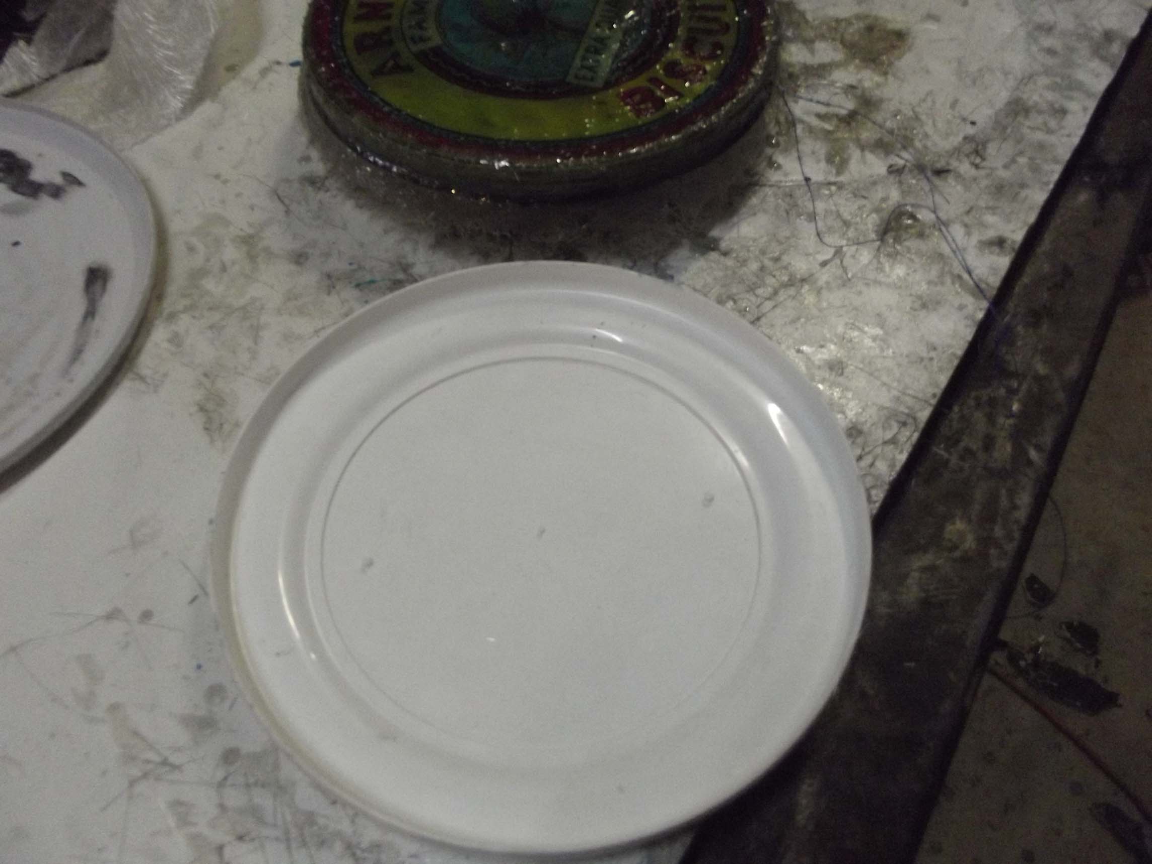

    A couple pics above of my next coil shell ,1 of the coil I dismantled for the shell is 9.1/2'' & making a bottom for another 8'' ..
    CHEERS TO ALL ,,,,,,,,,,BARRY..

    • Looks good! One of the drawbacks to fiberglass is the weight.
      The coil housing is the toughest to make light and strong without extra weight....
      Good luck using it.

        • Well done for sticking at it.
          Does it reject ferrite using the geb control?
          If you bob it up and down over your earth can you get to no tone using the geb control?
          Does it reject iron with the Disc control?
          When set to JUST reject clean small iron does it ACCEPT all of the metals you want to find?
          Do you feel you have acceptable air range to a mid size non clad coin?
          If the above interrogation is all yes's - you should be home and dry, what you have done Barry, is what this forum is about.
          Go and have some fun with it, with that cordless battery you will need to charge - ANNUALLY..
          Post us pics of some early Aussie coinage... But dont find gold or we all will be real jealous!!
          Low and slow mate, low and slow
          Steve
                HI STEVE THANKS MATE YES it doed reject ferrite with geb but with a 10k in series & then about 12-1-0clock..
                Yes it rejects small clean screw at about 10-oclock ..
                YES it detects non ferris & coins ..
                I would like to ask you about the 1 uf cap c16??? on your earlier read mods to short it out& or remove???? using 2x pole switch ,To explain I shorted it out but then got a constant tone so I have left as is ..
                WELL today I had to go to ADELAIDE 200ks Sth ,, Whilst there I picked up my order of Wire which I found nice people [suppliers to motor rewinders] 1 kilo of 0.2mm wire [Thats a dam lot of RX wire] But it cost only $33.00 Aud ..He thew-in 1/2 kilo of 0.7 mm for free[ I like him Great bloke] I offered to pay but he said have fun with-it ..
                I also bought a Can of correct wire potting spray [$15.00] ISONEL-POLYESTER -INSULATION, as used by motor rewinders .. would still use initial dabs of super-glue etc etc..
                I then called into my favorite electronics store for 5 metres of beldin-8723 cable..
                SO mate I will build another couple coils to try-out soon ..A slightly smaller DD & DONS coplaner ..
                THE air test is about 20-25cm not as good as most on here but it was the best I could get & retain the geb control ..
                With the ground reject I needed to run the Geb at approx 3 oclock ????
                But it detects very small objects ,But not tried it with buried coins [No time as yet].
                I am very pleased to have gotten this running ,But with-out This site & advice from You & others I would have been lost ..
                I need to try-out on some plastic sheet to see if my Graphite mix works on covers for concentric coil ..& try for the magic Resistance ????
                Steve
                SORRY I got your Quote mixed-up ..
                BATTERY YES I have many good GEL-CELL 12 7amp hour but a bit heavy so I will try the 14.4v drill batt as seen ..
                CHEERS TO ALL ,,,,,,,,,,,,,,,,BARRY..
