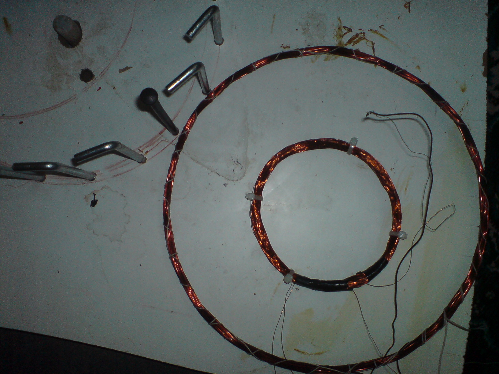

        any way i am today make concentric coplaner coil and it is finish, this coil is need shielding? how connect shielding to TX RX and BX coil? ( i think dont need)
        TX 510UH
        RX 35mh

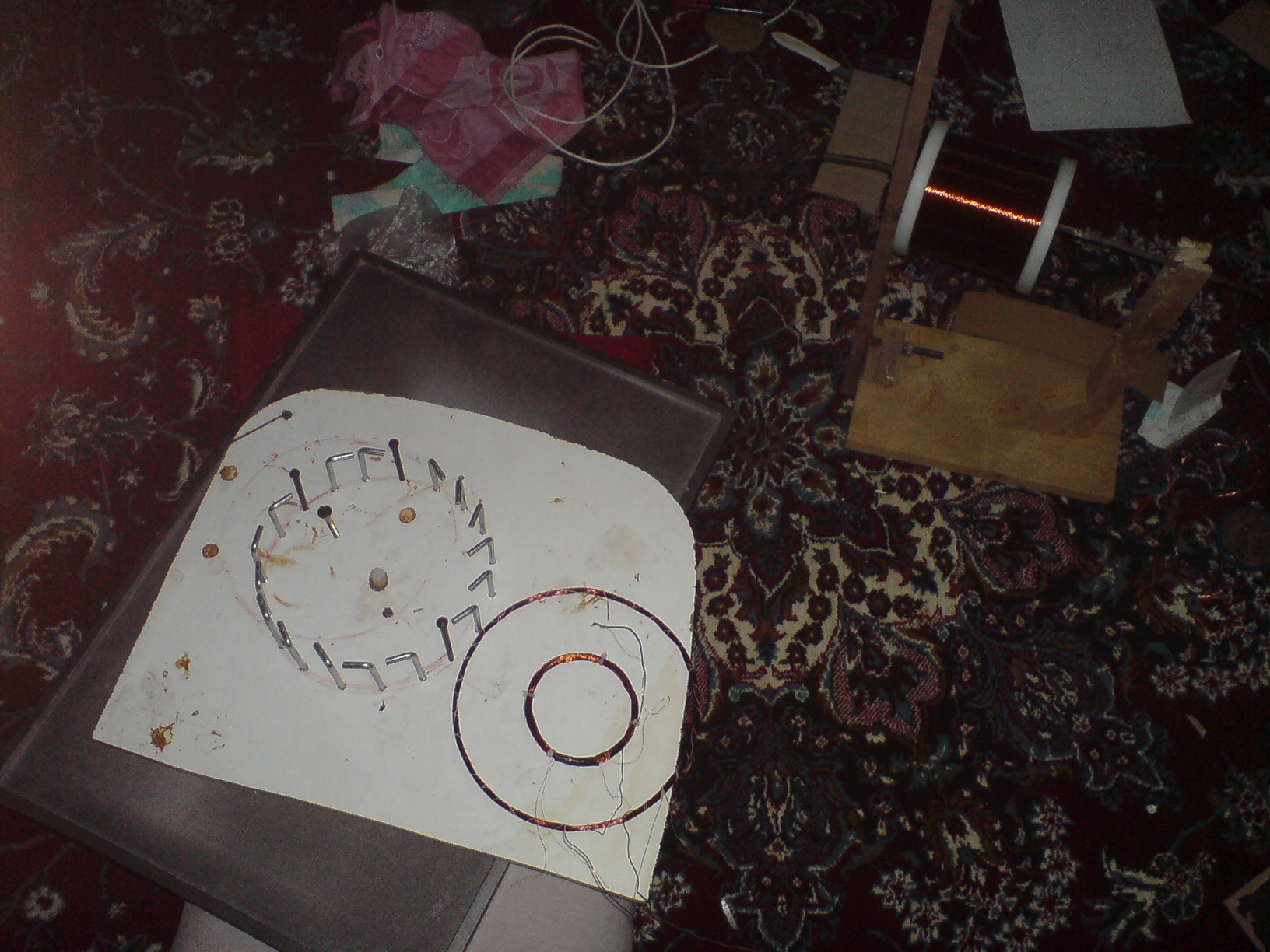

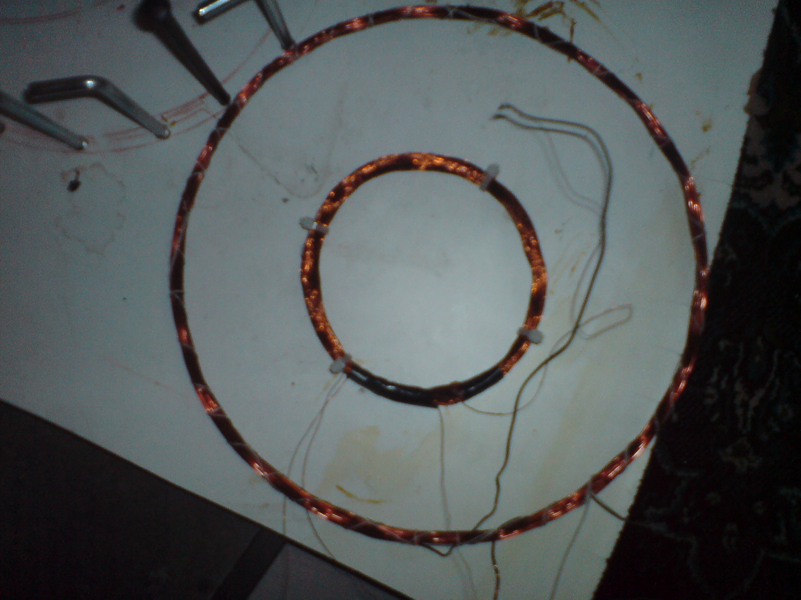

          • Concentric Coplaner coil
            hi guru
            i finish the coils but neeed connection to the board and together
            please show me.

              hi guru
              please show me.
              [ATTACH]26949[/ATTACH][ATTACH]26950[/ATTACH][ATTACH]26951[/ATTACH]

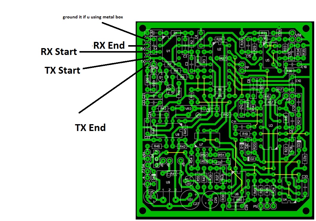

              do you mean connection like this
Name:	Connection TX RX.jpg

                    Shielding is very important in the real world.
                    If the coil is still on the bench for testing less so.
                    I used post 1348 worked first time for me
                    Connecting the coil connector and pots to the outer edge of the PCB board made my detector more consistent and stable. Might even be marginal deeper
                    Same for DD wind both the same way and mark the start ( I tied a knot in the start)

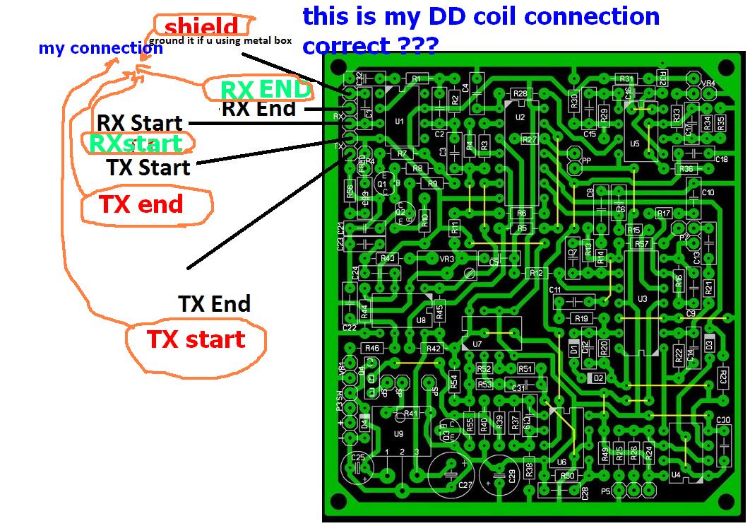

                    • Oh
                      i think my connection for DD coil is wrong
                      just for TX coil error .(start in P8-1 and end in P8-2), i INVERSE soldering on the board please see the pic and you see my write by Red and Green and Blue colors.
                      ok i shielding CC coil and connect it, befor say me #1926 correct?or my connection correct(sorry mr paku become i have UNCERTAINTY connection)

                      • I get
                        Shield
                        RX End
                        RX Start
                        TX End
                        TX Start
                        Not too important you get a double beep swap the RX over.
                        All the best with your new coil.

                            • I think the same as Koala - dont get hung up on Start and End of windings....
                              If when you test it you get a double beep from a coin pass you can either
                              Reverse the Rx coil teminations ( this phases th Rx signal 180 about )
                              OR
                              Reverse the Tx coil terminations this does the same - do not reverse both or you will be back at the start.
                              Get the best Null you can before you pot it and dont have the coils near metal while adjusting.
                              Test with ferrite to assess ground reject.
                              Test with Iron for Iron reject.
                              Test with gold, silver, bronze for targets you want.
                              Only when Iron can Disc out
                              Only when Ferrite can be remove
                              and
                              Only when accept all wanted alloys with single beep on pass
                              THEN Pot it and finish off
                              Otherwise you make lots of scrap coils and the hobby turns a bit dull
