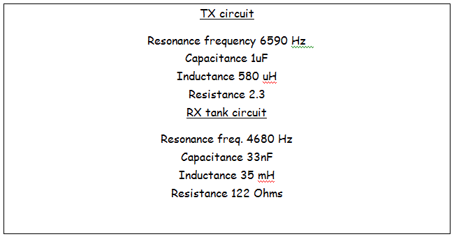

    • Hi Barry. I found that the Tx wire size mattered more than Rx.. if Tx is too small you do not get full tx amplitude. If too large it becomes difficult to work with. I built two concentrics for the Idx with different wire sizes for the rx and could not tell any difference except the value of R was a little off. Hope you are staying cool down there in aussie land! Its plenty cold up here!
      Don..
      • THANKyou THOMAS for that information ..
        Nice calculator ..

          OK I am doing a DD coil [1st attempt] I used 0.7 wire for TX it ended up OK as to resistance reading & mH come out ok [Did the test as Silver-Dollar described with the S/GEN & my old single scope & 1 uf cap seems around the camp 6.5-6.6 Khz..
          But for RX coil still unfinished I wound 290 Turns of 0.24mm wire as I had it here to use for TGSL now not doing that so used it for IDX DD.., I am yet to tighten up coil for a test mH reading !!]
          But as it is Its close to the readings You describe for RX ..I will report back after More work on it ..
          Can I do a similar test for RX as I did with the TX using the Signal Gen & scope & cap trials ,If so what frequency am I looking to obtain?????DID I read 4900hz ?????ie 4.9 khz????

          • Thicker TX wire changes the "Q" in a good way. The lesser resistance helps with creating a stronger field.
            On RX the thinner wire is actually better as the increased resistance matches impedance better for
            less noise. Of course these are just guidelines for making the best you can. I used 0.25 mm wire for
            both coils on my TGSL (but found out the wire was more like 0.22 mm) but since reading about
            IGSL have made a 0.55 mm TX coil and a real 0.25 mm RX with lots more windings.
            The trick is that no matter what you do some coils come out better than others so build one and glue
            it but be prepared to throw it away if it doesn't work well. I think Ivonic tossed 1 out of 4. The difference
            between a good one and bad one is depth and or noise.
