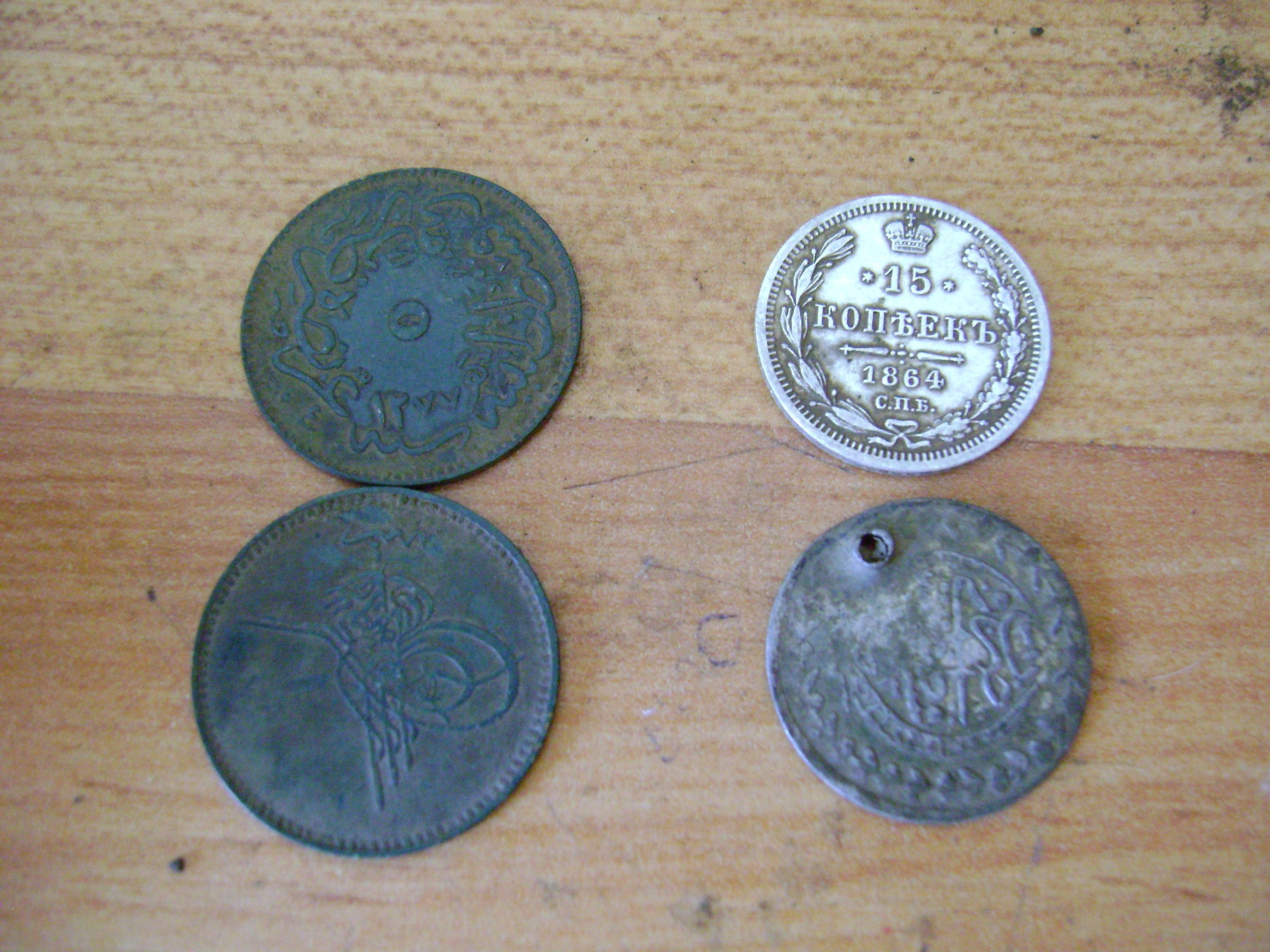

                              • Thank you Koala for advice. You are absolutely right about discrimination practice.This is my first "treasure" found with IDX. Audio signal for silver coins was clean and smooth. Click image for larger version
