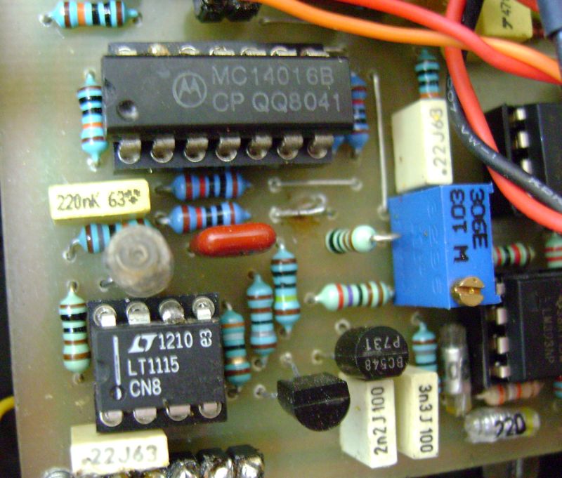

      Hello mate where you put LT1115 in place of ne5534??
      • Yes, i replaced the NE5534 with LT1115.The results are better.

        • Originally posted by yo4hfu View Post
          My PCB: [ATTACH]33518[/ATTACH]
          Nice mate,did you change more componets??i dont understand where you
          put smd tantalum cap,can you make better pic of your PCB mate??
          • I put capacitors between +/- power supply and ground only for stability reason. Here you have some pics: PCB, PCB LT1115 detail.
            SMD ceramic capacitors = 100nF
            Yellow cable is + TX Oscillator for Power TX switch.
            Other modification: 4066 replaced with 4016 (low leakage switch) and Sensitivity adjust simplified.
            Bonus - one photo with phase shift between RX signal (U1 pin 6) and GB/DISC sampling switches: Phase Sampling
            RX signal and Ground Balance signal are in quadrature.

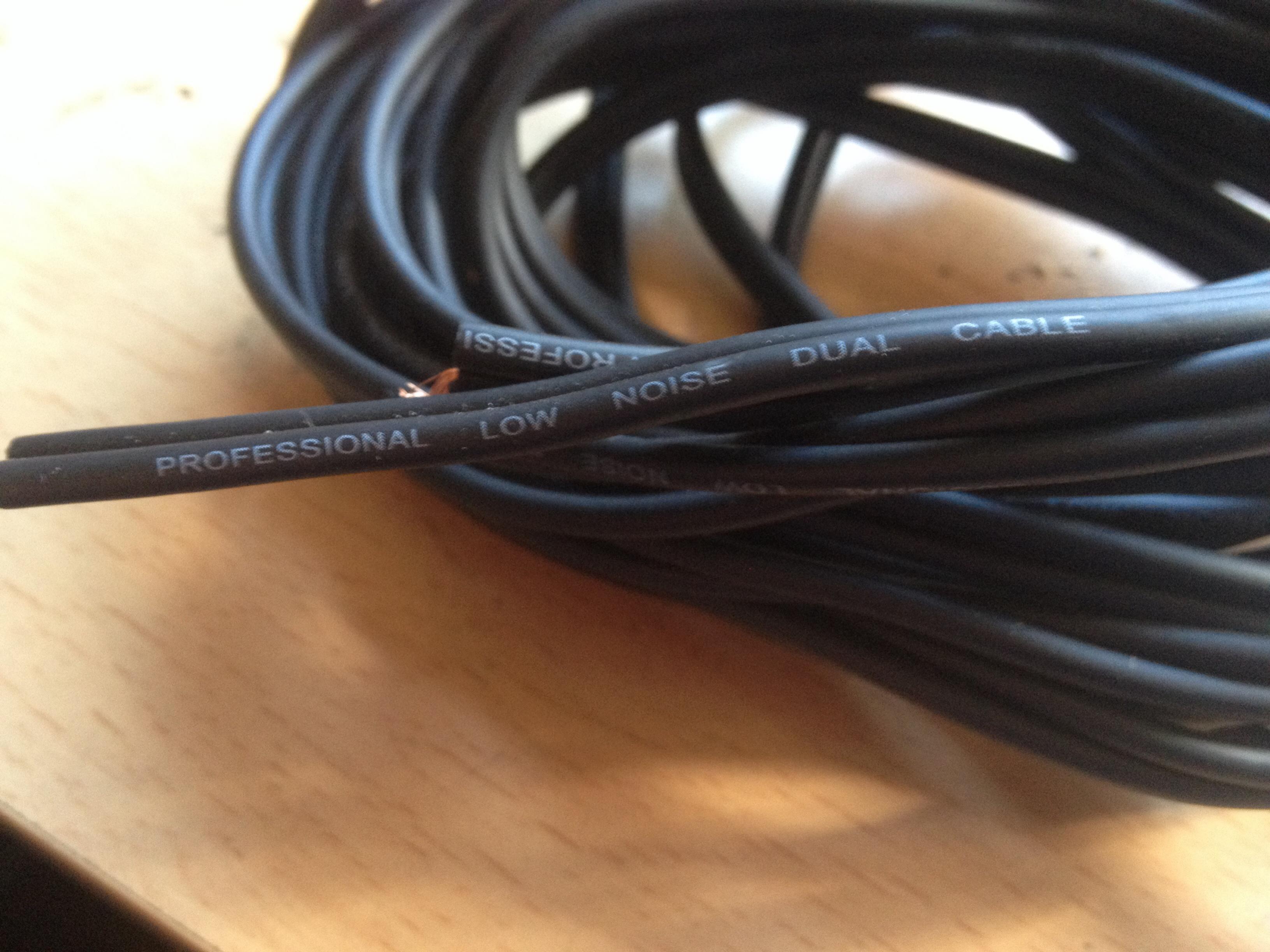

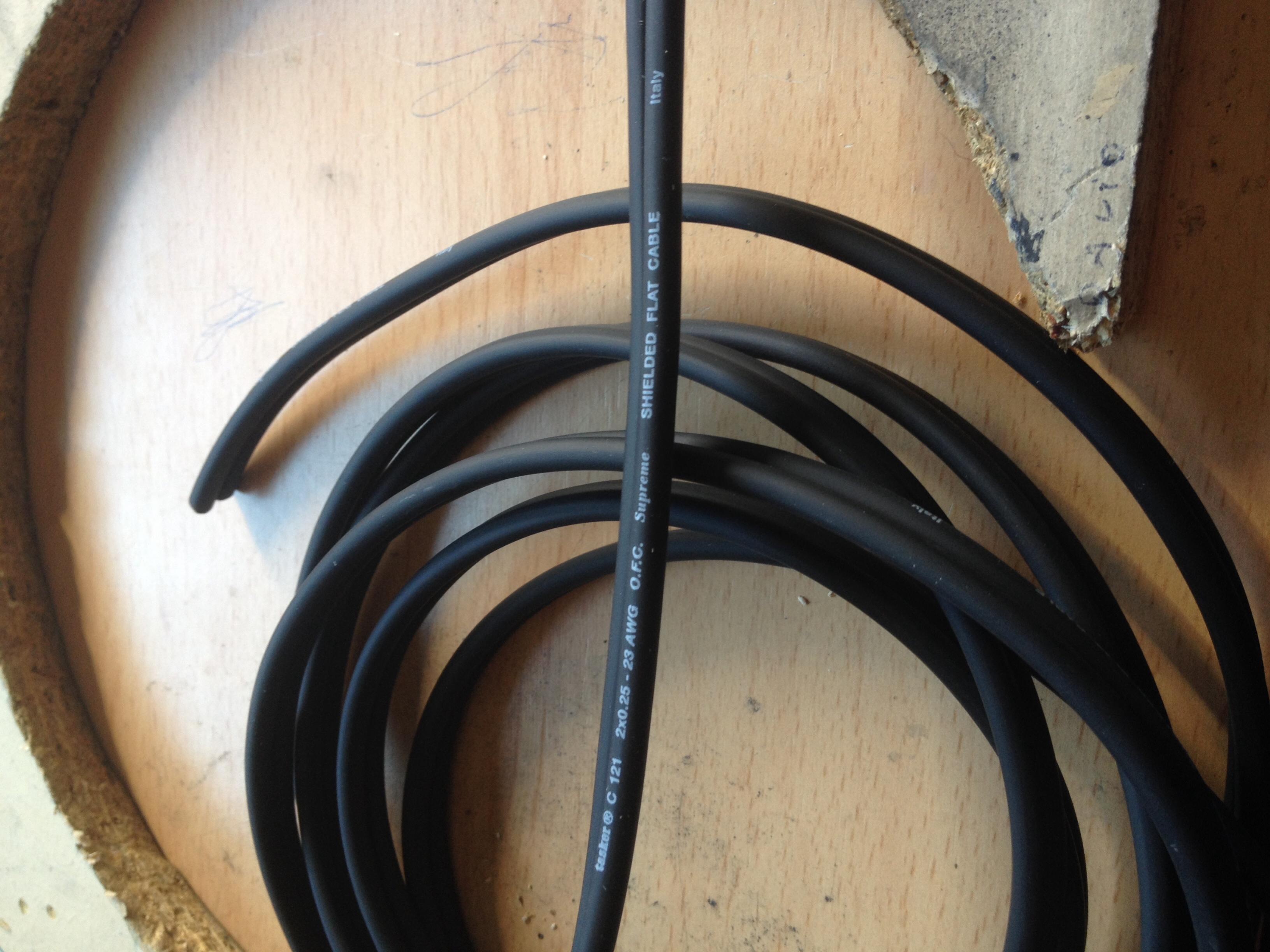

                            • Can I use Garrett gtax coil at 7 khz? Is it with capacitators inside the plate and what is inductance of rx and TX?

                                .hello the problem is solved by changing the LM393, thanks for your cooperation, lack of proper cable being'm with these two questions, some help I could do, thanks
