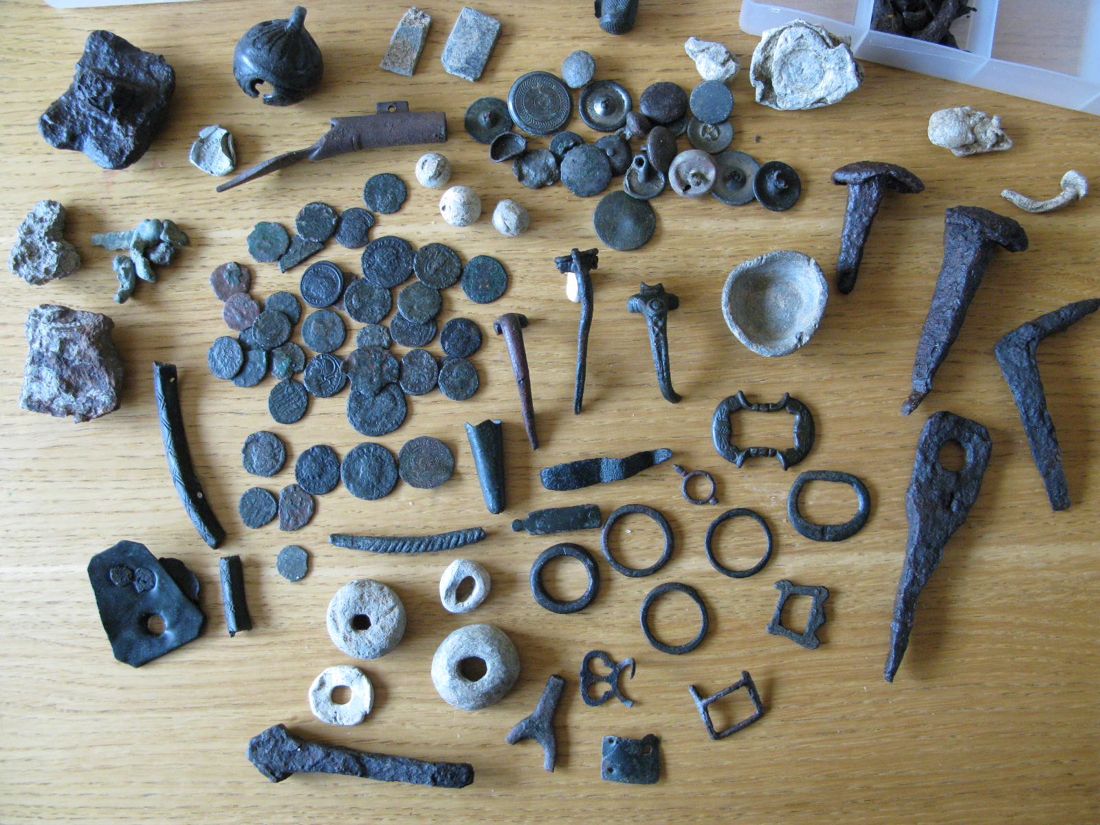

                                keep trying they do pull some things in... like this...
