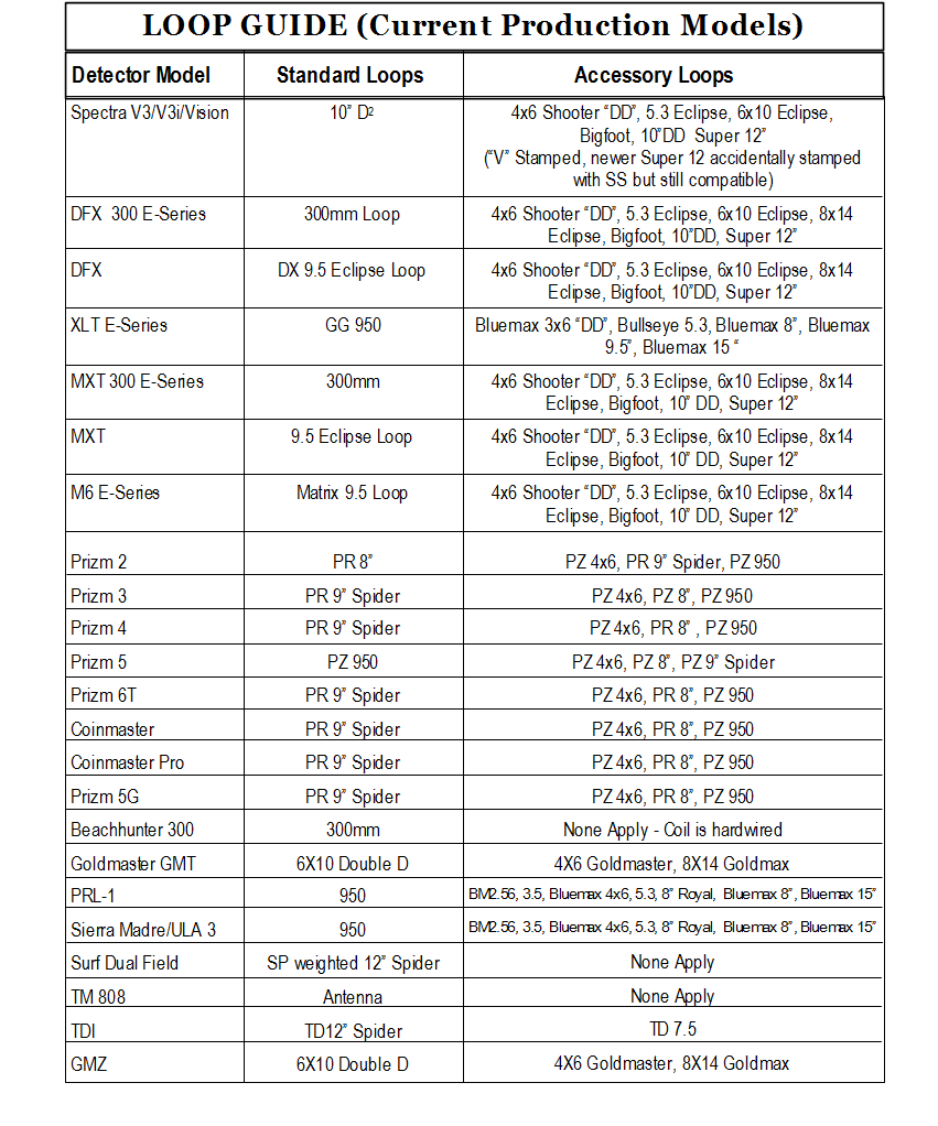

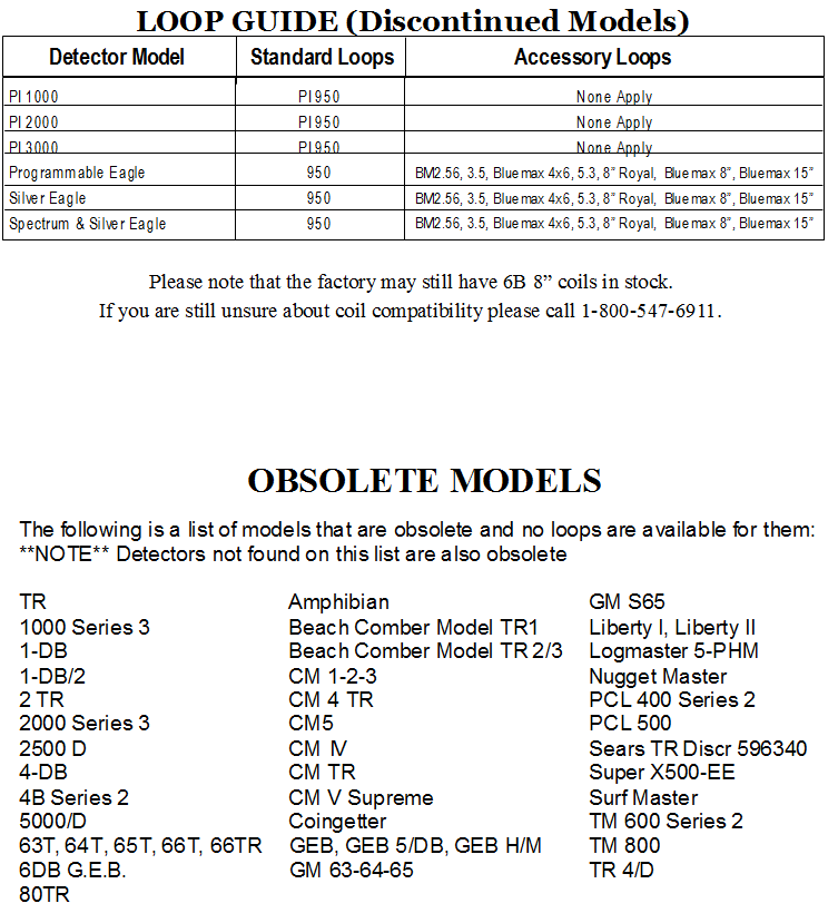

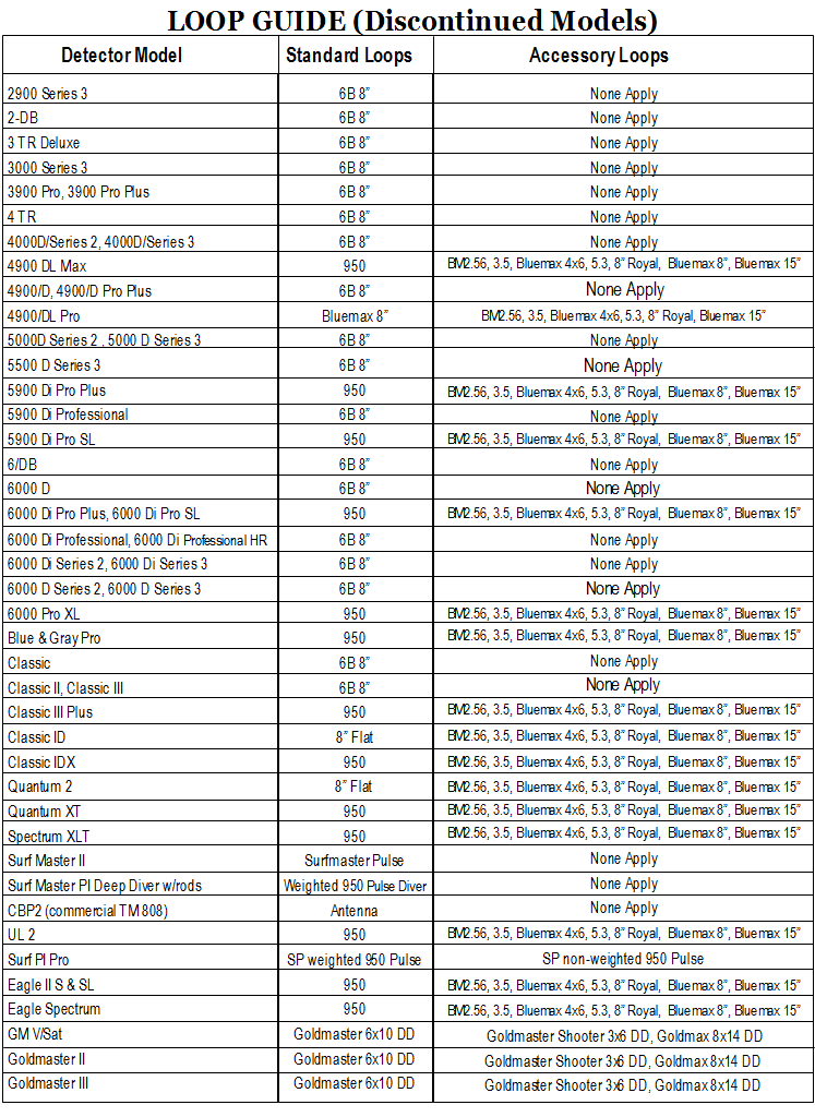

                      • hey does anyone have the wire schem for the blue max 950 I guess whites says it will work for the IDX so I would like to try it out. please and thanks guys.
                        • I guess I was asking for pinouts for whites 950 blue max coils or maybe someone knows how to test to figure it out. carl you used to work there do you know anything about it?
                          • Yes the 950 is an excellent coil for the IDX
                            TX has much lower resistance the RX
                            Should take to much experimentation TX wrong way round and it will not null. RX wrong way round and it will work fine but double beep.
                            • sounds easy enough to figure out thanks and I thought this coil would work so im very happy thank you for the help.
