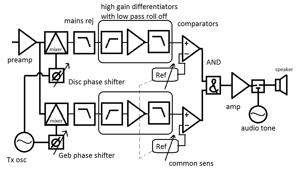

    • some peopl like block diags rather than unpicking schematics,
      Here is a simple block of these type of machines

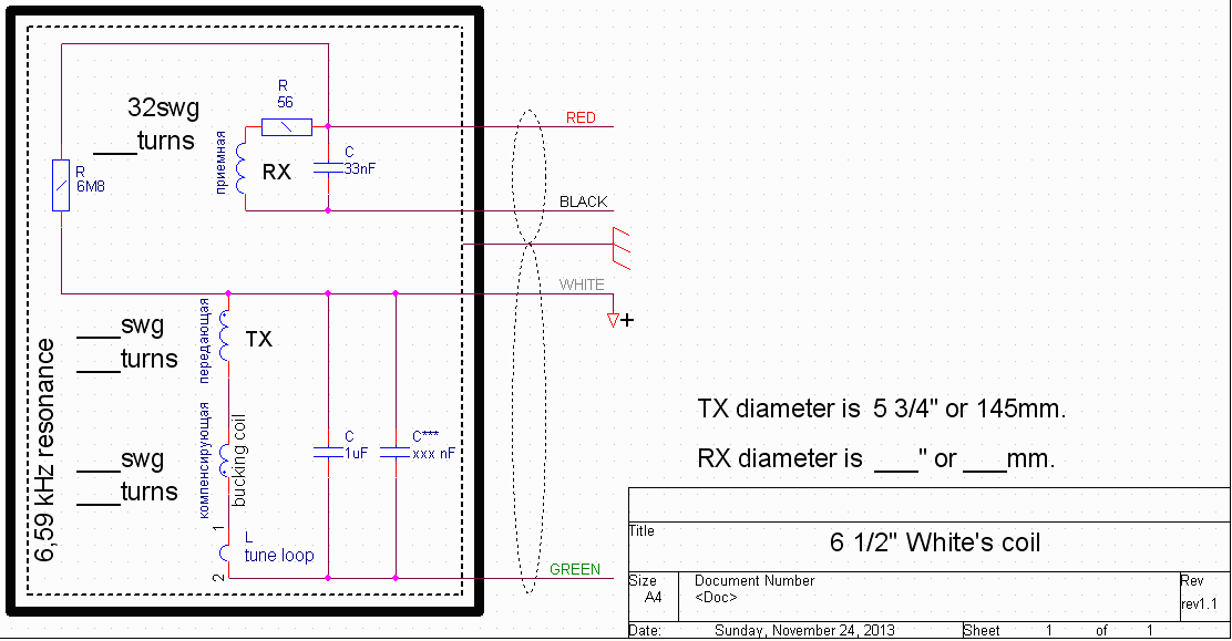

      • Given the complexity and the difficulty I had for proper coil for TGSL, I'll buy a coil for IDX pro. I already have the PCB and components.
        Does anyone could give me the connection diagram of the blue max 950 LOOP white's original?
        Is it with my inductance meter I can identify TX and RX coils knowing that there are parallel capacitor?
        Thank you to you
        • the low resistance one is tx
          • connections are here
            Getting hold of the correct connector is both expensive and a PITA
            If I was you I would use a cut the original connector off and change for a standard aviation connector you can get a set of 5 (10 pieces) for the price of one original slimline connector
            • Thank you golfnut et Koala

                • Well on the Bandito (10 khz) I was able to use the Tracker Coil (6.6 khz) but had to remove the
                  TX cap in the coil housing and change a TX cap and the RX cap. I am now running it at 12.5 khz.
                  ( Tracker Coil - TX 2.7 mh RX 2.4 mh Original Bandito Coil - TX 6 mh RX 6.5 mh)
                  The problem is that White's coils typically cross couple the RX and TX with caps and resistors in the coil.
                  So you might need to mess around with that coupling on the new coil....
                  http://www.geotech1.com/forums/attac...7&d=1385260803
