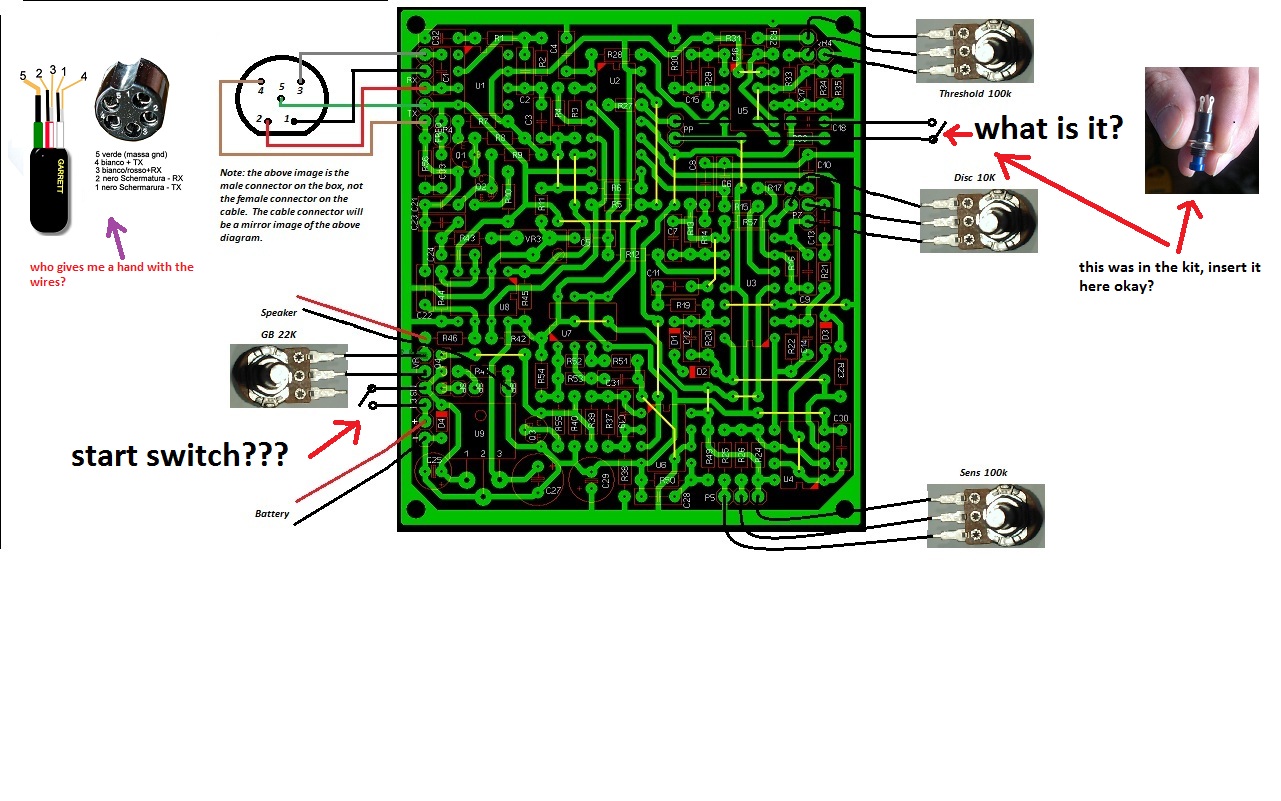

    • hello guys, and I finally 'got the kit to build, but' I have not found any pattern inside. you have some scheme recently so I can check?
      • Originally posted by fabio-evo View Post
        [ATTACH]28882[/ATTACH]
        Should be same as post 1,117
        • Thanks :-)

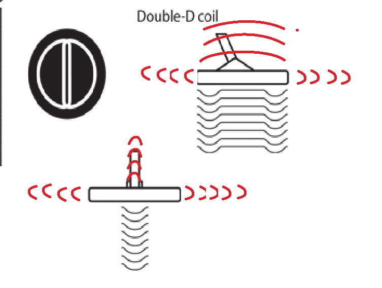

                • HI everyone!
                  In this weekend I finaly made a field test with Silverdog PCB + my DIY DD 27.5 coil.
                  In the first place(near from amatier airport) detector was realy noisy- unusable, in the second place (in forest) it was more stable, but i notice 2 things:
                  1. When i move coil wire (microphone wire 4x + shielding) i got beep, beep. it is normal? (The coil reacts to coil wire movment)
                  2. My home made 27.5 DD coil has 3 responding zones - abowe, below and from the sides.??
                  • Originally posted by Valters View Post
                    HI everyone!
                    [ATTACH]28950[/ATTACH]
                    You need to try and stop the cable moving on most metal detectors as its metal!! I wrap them around the shaft once I have extended the head to the length I require. Then I use cable ties, top and bottom to help further....
                    But I am no expert, so I will be watching and seeing how others do it.

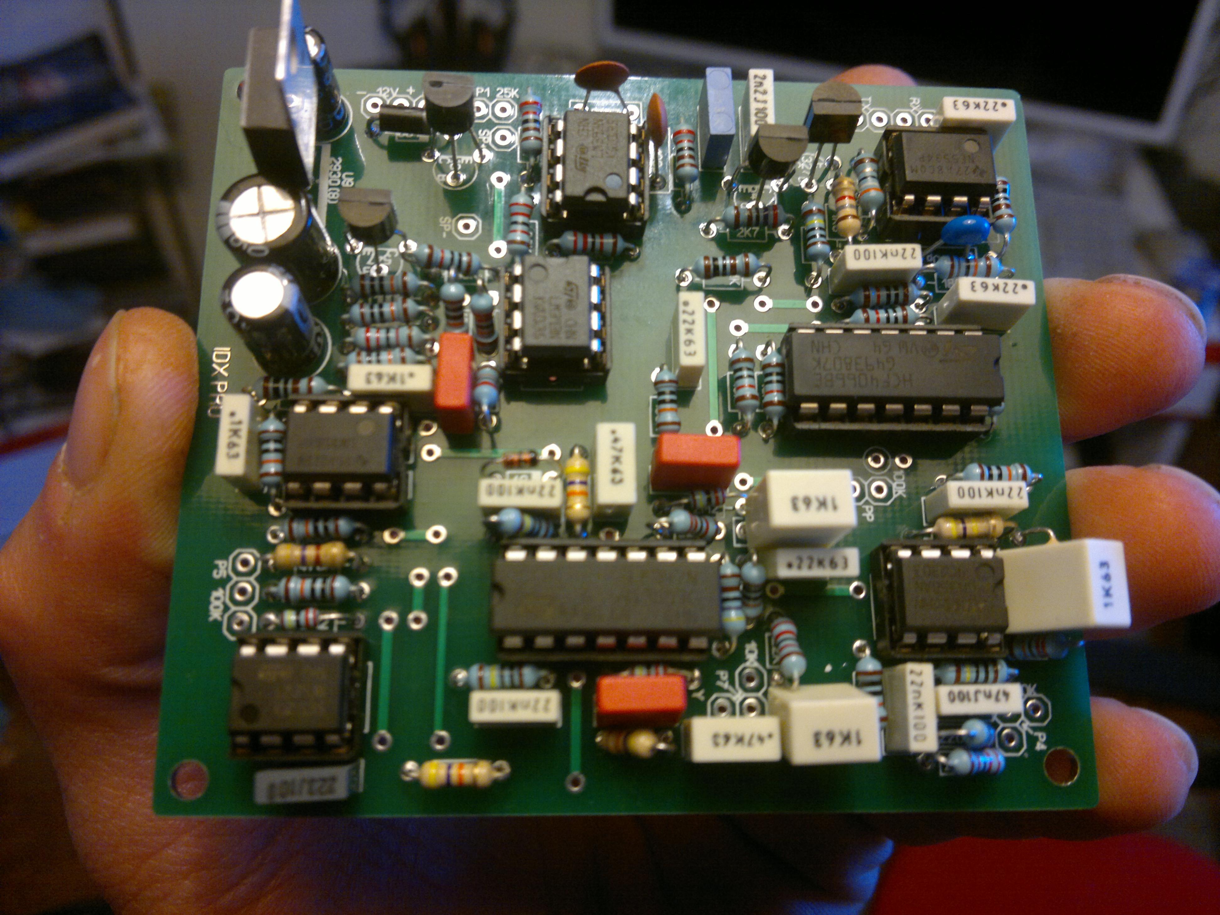

                    • hello guys, I started to assemble the components in the kit ... I noticed that I was missing 2 capacitors, a 22n and 3n3, fortunately I've already bought and installed. Later I connect the potentiometers, later I will 'help to connect garrett the plate, but I struggle to find its connector. :-)
                        HI everyone!
                        1 yes normal any movement of the cable need to be stopped I use some rubber bands but you can just rap the cable around the shaft.
                        2 yes normal does mean you can not detect right up to a metal fence with this type coil

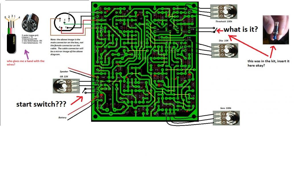

                          • guys take a look at the files that you enclose, I have some things to ask, i would also help with the threads of the plate (experiment).
                            have patience I'm learning thanks : )
                              [ATTACH=CONFIG]28973[/ATTACH]
                              for all questions your answer is yes
                              • thanks for the reply, but the button kit to what you need, ie 'what charge?
