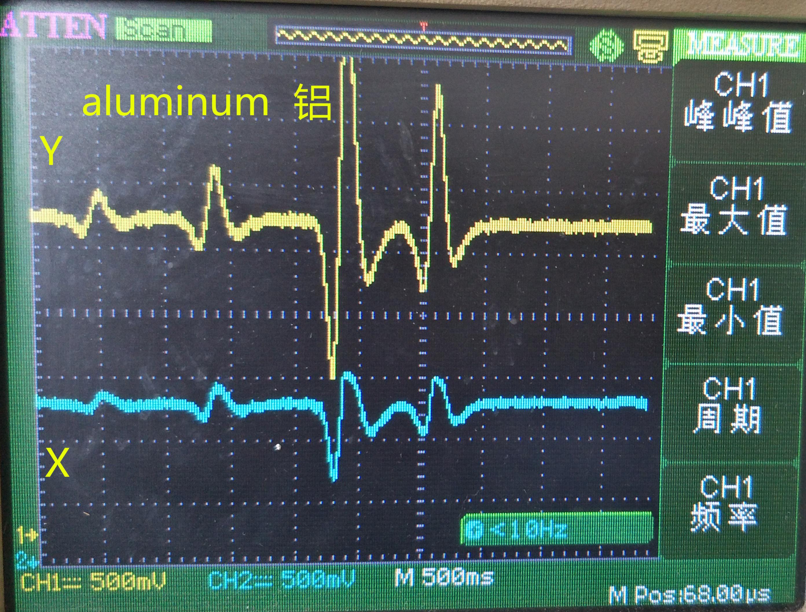

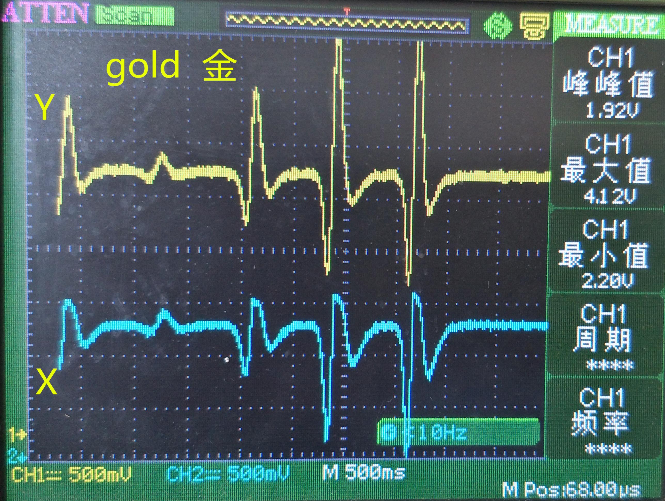

              This is to use an oscilloscope to measure the signal
              My VDI is wrong
              I found that the signal is different from the program
              The program is written to
              if (sensorValuex > 5 )
              My signal is that the small one is not big.
              Excuse me, there's a problem there.
