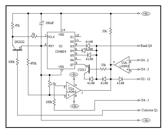

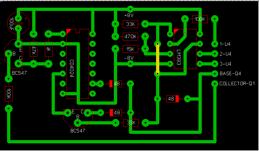

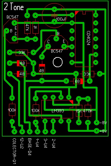

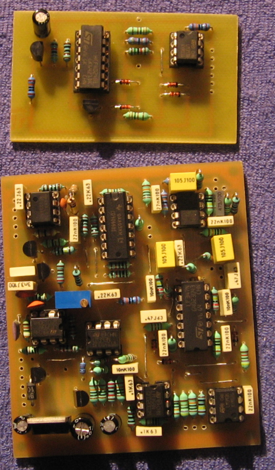

  • I found this 2 tones mod board layout from an earlier post in this thread. It looks suspiciously like the board in the apparent 3-tones video I posted above.
    Maybe I'll have a good read through the entire thread, or perhaps browse through the attachments list as well. There's plenty of info in this thread.
    • Do not make 2 tones - useless prefix. The device will look like a music box (((
      • Comment
        • thanks Dbanner. I added those schematics and links to my IDX files.

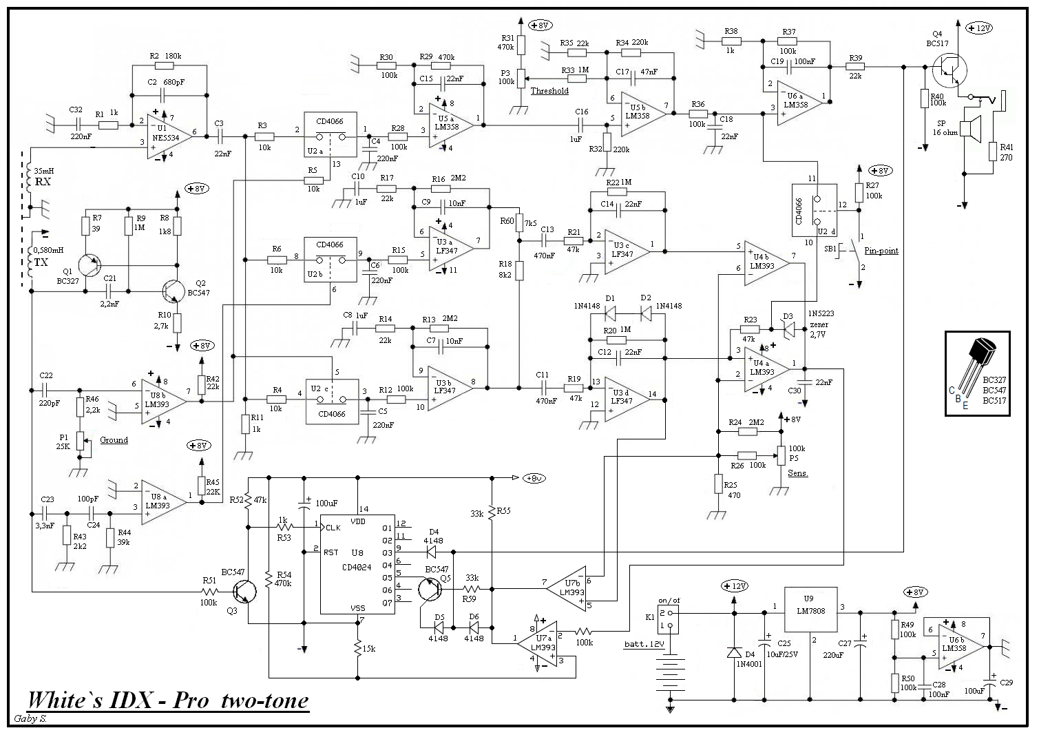

          • And finally, this schematic shows a 2-tone mod incorporated into the whole circuit.
            • Thanks guys,,,,What I meant was I wanted to incorporate the 'Audio 2 Tones' pcb into the 'WhitesIDX' pcb as a whole unit,,sorry if I confused everyone. It's the 2 pcb's that Waltr posted earlier,,,Thanks again. Regards, Marty

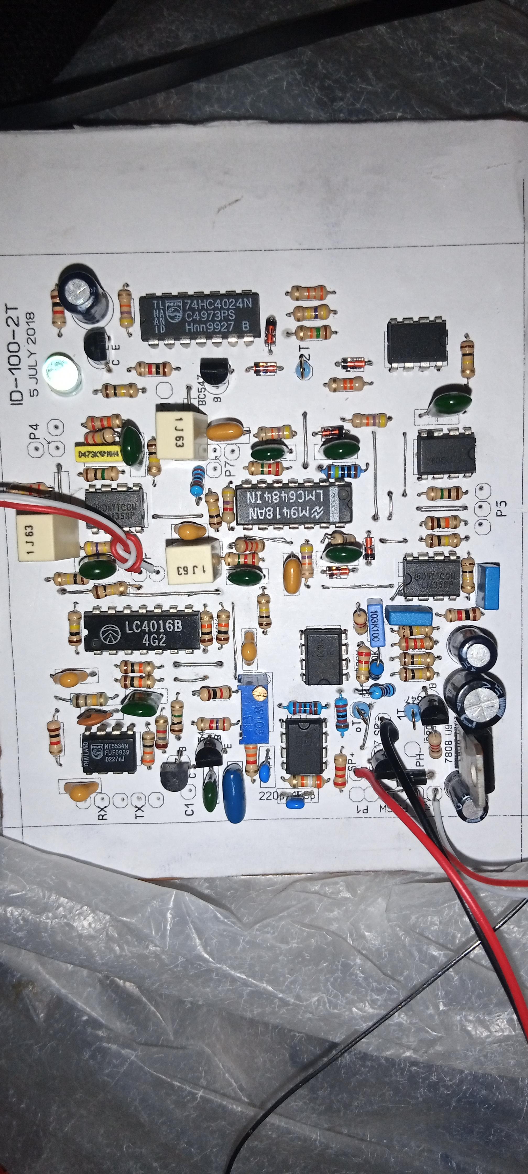

                • On this 2tone idx the two tone thing is incorporated in main board. Dont know what are these oT 1T 2T C1 C1. I hope someone will explain.
                  i have rebuilt the board but there is no tone (pots and coils not connected yet).
                  This project lacking proper build instructions in one document especially the coil building and board testing. Would be kind if specific document is available.

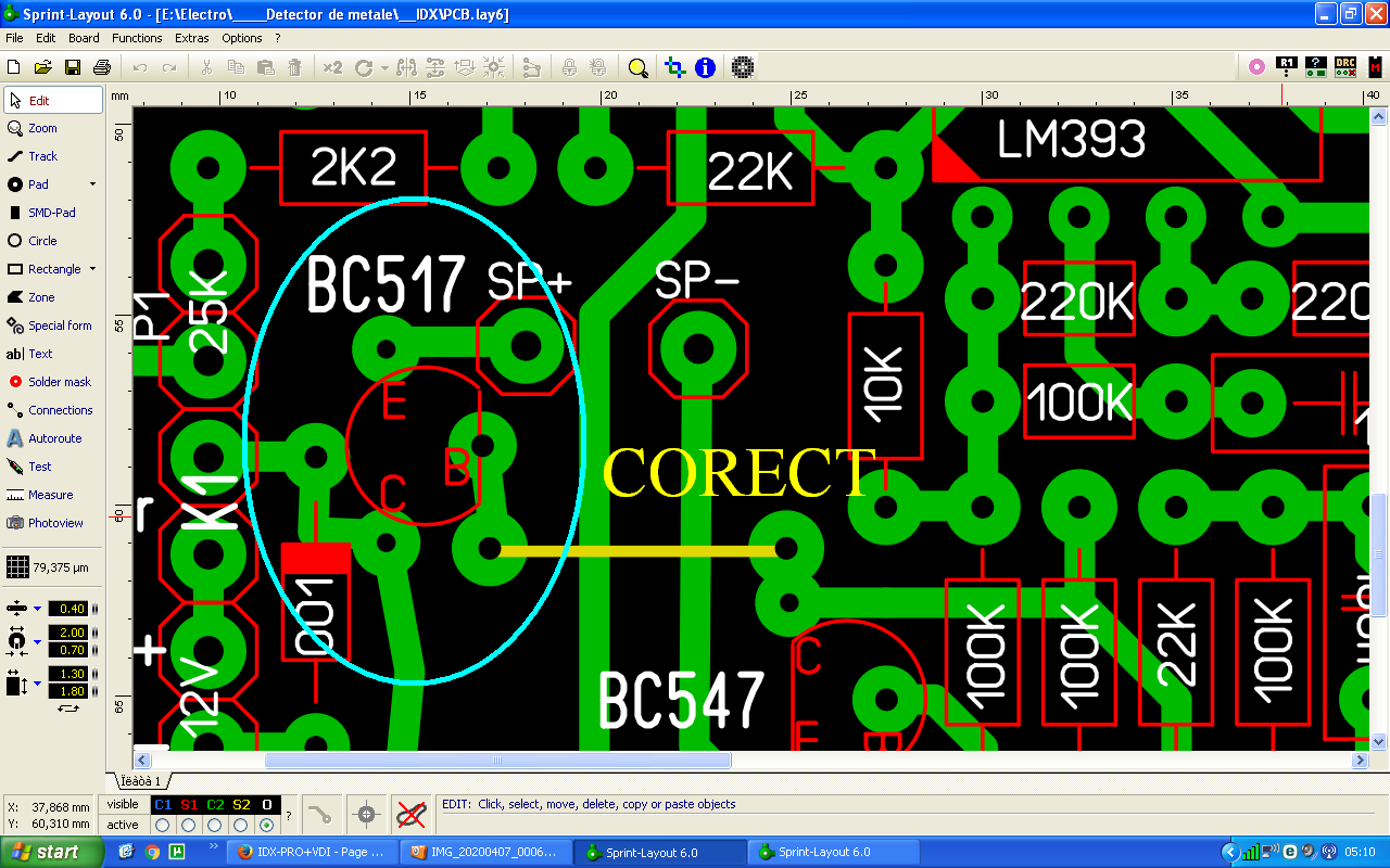

                    BC517 is connected incorrectly

                    • Thank you Gaby_Sult. But here I have used MPSA13.
                      [ATTACH]49889[/ATTACH]
                      • Originally posted by gaby_sult View Post
                        Everything is right there. Bc517 has two options pinout collector and emitter pins......

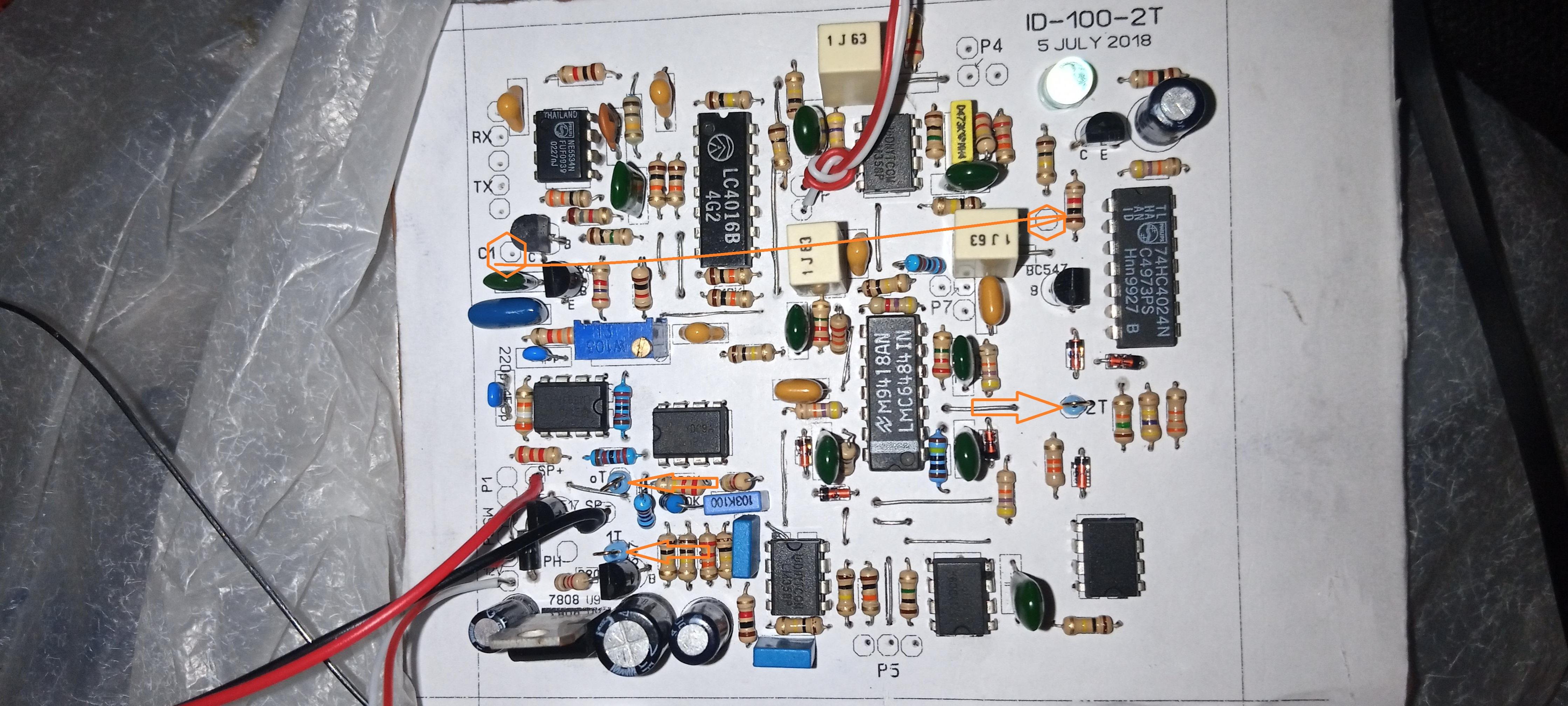

                        • I connected 7.80mH inductors on Tx and Rx for test purpose. Also connected point 1C with 2C and oT with 2T Now it is giving very crisp melodious tone if i press the PP button else everything is dead silent. Still can;t figure out the true connections between points oT and 1T and 2T
                          Does this mean a correct circuit and i should proceed with building the coil for this IDX?
