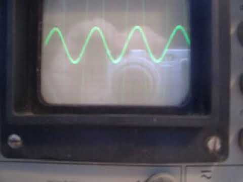

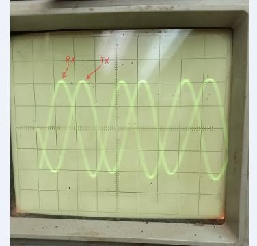

          • Hello
            Dear All
            Please share a correct pic from nulling TX and RX.
            I only could find the attached, is that true?
            I can not find a correct picture on scope for adjusting phase TX and RX.
            Pin-6 from U1 = Rx
            Collector Q1 or Tx pin = Tx
            Click image for larger version  Name:	1с.jpg Views:	0 Size:	22.5 KB ID:	443563

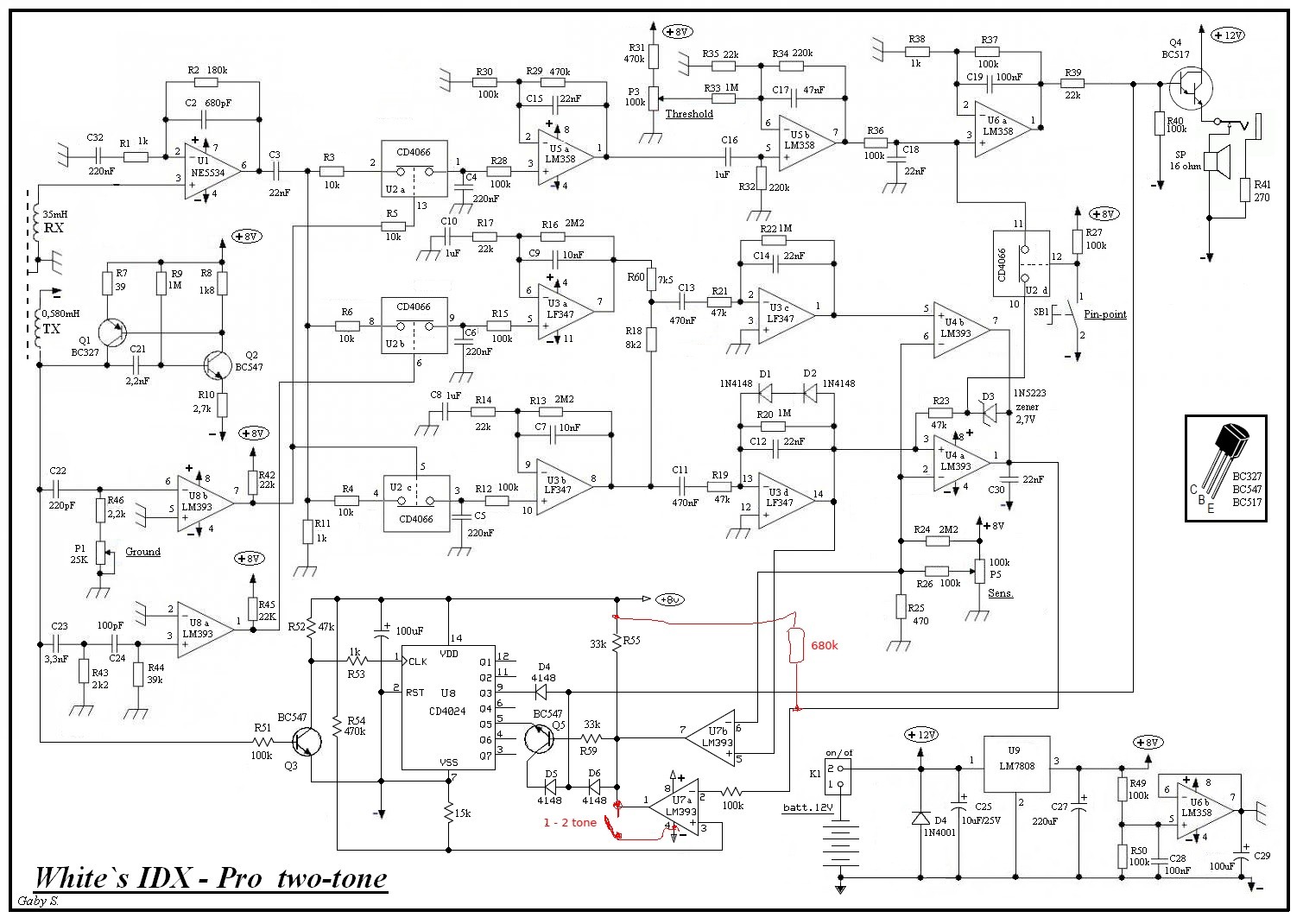

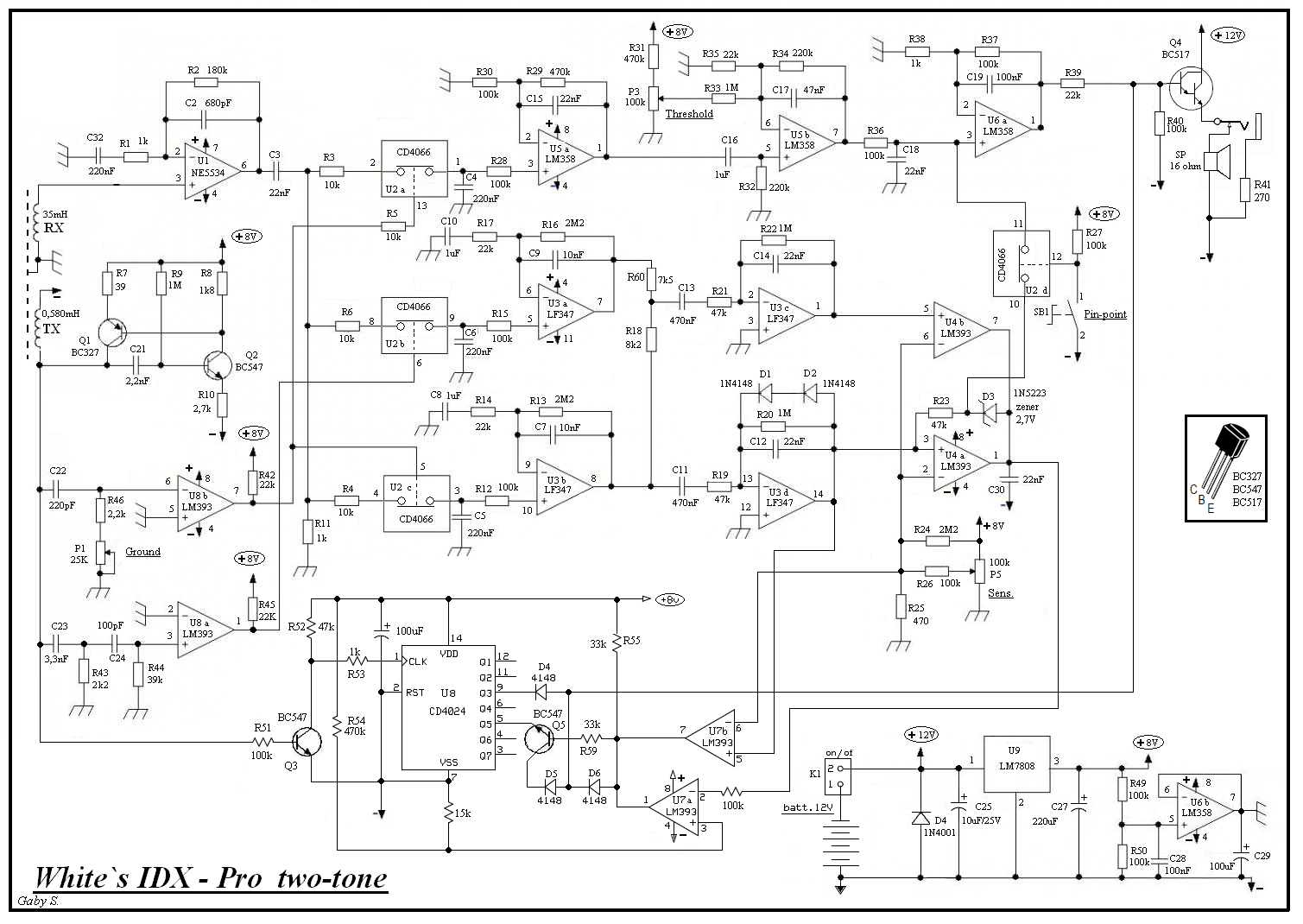

                    And finally, this schematic shows a 2-tone mod incorporated into the whole circuit.
                    Hello Dear All
                    I want to add a switch for selecting one/two tones in this schematic.
                    Do you have any suggestion?
Name:	IDX-Pro two-tone.png
                    • Try adding a switch from U7-pin1 to ground.

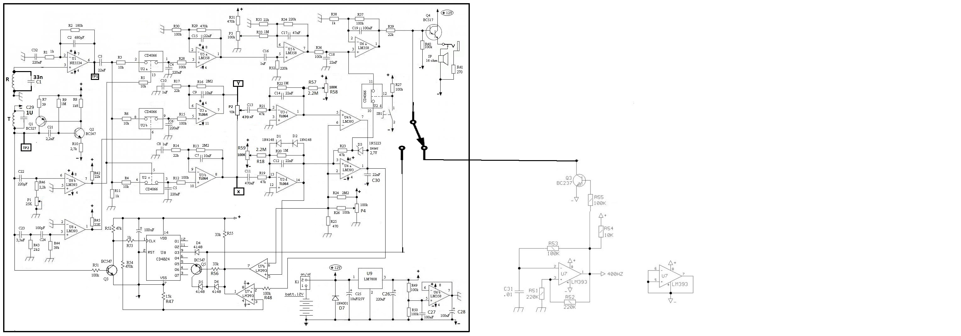

                        this help?
                        Dear sir
                        Please forgive me
                        I want to add a switch between two/one tones.
                        Do you think it is correct?
                          Thanks dear Carl
                          Is that correct?
                          • I think so.
