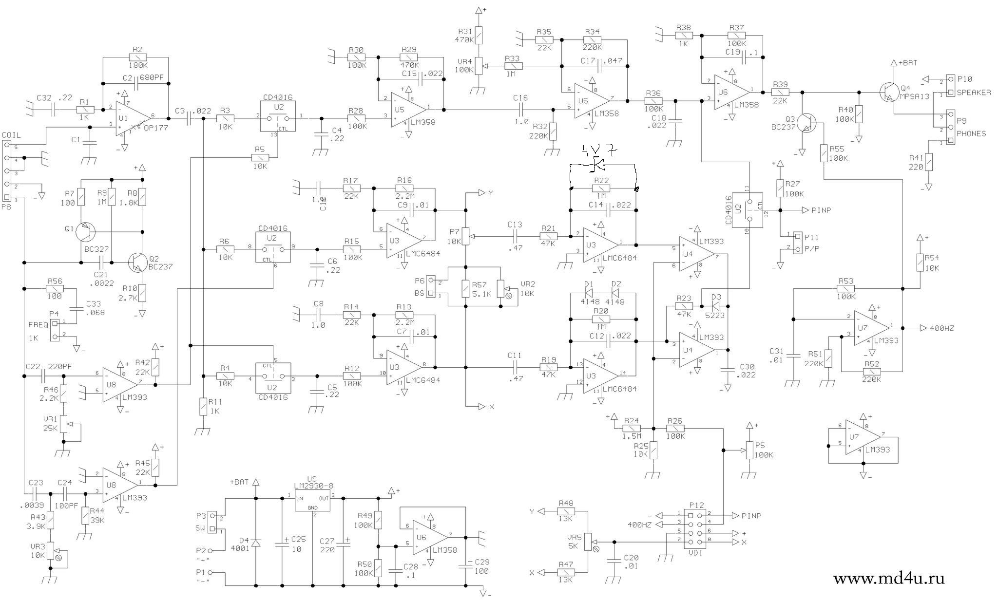

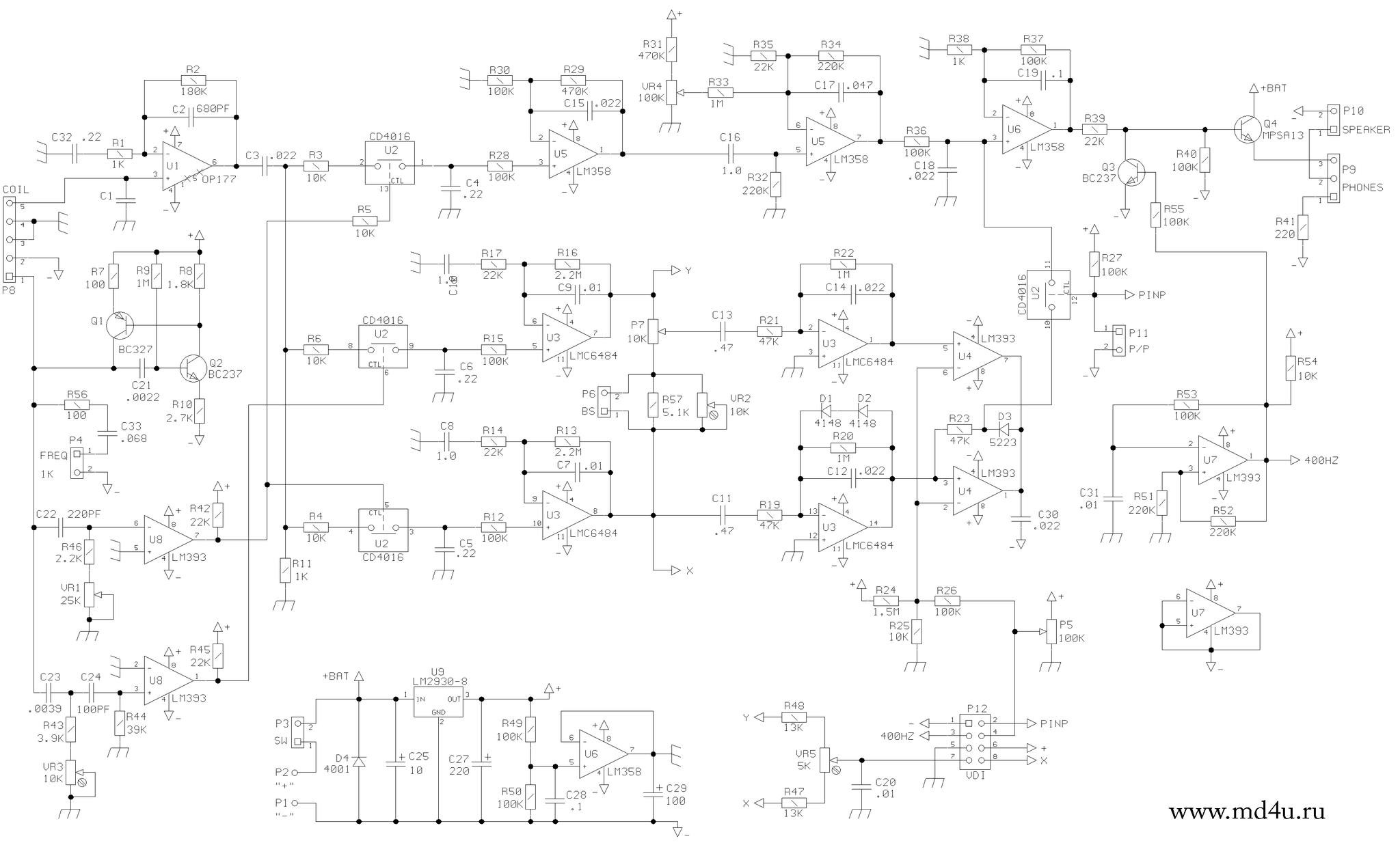

                        Hi.
                        A large part of this problem is solved by adding a 4.7V Zener diode in parallel with resistor R22, connecting the diode's anode to pin 1 of U3 and the diode's cathode to pin 2 of U3. Let us know how it goes.
                        I have attached the diagram with the modification.
                          Hi.

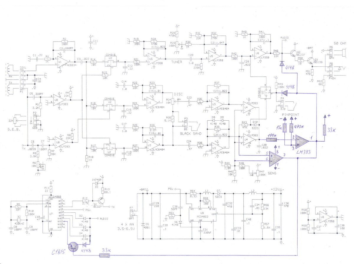

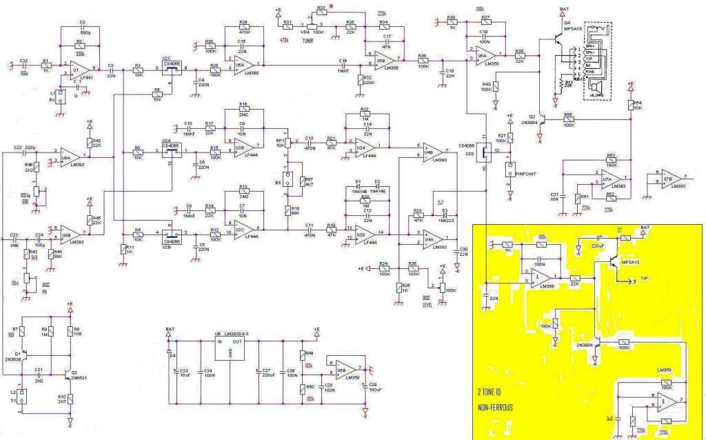

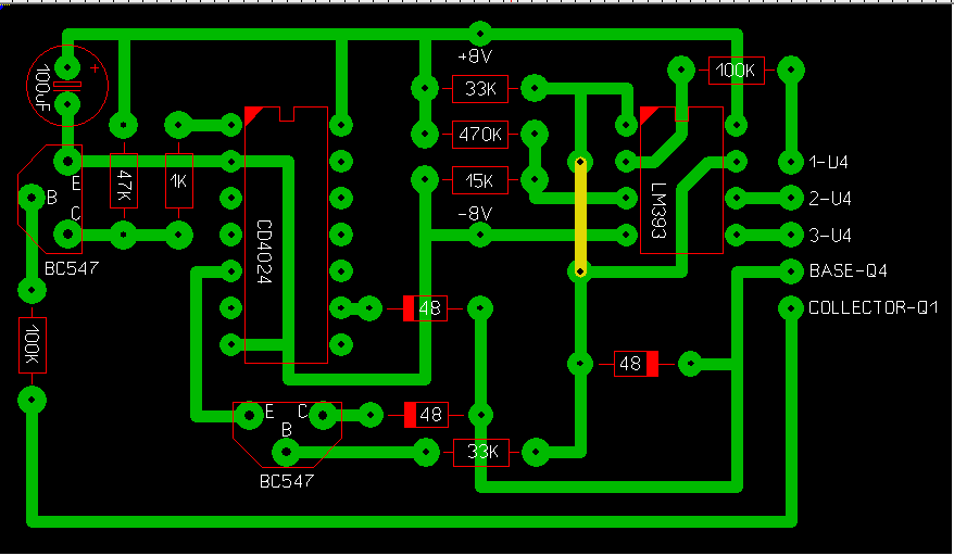

                          I have a problem, i used two tones pcb ( attached).
                          First, i remove ferrite in one tone mode using GB pot.
                          Then, i switch to two tones but i can not remove ferrite in this mode.
                          I think GB is not working on two modes and it is very very unstable on ground and we have Continuously IRON tone!
                          I think schematic of the two tones is not correct and need to be edited.
                          Has anyone been able to solve this yet?

                            There should also be a third tone—a background sound.

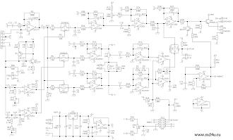

                              First, did adding the 4.7V Zener diode solve the overload problem? The PCB layout corresponds to the IDX PRO 2 TONES schematic, except for the CD4060, which performs the same function as the CD4024. If this schematic doesn't suit you, you can use the CLASSIC 3-2 TONES schematic.
                                Thanks.
                                Dear eduardo
                                we must remove ferrite in both one and two tone mode.
                                In my PCB ( post #4407), ferrite can not be removed on two tones.
                                Do you think your attached (IDX PRO-2 Tones) can do it?
                                In my test, Since the PCB (two tones) can not remove it, so it will detect any ground or minerization.
                                So, we have a very unstable mode like a VLF that has not any GB process.
