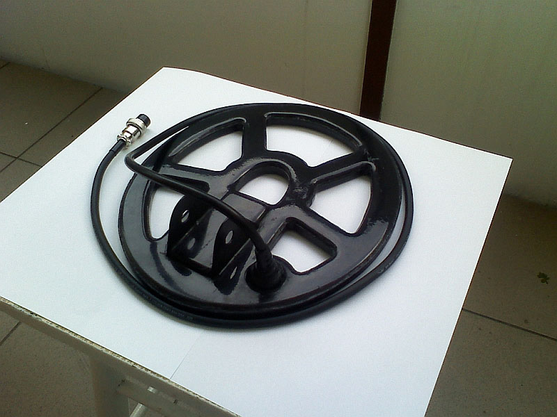

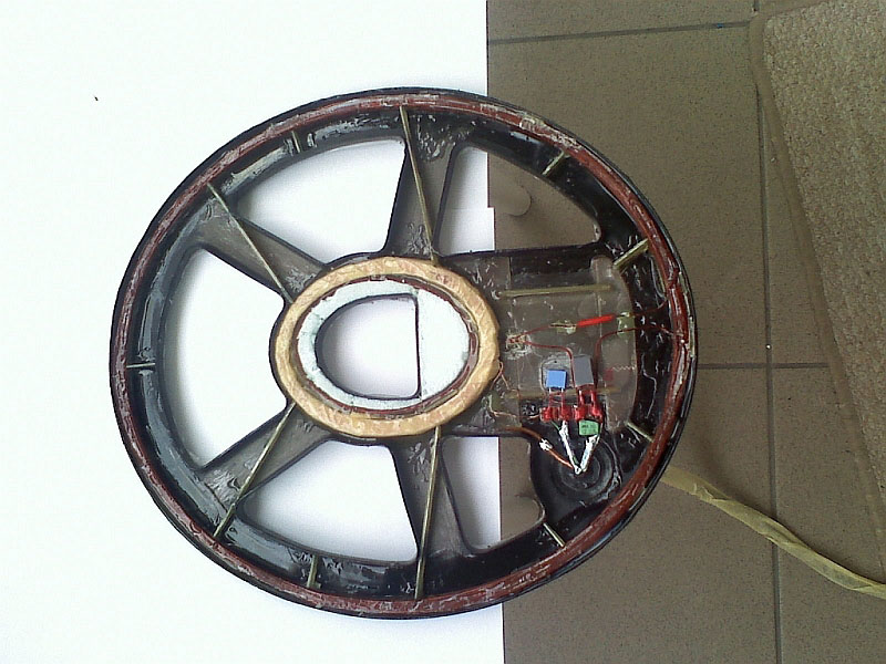

        • - tx winding diameter 240mm ! tx 0.72mm, -29 winding 1,6 ohm, 0,523 mH
          - rx winding diameter 120mm! rx 0.2mm,- 370 winding 80,2 ohm, 35,2 mH
          Data for the concentric
          - feedback loop , diameter 113mm ,10-12 winding 0,6 ohm, 0,019 mH
          wire 0.72mm .

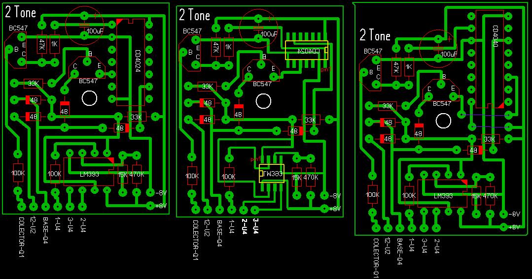

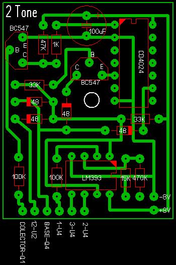

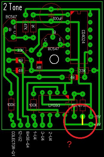

            • Originally posted by reiv View Post
              Sorry.. I can`t edit previous post, this is correct
              hi at all,
              just wanted to start with the tt board. but there is an error on the circuit board (reiv's layout). I think i can solder a bridge ....
              reiv, look at the layout again. i hope that is the only error.

              • Sheet You are right, i upload earliers .lay file. But don`t worry there is no errors beasides this missing connection -it`s working, i`m using it. Here is all my variations of this PCB all works.

                  • no problem reiv thanks for the layouts....smt....nice!!

                        • Could we get the schematic for the 2 tone board here please. S

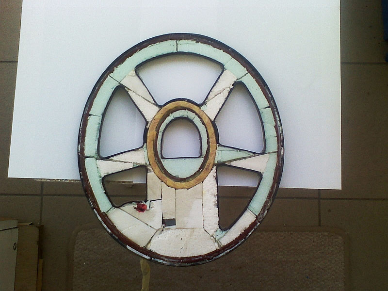

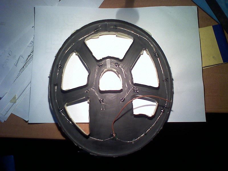

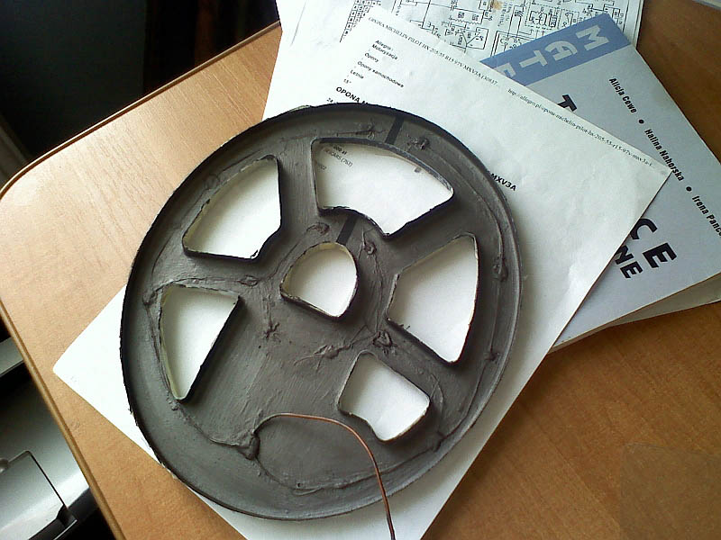

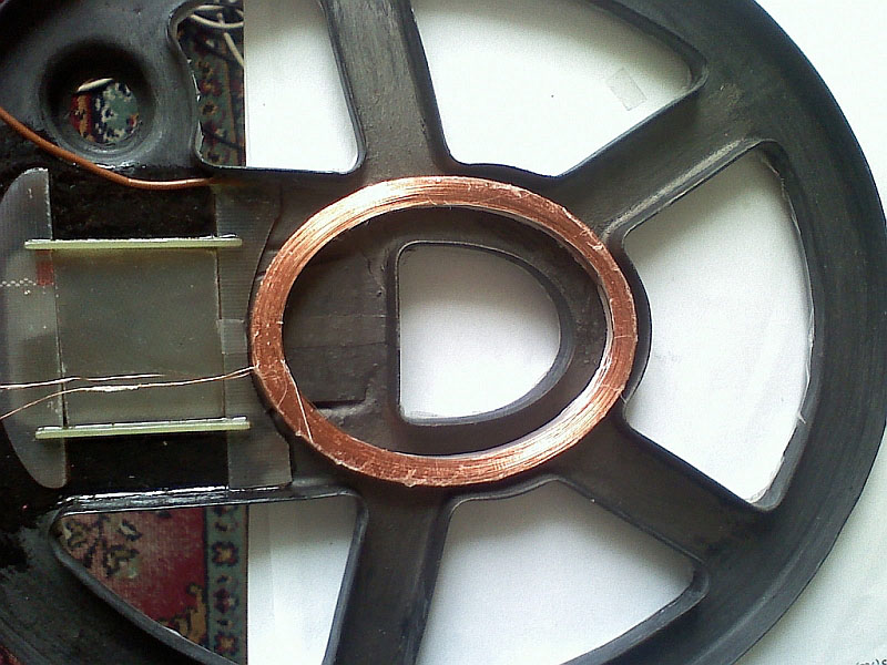

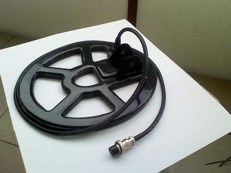

                              • Hi everybody, I presents data for new type of coil to IDX. This one works reeealy great, for example small 15mm diameter coin burried in ground is clearly see at 28cm.. wchich is for me awesome result, discrimination is sharp like a razor . I get weight about 350g.
