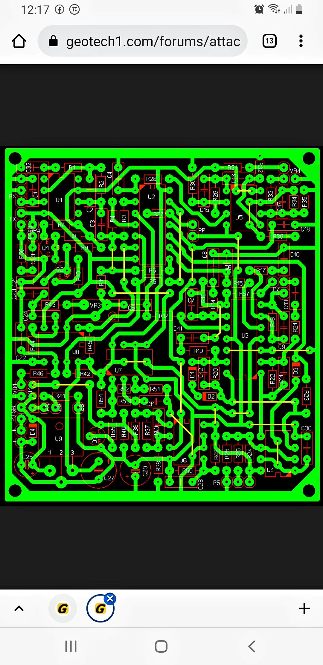

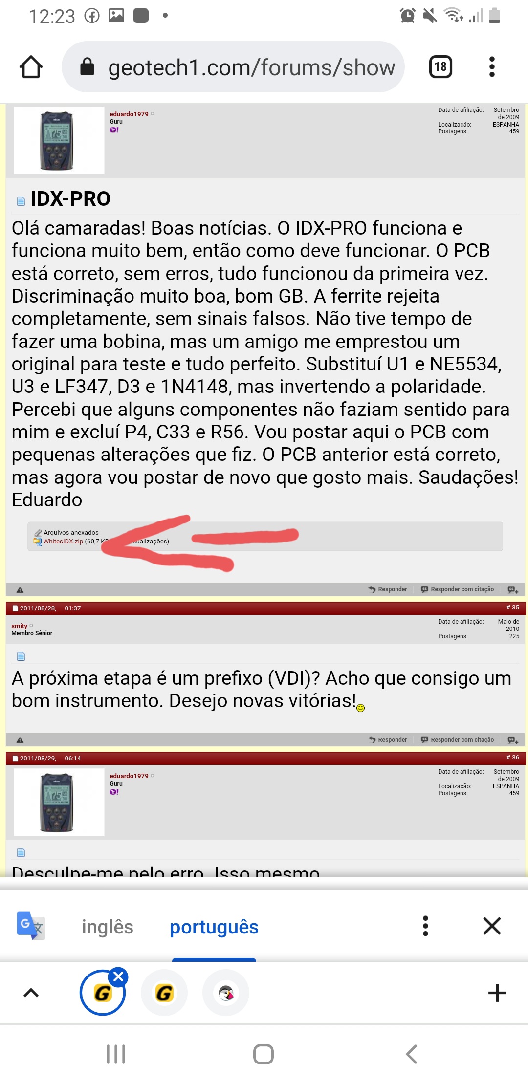

                • because I can't open this file does anyone know what kind of program they have to useClick image for larger version
                  • The compressed file is a lay file and contains edoardo's Idx pro pcb.

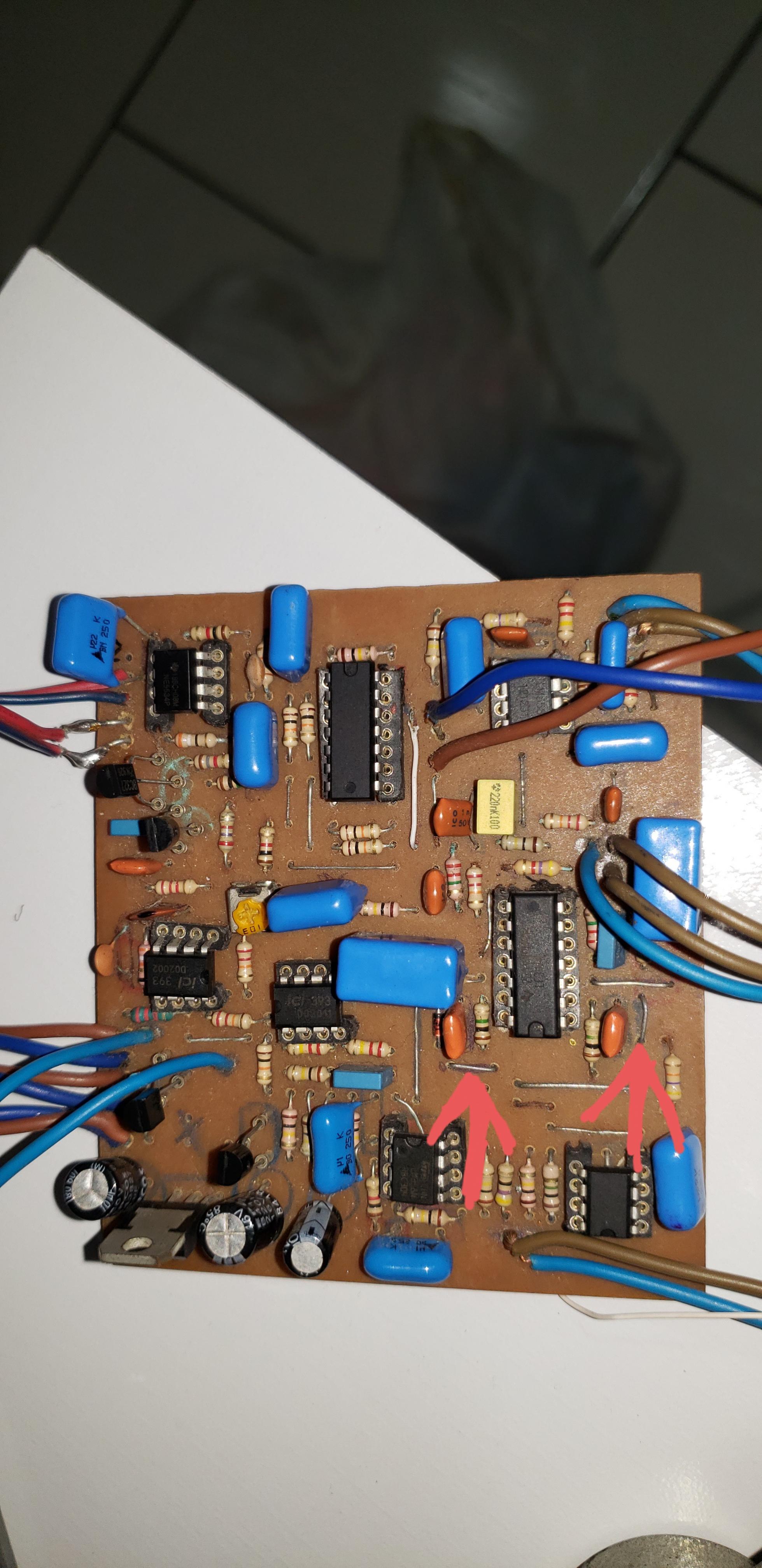

                        • Originally posted by dgm View Post
                          Look at my board which is marked with an arrow when I mounted it I removed the 4148 diodes and put a jumper should I put the diodes back in?

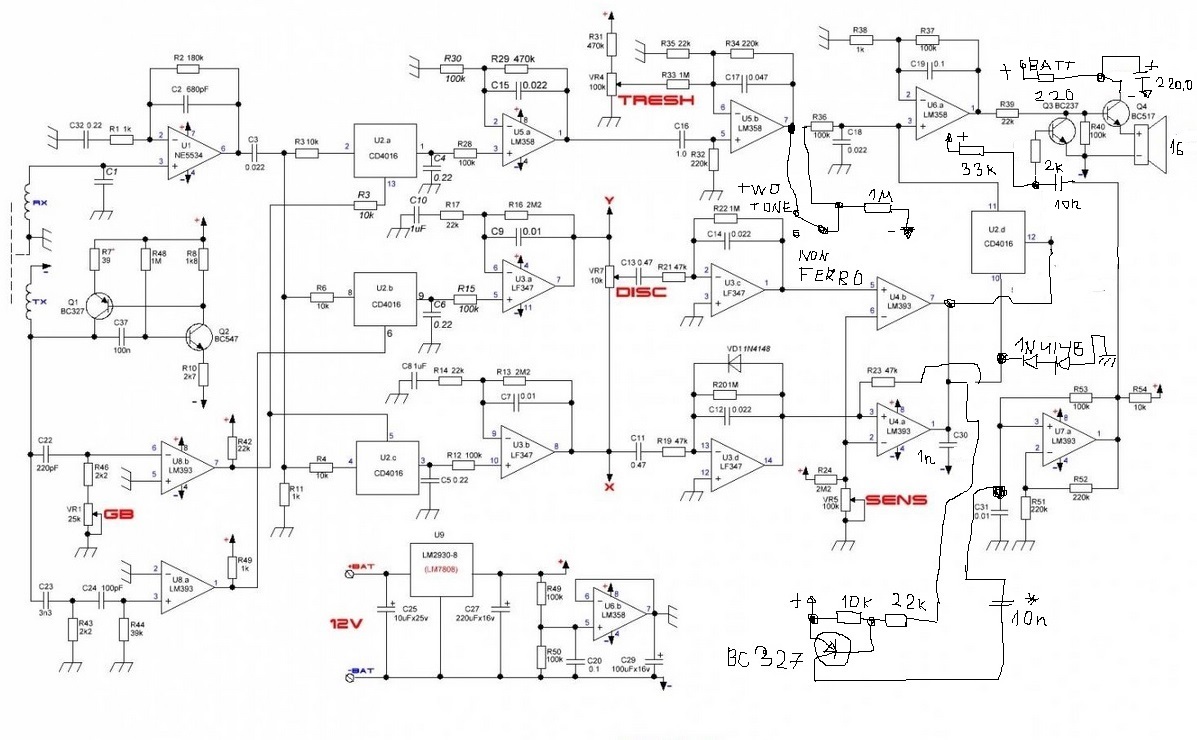

                            • Why did you remove the diodes? If there are in the scheme you have to put them back. I have already said and reiterated to work you have to find the components installed by mistake.

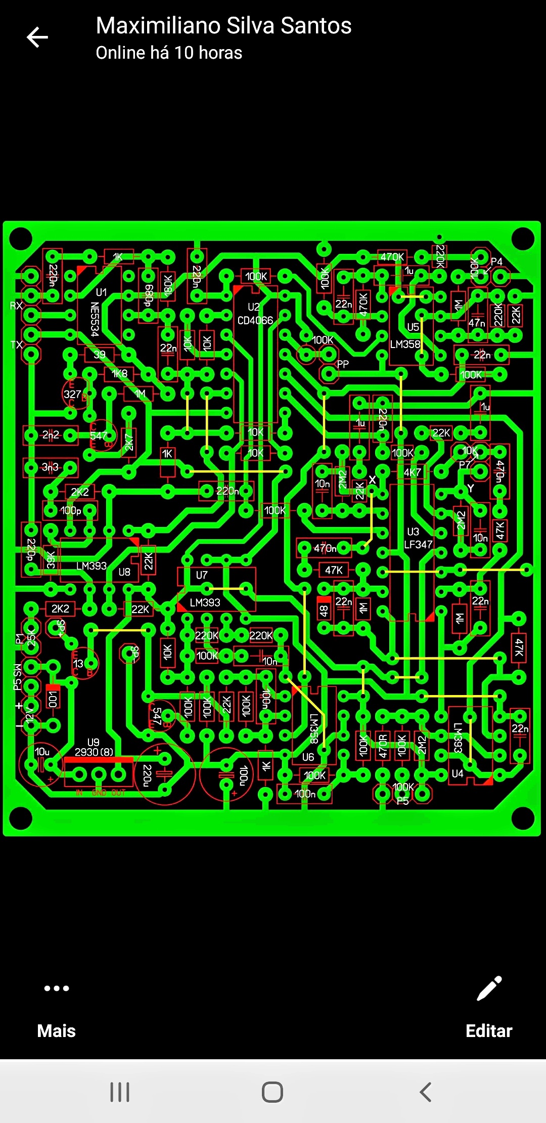

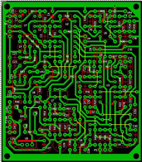

                              • I have 2 different pcb with different mount; what is the correct way?Click image for larger version
