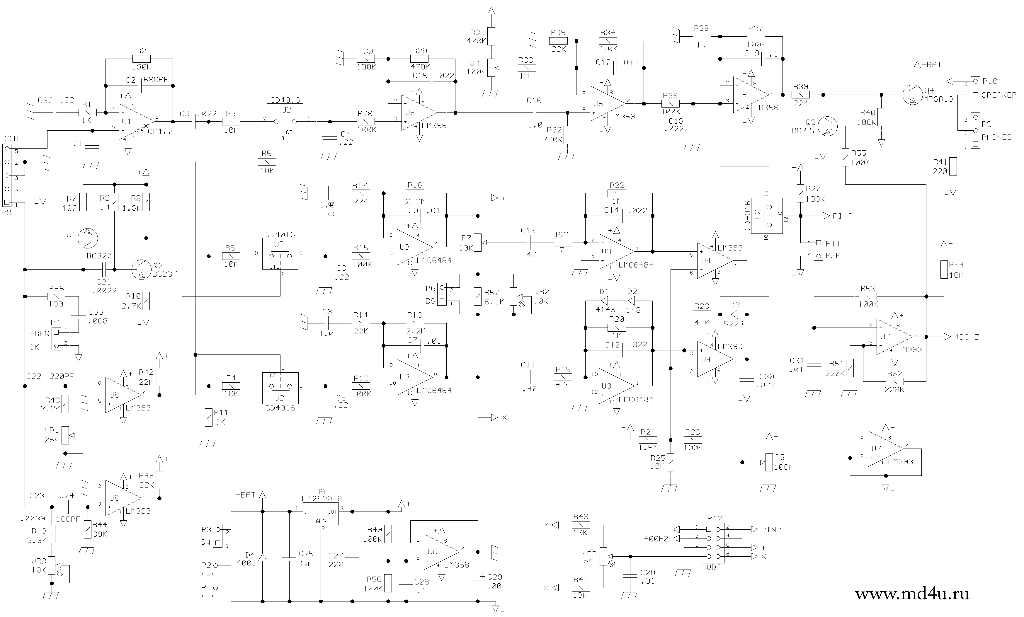

            • The SilverDog PCB is based on the "Whites IDX Pro" PCB.
              The schematic I have that should be correct for this PCB is:

              As with many projects in this forum, many people have contributed therefore many versions get posted.

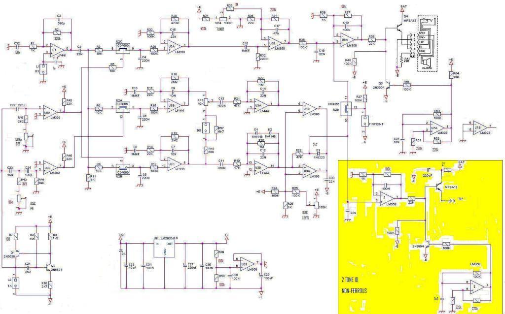

                          • I have this schematic for a 2-tone mod, the schematic is titled "classic 3", which I think looks just about the same circuit as the IDX.

                              • Here is a 2-tone mod schematic:https://www.geotech1.com/forums/show...one#post191394
                                Another:https://www.geotech1.com/forums/show...one#post200224
