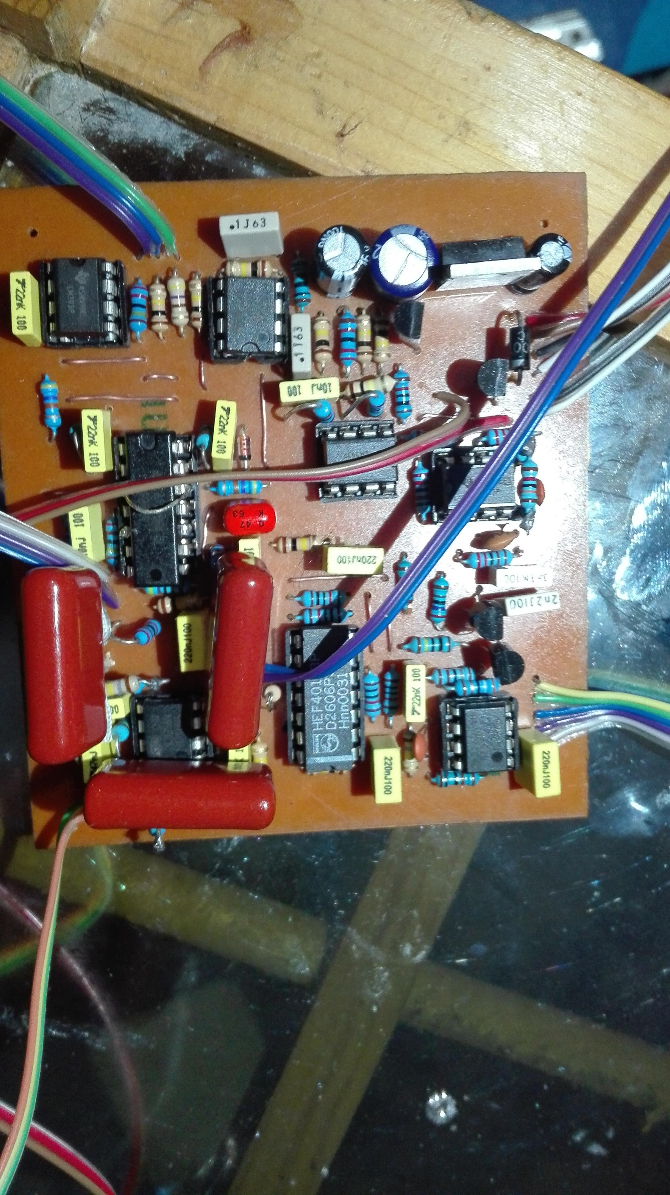

    i measure Tx voltage with multimeter, turn it to rage of 20v~ and attach red probe to tx connection(when tx coil is on) and other probe to gnd ... unfortunately i dont have oscilloscope...
    Set AC voltage on multimeter in range of 200mv and check pin 3 on NE5534.
    Btw, oscilloscope is very useful, but md can be made to works good without him.
    • dear CDI
      I checked Tx voltage,it's 4-5 volts and changed ICs one by one and used other frequency-as you said. apparently everything is ok but the md has poor depth ,1euro can hardly be detected in 20cm , how can i boost the depth?

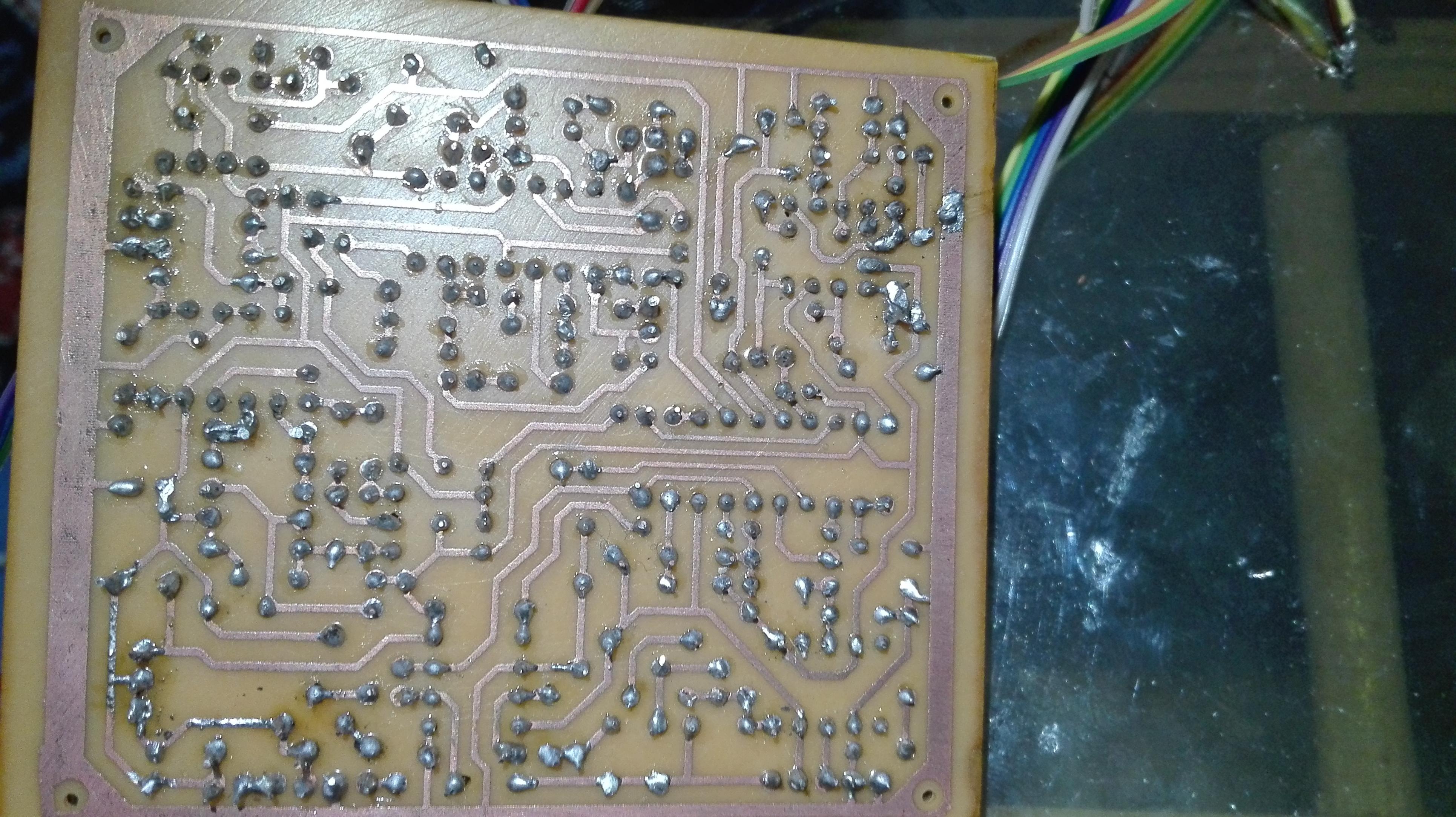

      this is another photos of my md board
      • how much voltage on pin3 of ne5534(U1) is optimal?
        • Originally posted by heyran View Post
          Must be less than 200mv. Next thing what u can try: Delete R25 and set trimer 2-5K, this will give u hiper sens.
          • thank you CDI, i changed u1 and place op177 original , alot of problem solved, depth is good now, 1euro about 38cm,it's ok?
              That's almost finished, you can try to get 45 cm for 1 euro, but... there is a good chance to go into instability.
              Better leave like that if is stable on soil.
              • now ,it detects 1euro in 50cm!
