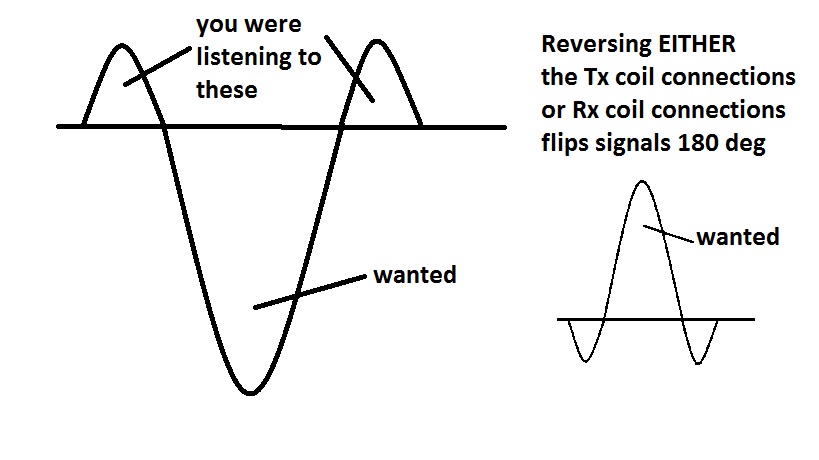

        I had a double beep ,So reversed the TX wires & yes single beep ..[STEVE Question] I can detect my wedding ring @8-10'', Reject small -iron not bad ..coin 20c piece similar to ring..
        But cannot attain 180DEG scope trace !! But still working on that ..
        I will post A pic of the 2x seperate traces tomorrow [I only have a single ch scope But STEVE taught me how to use the exturnal set-up & it works great ]..

            • All of these effects are linked together
              " I can detect my wedding ring @8-10''
              This sounds a bit lean, try reducing Rx cap by 2n and retest for extra air range - this brings Rx tank closer to Tx operating freq.
              If you have Tx and Rx tuned TOO CLOSE together it will air test real well but will be too twichy on soil - like Dons, DD.
              You can visualise how close the Rx tank is wrt Tx freq - put scope on preamp out , note pkto pk level - add 2n2 and Level should REDUCE -as Rx Tank now peaks lower freq - air test will be worse.
              If you reduce RX cap by 2n the level should get bigger. So has more sens and will air test a bit better.
              Both of above true if Rx is tuned BELOW Tx
              (I made a cap switch box using an 8way DIP switch and 1,2n2,3n3,4n7,5n6,10,22,33 caps - this lets you tack this in to set up. Remove and measure - then add appropriate cap an confirm with retest.)
              When you tweak - must retest all alloys, have similar mass targets of ferrite, iron, gold, bronze, nickel, lead, silver
              Check - reject ferrite using GEB reject iron using Disc - while set to reject iron and ferrite - check for ACCEPT of gold br ni le Si

              But cannot attain 180DEG scope trace !! But still working on that .."
