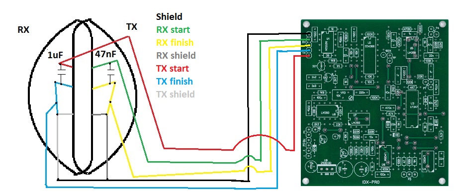

    I become PCB from Silverdog, realy higt quality and shipping was incredible fast.
    Now I finished my PCB, coil I make like in Silverdog`s manual for DD coils. I just wanna be sure, that I understand correct coil connection to PCB. Is this right?
    Paint ARTIST
      Thanks eduard

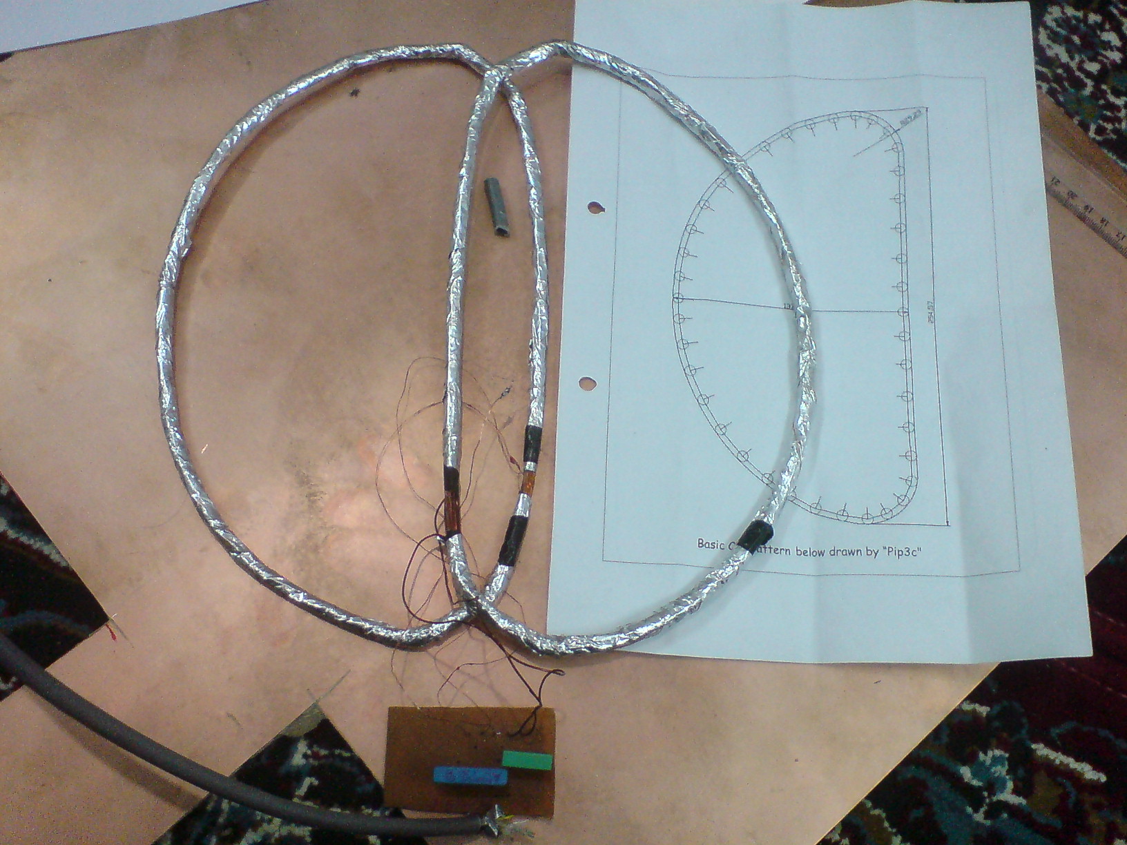

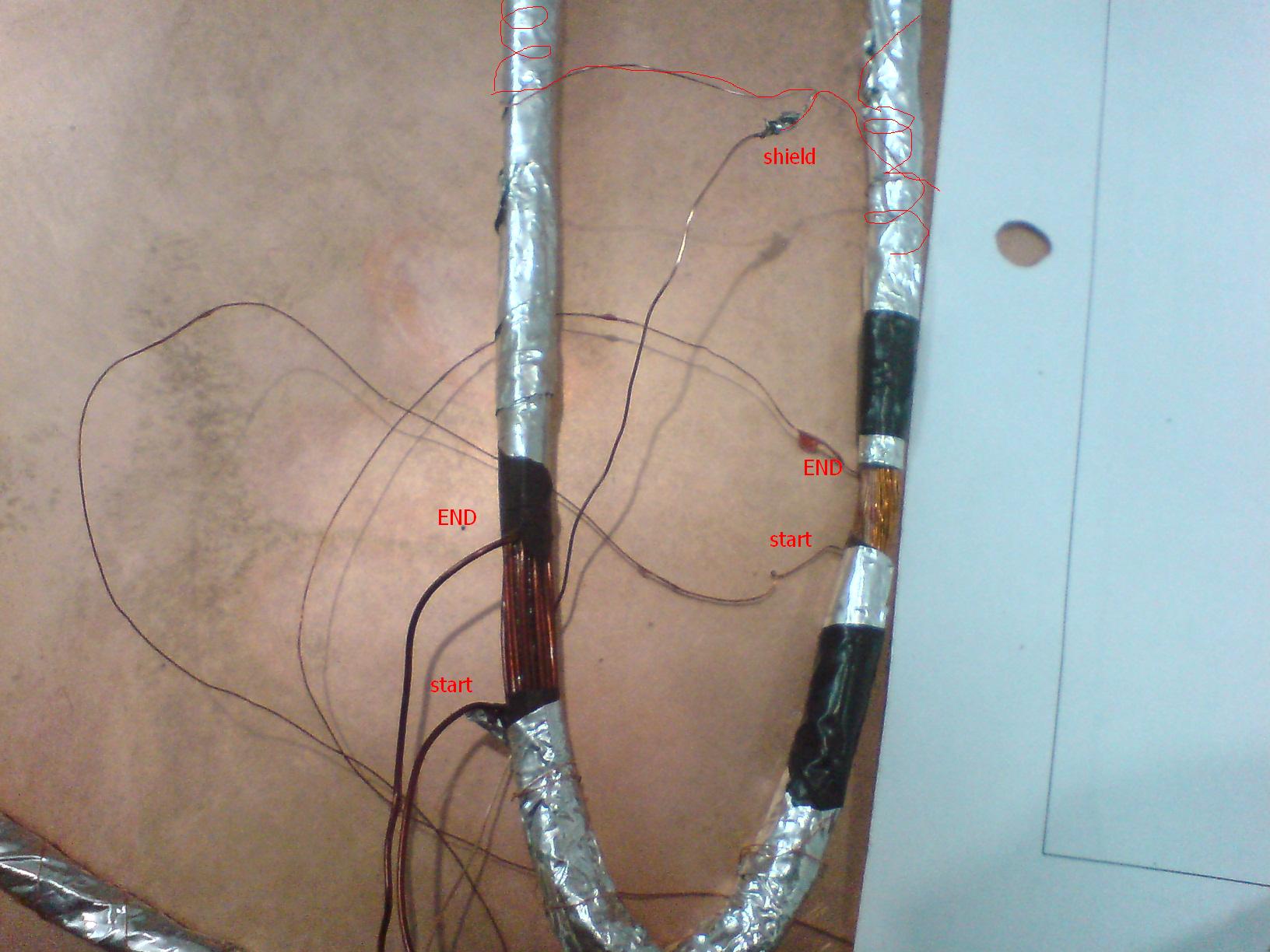

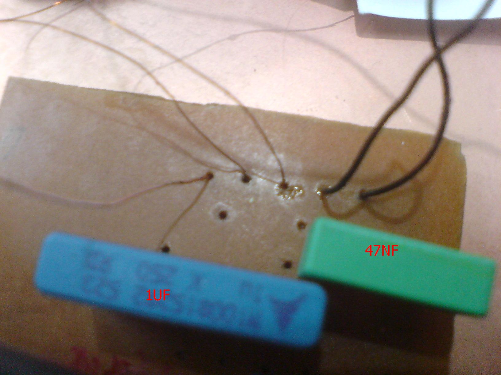

      • finish it and need to help
        hi
        i need help connection to the board.
        my shield is ok??

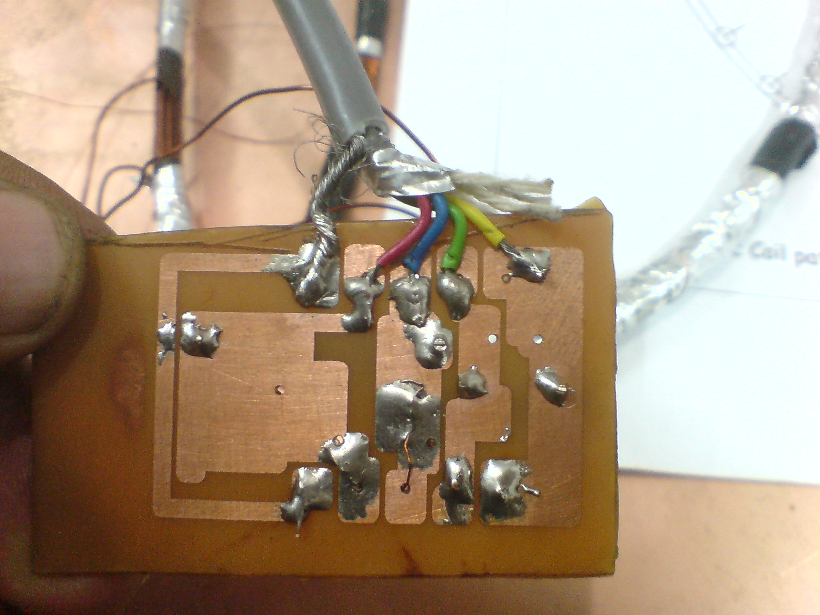

ID:	338043Click image for larger version
ID:	338044Click image for larger version
ID:	338045Click image for larger version
ID:	338046Click image for larger version

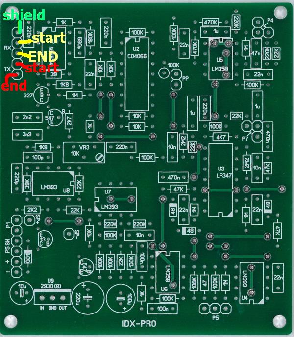

        the connection ok ?look the under pic ,please
        • Excellent for me the shield of your 2 reels must not touch.

                  ashert has wrote you -! ISOLATE ONE WINDING SHIELD FROM ANOTHER YOUR SHIELD IS SH-T.

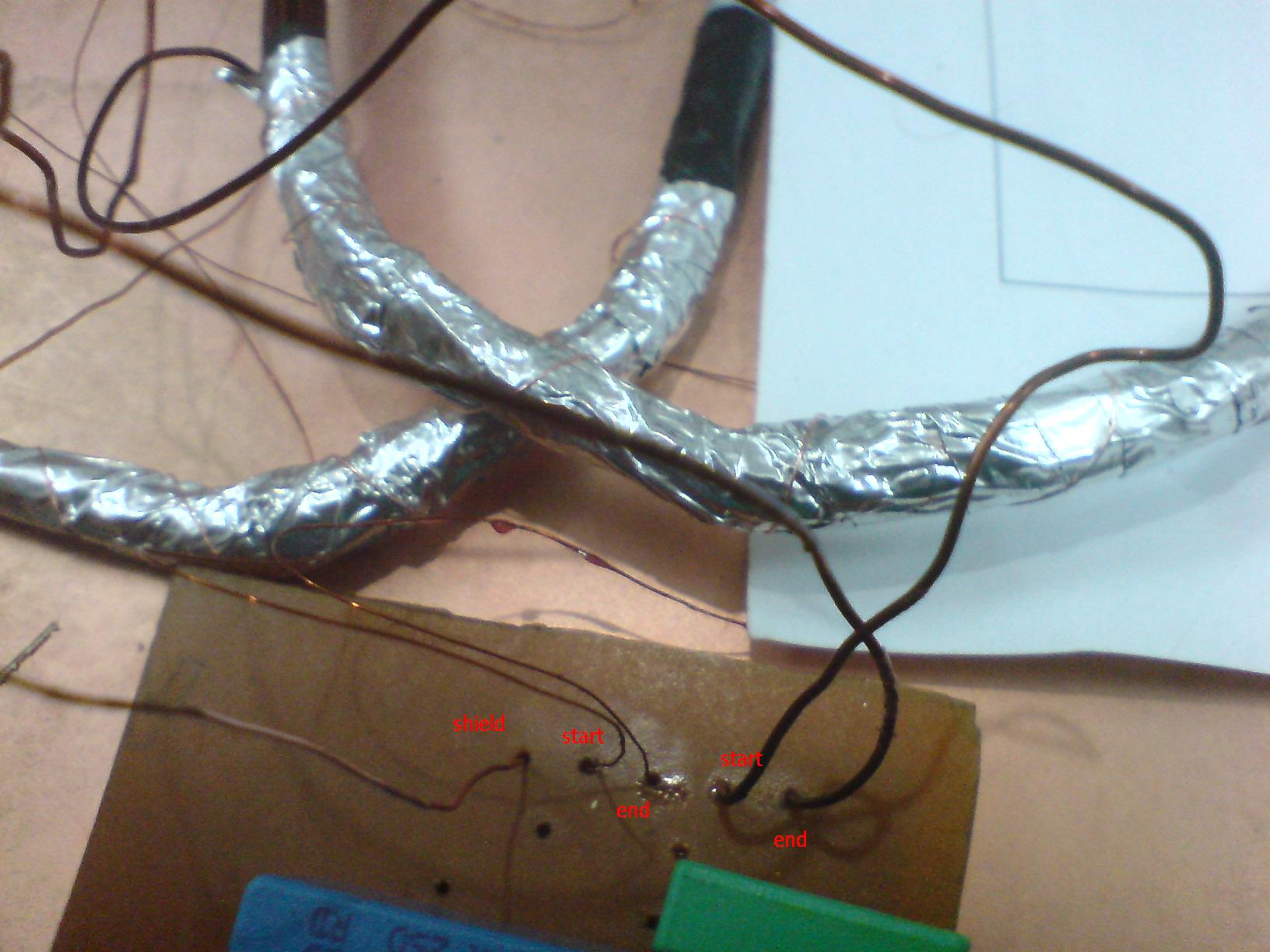

                    • hi kt315
                      ok (i think your means)i remove foil and nuling one of the DD coil , correct ?
                      • NO REMOVE FOIL -! only isolate, take a scotch tape and make.

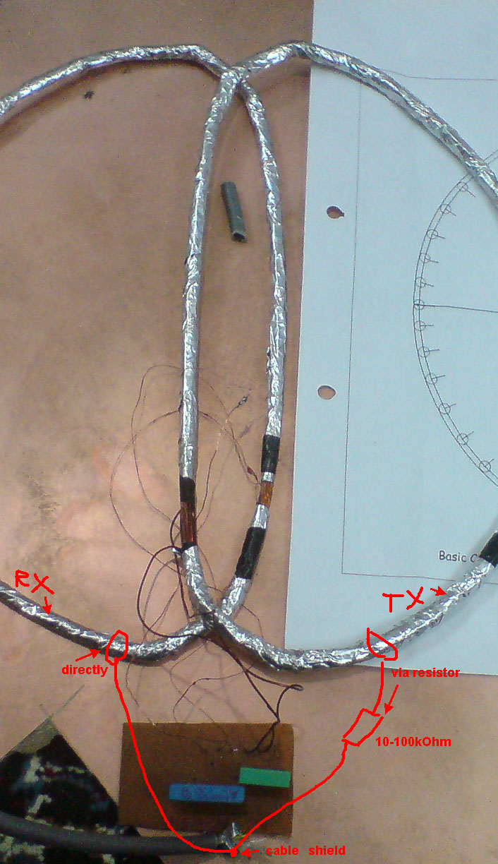

                          • Hi Kt315
                            I built a DD and did not put a resistor in the TX shield. Would that cause my coil to have a lot of chatter. Coil works fine sometimes and very deep but then it will become unstable. Another coil works fine.
                            Going to build another as it is also too heavy as well.
                              [ATTACH]26780[/ATTACH]
                              thanks a lot Mr kt315
                              • insulate the shield of each coil with an insulating material such as tape eg to avoid the two touch screens.
