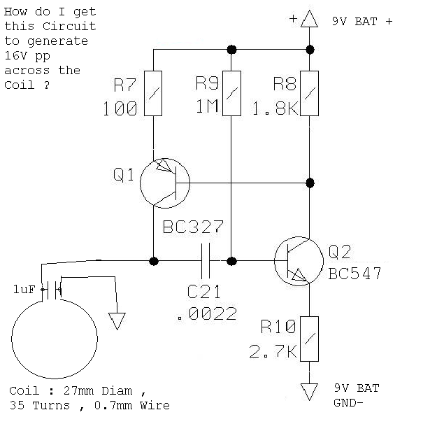

  • I am Testing this Circuit of the Oscillator on a Breadboard and connected the Coil with 1uF Cap,
    but I see the same results of 2V pp at 300Hz :
    Q1=BC327,
    Q2=BC547,
    1M,
    1.8K,
    40R,
    2.7K,
    2.2nF
    Has anybody tested this Circuit on a Breadboard ???
    Whats the Magic to get 16V pp at 1.5KHz ?

      I just finished a new TX coil exactly 27mm diam with 0.71mm wire of 35 turns,
      Tested on the Circuit, it gives 3V pp at 160Hz without Cap,
      - and No Freq (less than 0.2V pp) with Cap 1uF.

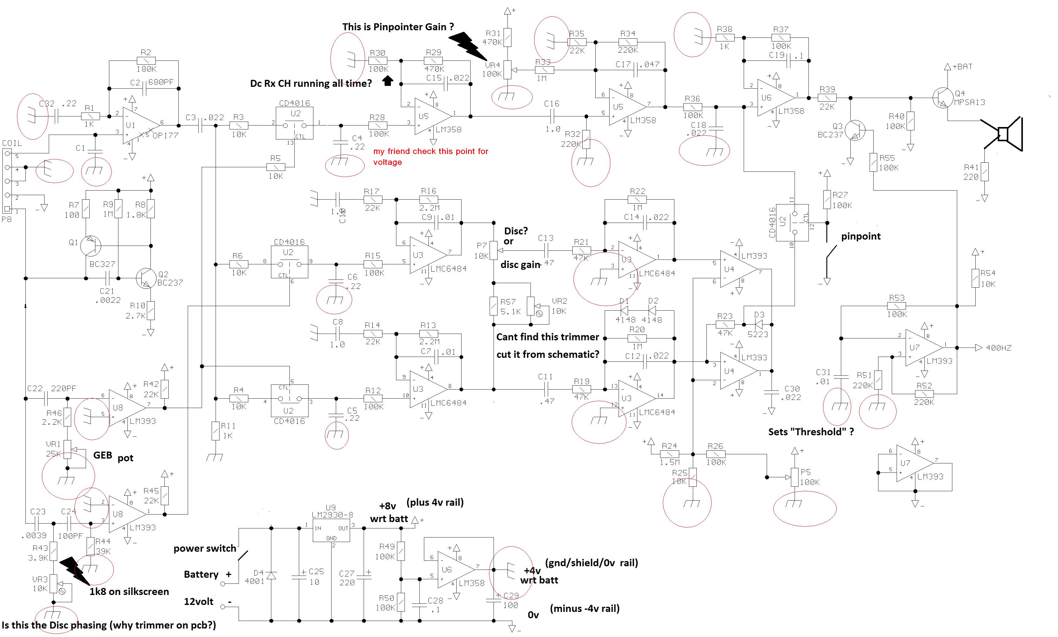

        my friend you should have scope to see waves .
        TX = 6590hz
        RX= 4680hz
        check these points:
        • TX Oscillator Problem
          This is my circuit quandry with TX Oscillator :
          Old Coil gives me 2V pp at 300Hz with 1uF Cap.
          New Coil gives me 3V pp without Cap (no Freq with Cap).
          Coil: 35 Turns at 27mm Diam of 0.7mm Wire.
          - Where is the 16V pp at 6.5KHz across the Coil ???
          OK, Update:
          First, New Coil gives me between 9V-20V on Oscilliscope (which only reads up to 10V).
          But, No Freq with 1uF Cap.
          Second, the Tone disappears to a whisper on the Detector with New Coil,
          no matter how I maneuver or flip the Coil.
          • Originally posted by ampirate View Post
            [ATTACH]29723[/ATTACH]
            my friend you use +9v , why ???
            use +12v and put you results here.you will see 6.5khz in coil connector pin1.

              • You are using cut up sockets for the transistors ??
                They may not be connecting..
                If yes..
                Pull Q1
                Measure base of Q2 wrt Batt -Ve terminal
                It should read +0.7volts.
                If its still 0.1V ,, Pull the coil off - if you now get 0.7 - your cap is DC short.
                If still 0.1v either base resisto wrong value or not connected to 8v
                OR
                Q2 is wired bad
