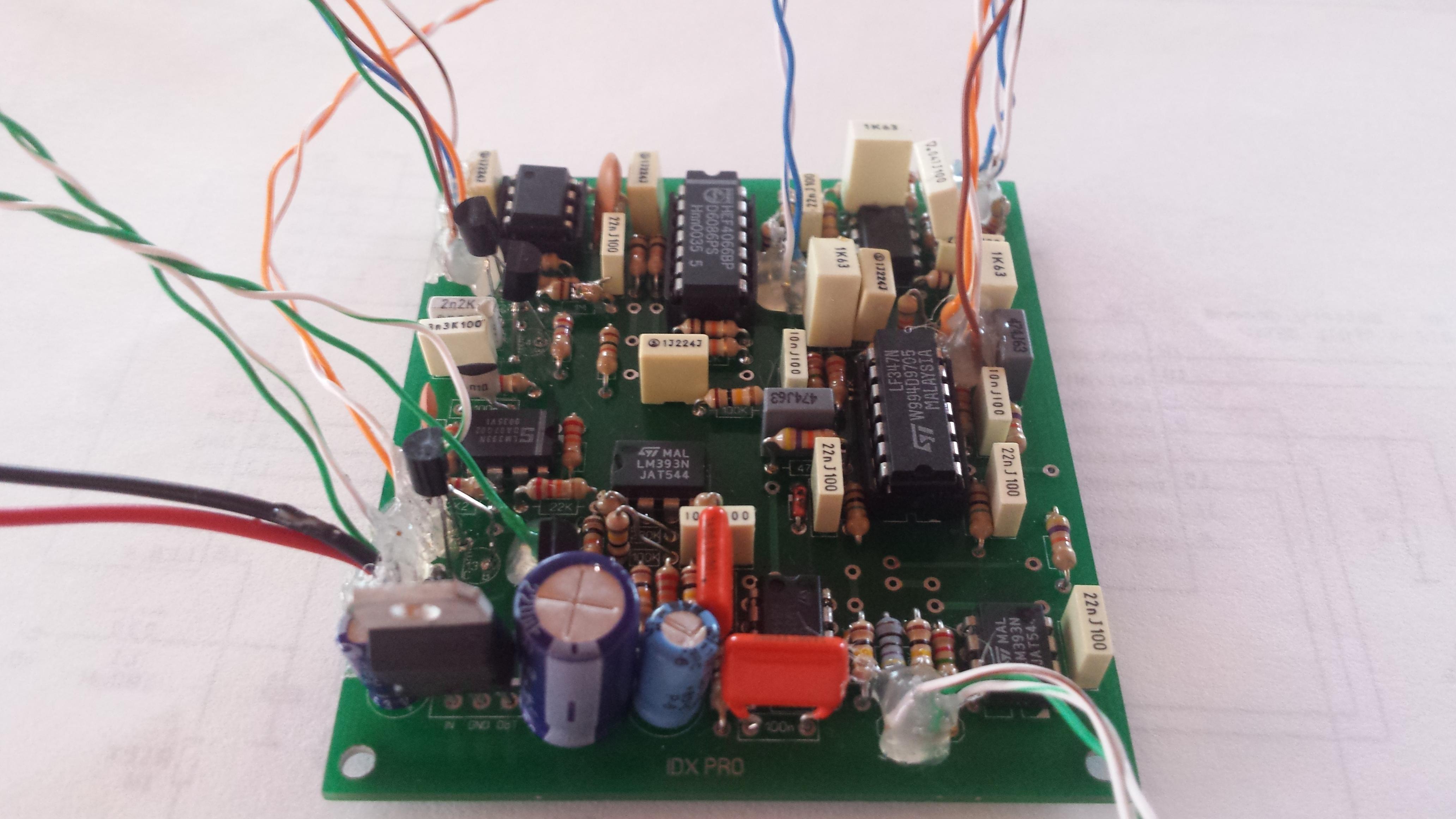

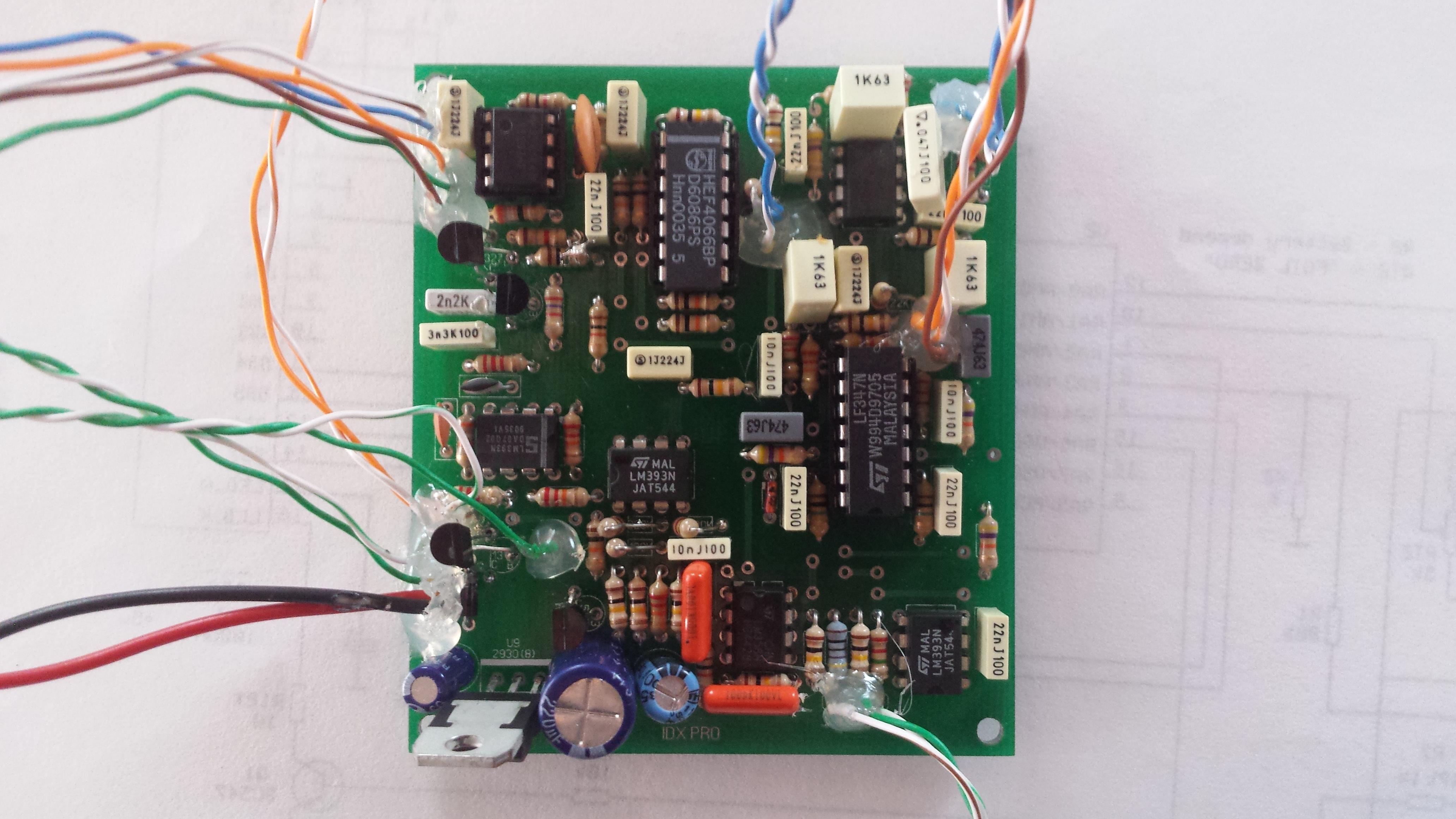

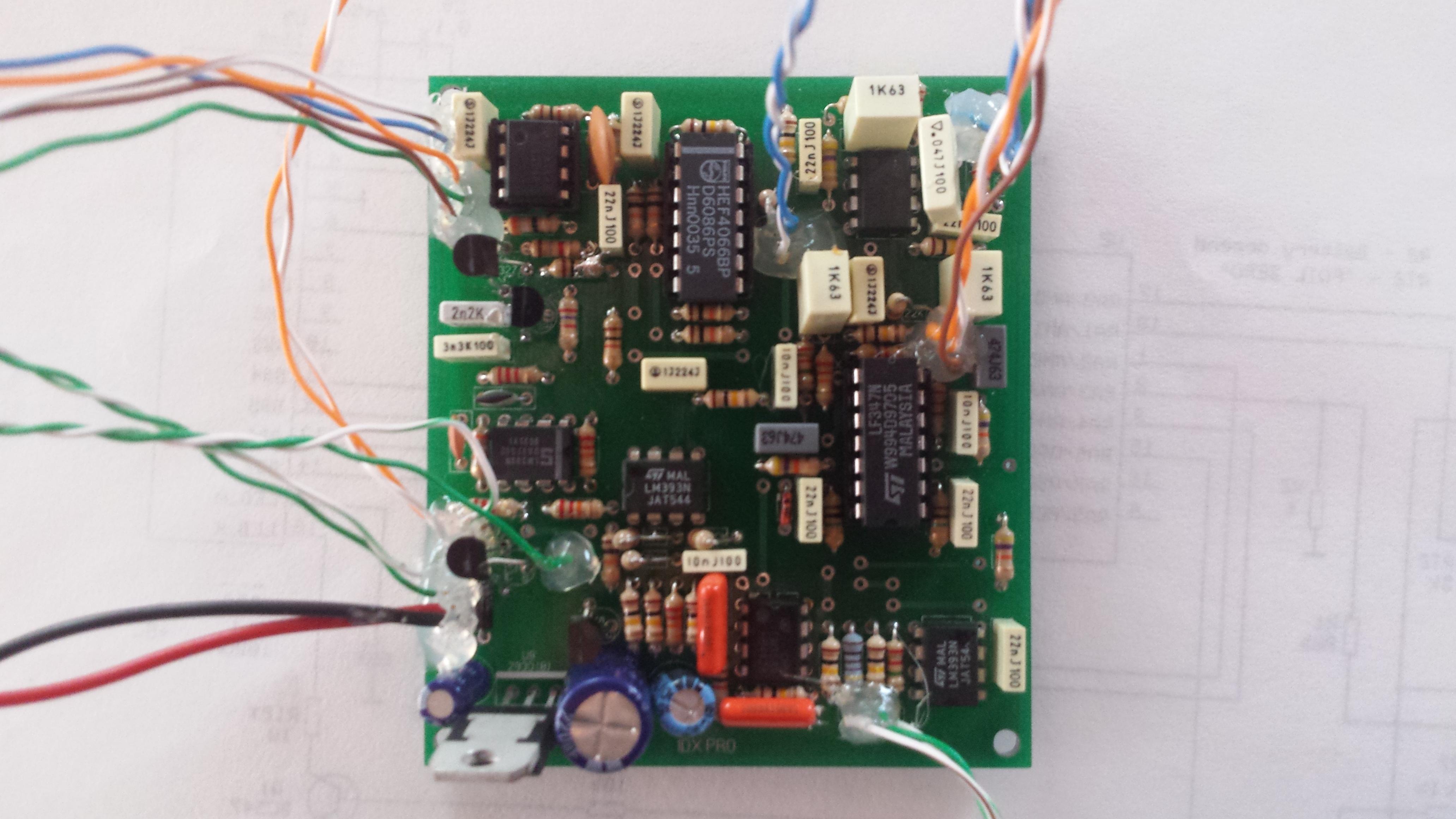

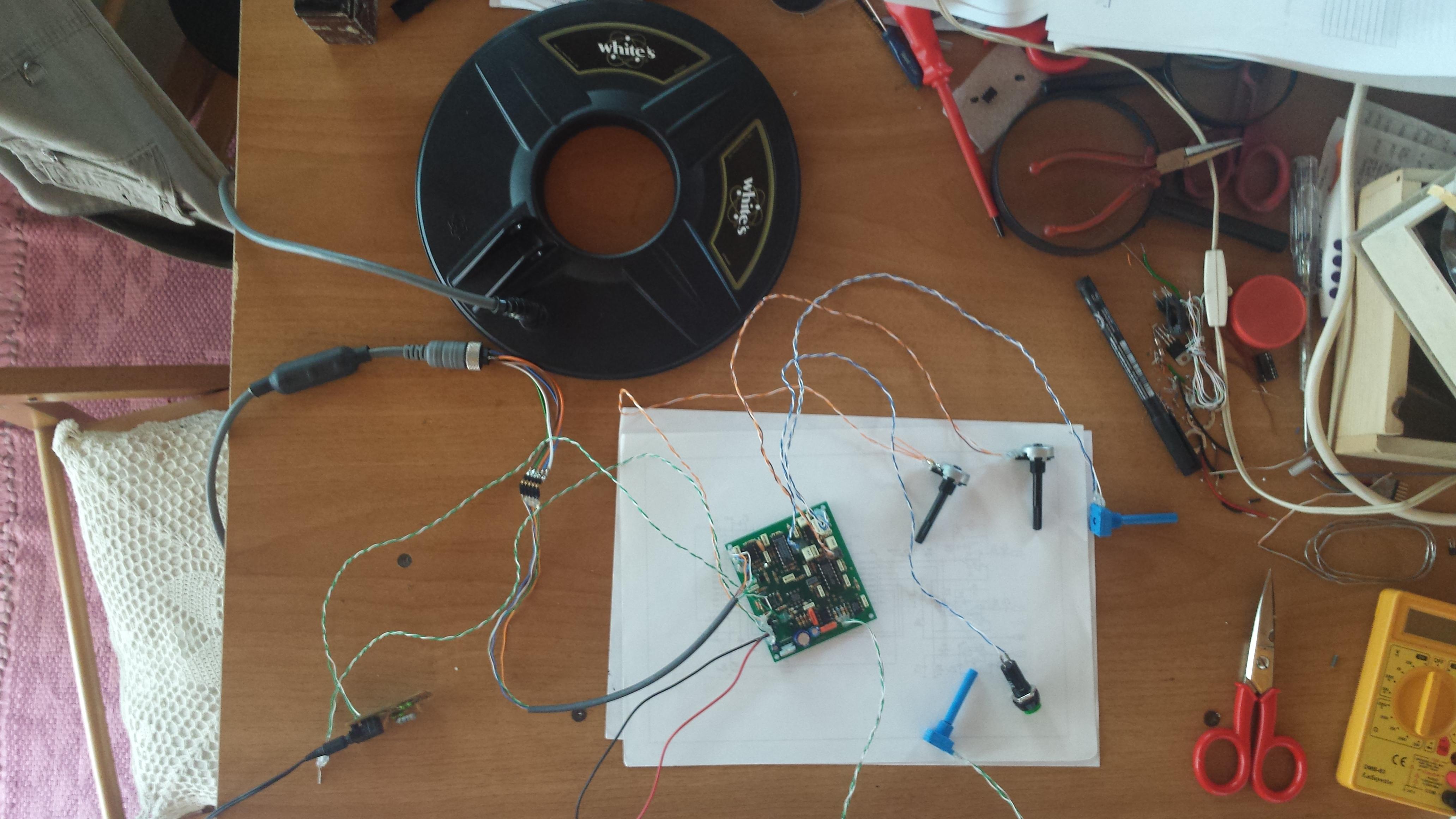

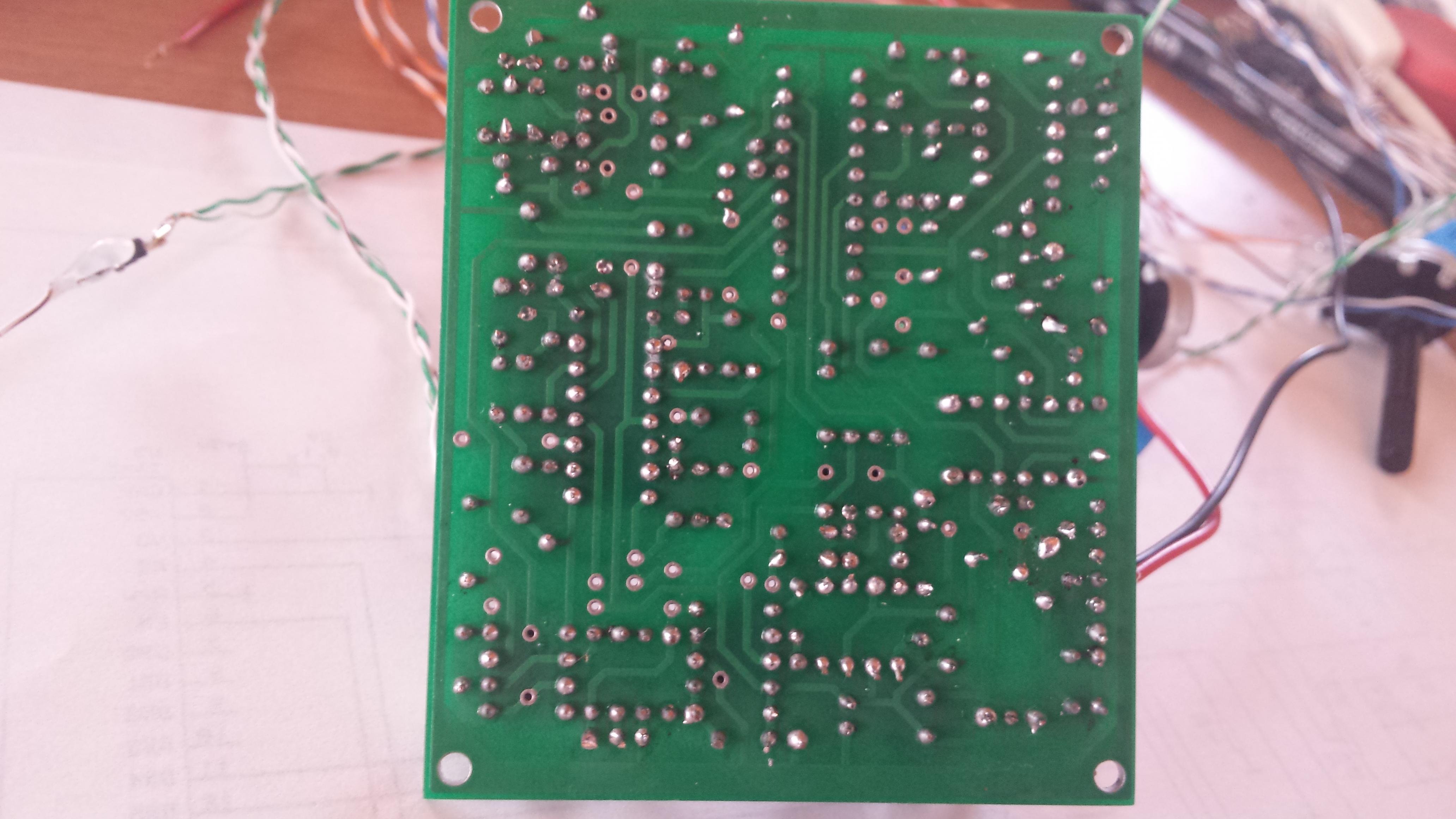

        Hello everyone. Sorry for the inconvenience. Ineed your help. I am a student with a passion for metal detector and I wantedto combine passion and my study and I wanted to build a metal detector to takethe exams. I purchased two pcb from silverdog last summer and I have assembledbut not working. use my pcb with a coil original Blue Max 950 . I do not havemany tools (I don’t have an oscilloscope) to find my mistake for this reason Iask your help .
        It turns the metal detector and leaves only aslight buzz and never varies even if you press any button or potentiometer. Imeasure with meter a supply voltage of about 7 volts on all electronicintegrated. on both strands of the winding coil tx I measure about 4 volts andalso on the edge of the gnd I measure 4 volts. on rx there is tension.
        I put some pictures of my work. We acceptcriticism and advice on how to make it work.
        if someone has a pcb assembly (used as evidenceor that no longer uses) I am grateful to him for giving me life (of course Ipay the pcb and shipping costs).
        I will not steal or copy the project but onlyto be able to combine passion and study. Thanks to all in advance.
        image url :
        • the transistor is turned 180 degrees because I used a MPSA. the coil has been connected according to the scheme found in this discussion.
            Q4 sound driver should be a MPSA13 ???
            • I explained bad excuse. I used a transistor BC517 rotated 180 degrees instead a transistor mpsa13

                      TX is a sinewave and hard to measure with a multi meter. Should be some volt on the AC range I can check with mine and a Fluke meter but I know that different meters give different results. Post what you get between outer ground on PCB and TX on AC setting.
                      From the outer ground on the PCB and RX there should be no full volts on the AC range
                      • TX is a sinewave and hard to measure with a multi meter.
                        BOOM... O_o. the sinewave_ easely_to measure by the multimeter, it will show precise due voltage, at AC range,
                        just cause this is the sinewave. do not agree with you.
                          Does not work correct with my meter for some reason. Mains measures fine. Detector is 16V peak to peak on an oscilloscope but only 4V or 6V (can't remember which) on my Fluke. Different meters may give different results but that's tested with my working detector several years ago.

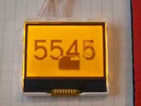

                              • Hallo guys,
                                how about i base my next VDI project on that display?
