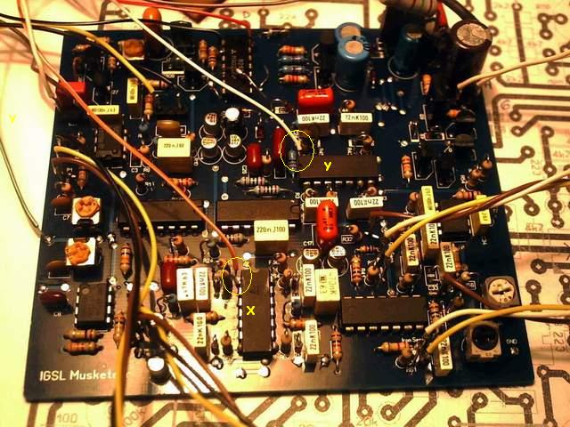

                  Anybody else having success or problems with Eduardo IDX with connected VDI using DD coils?
                  • Originally posted by Wiltran View Post
                    What's a big deal?
                    I made it and connected it to IGSL, it is working pretty accurate.
                    It is not more nor less accurate than White's Spectrum VDI (i had few and i can only compare to it).
                    Shorter: it is enough accurate and usable.
                    I don't think it is especially suitable only for specific type of coil.
                    It can be calibrated and adapted for most of hand made we have here on forum.
                    I still think that "Achtung Minen" is something we don't need and therefore i will not include it in my detectors, until is changed to something more proper.
                    Trick is in LCD character codes, if table inside PIC was changed or messed up; than certain routine calls check and returns message using LCD character set, stops further program flow and repeats blinking of that message.
                    It can be hacked, but i will not do that for public, because "author" is already member here.
                    It is up to him to decide about that message.
                    Other reason not to include VDI in IGSL is power drain.
                    IGSL is already "good customer" relating to power drain, adding VDI will rise power consumption over 100mA - which certainly i don't want, nor need.
                    But for "lighter" projects with less power drain ; VDI can be pretty sweet addition and i do recommend it.
                    So, there are no problems related to any type of coil. Phase is phase, no matter what coil you will use.
                    That's my few words about it.
                    P.S.
                    Ooops, i reversed X and Y positions on photo. I just saw that mistake... Should be opposite.

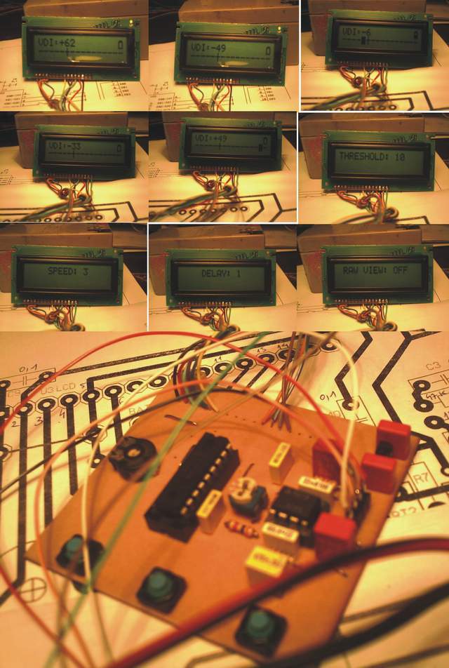

                          Why would you want to "zero" it on foil?!?
                          Al foils should be indicated in range +5 to +25 (approximative, can't exactly recall how it was at Spectrum..), depends on size and width?
                          Isn't that right?
                          At VDI+IGSL; Al foils (and thin silver) are nicely indicated in that range, irons in minus range, good coins between 55 and 75 etc..etc...
                          Pure ground, hotrocks, minerals and ferrite are indicated in range -5 to +5, also approximative (or max and min ends of ranges if signal is very strong).
                          Aren't those proper ranges?
                          I think those are, because correlating with common logic.
                          If you look posted photos:
                          +62 is nice,fat, 3cm diamm Cu/Ag coin.
                          -49 is large pliers,
                          -6 is medium sized nail,
                          -33 is large rusty nail,
                          +49 is 2cm bronze coin,
                          I experimented with menu adjustments.

                          • It's good to see you got it going, Ivconic, and to see it works with IGSL! Which 2 pins on LF347 did you connect it to? and it looks like you had to change VDI settings delay ETC to get it to work. After you change the settings does it get saved in the PIC chip for default startup? thanks for the reply.
                              As you see on posted photo; pin 14. of upper LF347 and pin 1. of LF347 bellow.
                              Yes i experimented with VDI settings, but like i said: i can't remember.
                              It was few weeks ago and after i made it to work right - i reassembled it and put it away.
                              Damn... i needed that LCD for something else... those components - never enough!
                              Yes, PIC do "remember" all the settings, which is very nice!
