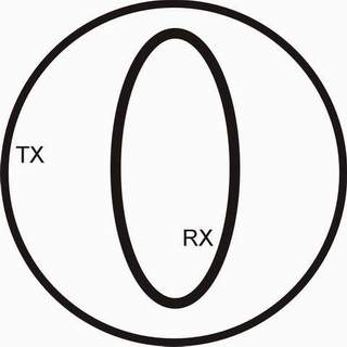

                            Hello everyone.
                            can put the parameters of the coil construction of DD FISHER CZ, if any.
                            Thank you.
                            • #44
                              Originally posted by geminis74 View Post
                              Hello everyone.
                              Thank you.
                              It is not DD, it is coplanar,"concentric..."
                              • #45
                                Don't have my old notes right now.. but as i remember TX= 3.1 ohms and RX=30.5 ohms... Inductances i can't remember..
