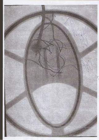

    And "..X-ray'ed" !!!

      In the past i made 44 copies of White's Classic III !!!
      Tried several different coils with it!
      Best performed coil was exactly this one - 10.5" Quciksilver for CZ series...
      Air depths on test were over 160cm !!!! Tough to believe.. but true!
      Coins at 50, 60 ..65cm in air!
      Also great depths in real soil!
      I visited many terrains with such setup. Lot of deep (and i mean DEEEP) finds with it!
      But... there is one lack; not so immune on hotrocks!
      So.. it is usable and lunatic deep on medium soils, also not bad on middle mineralized soils..
      But it is very unstable on soils with hotrocks..
      Besides that, Disc is very descent, GB also..
      Recovery speed..descent. Not so good at masking.. but also not so bad too.
      So , considering all this, i am sure this coil will present pretty good choice for IDX-PRO+VDI project here.
      • #48
        RX cap can be critical to tune up closely.
        Generally it is close to 0.033 (33nF). But if you put just 33nF that will not do.
        Better put 22nF + .... in parallel , close to 33nF..
        Be patient and give it chance, try to tune it as closest as possible.
        Once tuned - hell of detector !
        Deepest from all hand made presented here on Geotech forums.. no competition at all!

            IDX
            Don't have my old notes right now.. but as i remember TX= 3.1 ohms and RX=30.5 ohms... Inductances i can't remember..
            Ivconic, if you would please post inductances and anything else you know about elliptical fisher coil, thanks

                  • #54
                    Hello Eduardo
                    TX 4 ohm 1mh
                    RX 34 ohm 7mh
