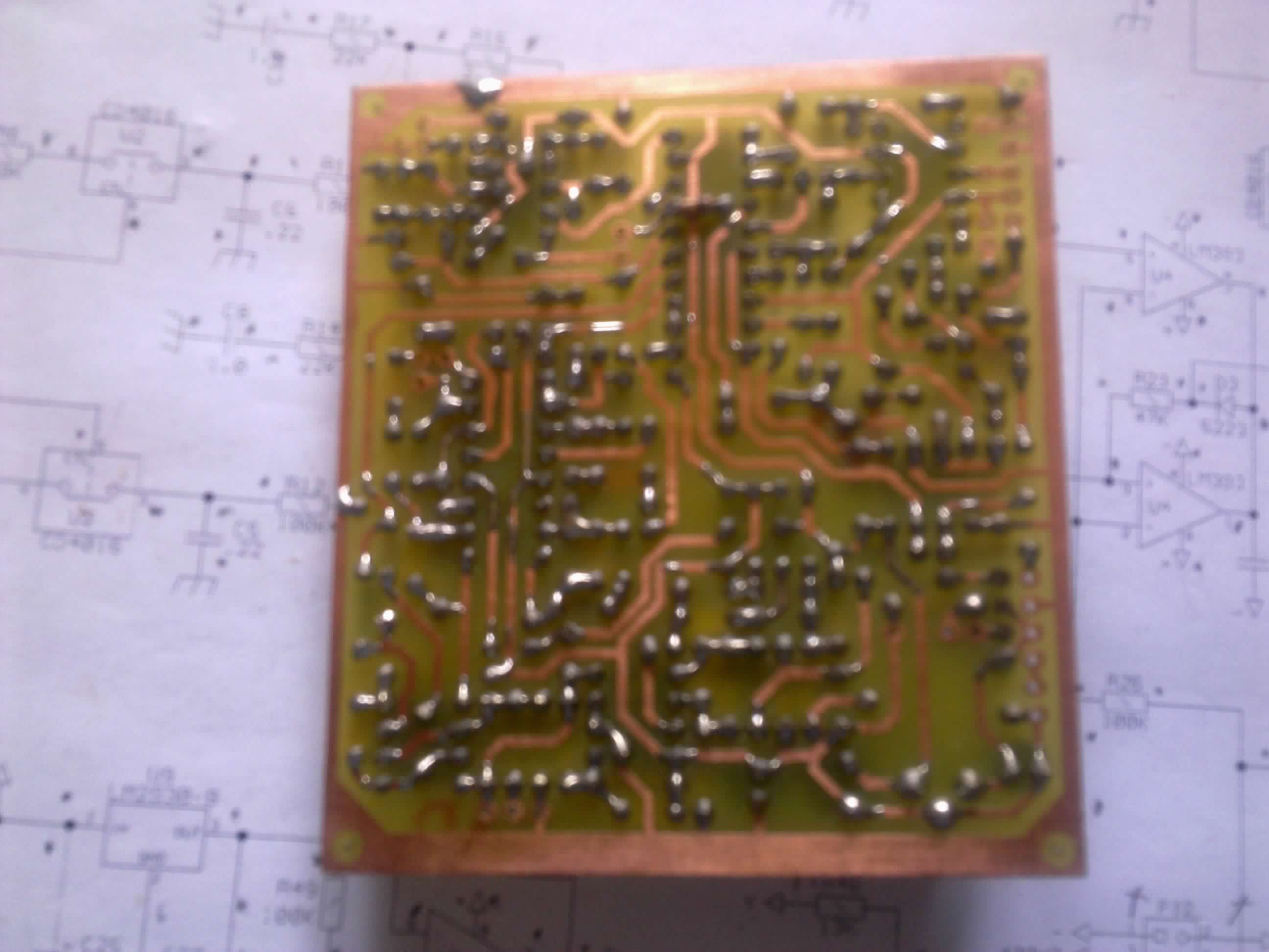

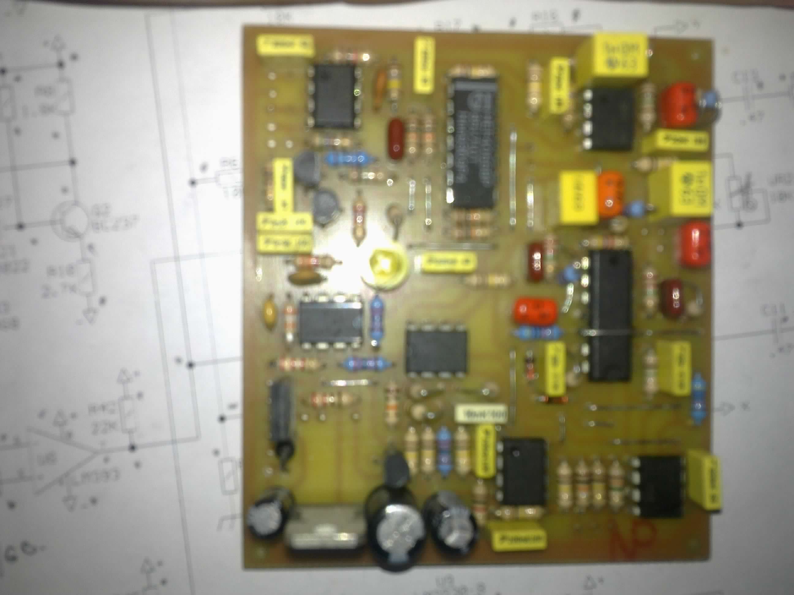

    PCB ready. I need to do the coil and the PCB VDI.

          Let we see the prototype of the VDI-calculator PCB:
            Lo siento por las imagenes borrosas,pero de momento el lo que hay. Cuando voy a terminar el proyecto,voy a publicar un video aqui de los resuldados.

                  Sorry. What he said in the previous post was that he felt the poor quality of the images I posted, but at the moment is there and when I finish the project I will post a video with the results. Greetings.
