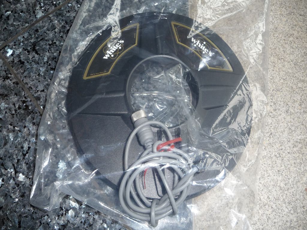

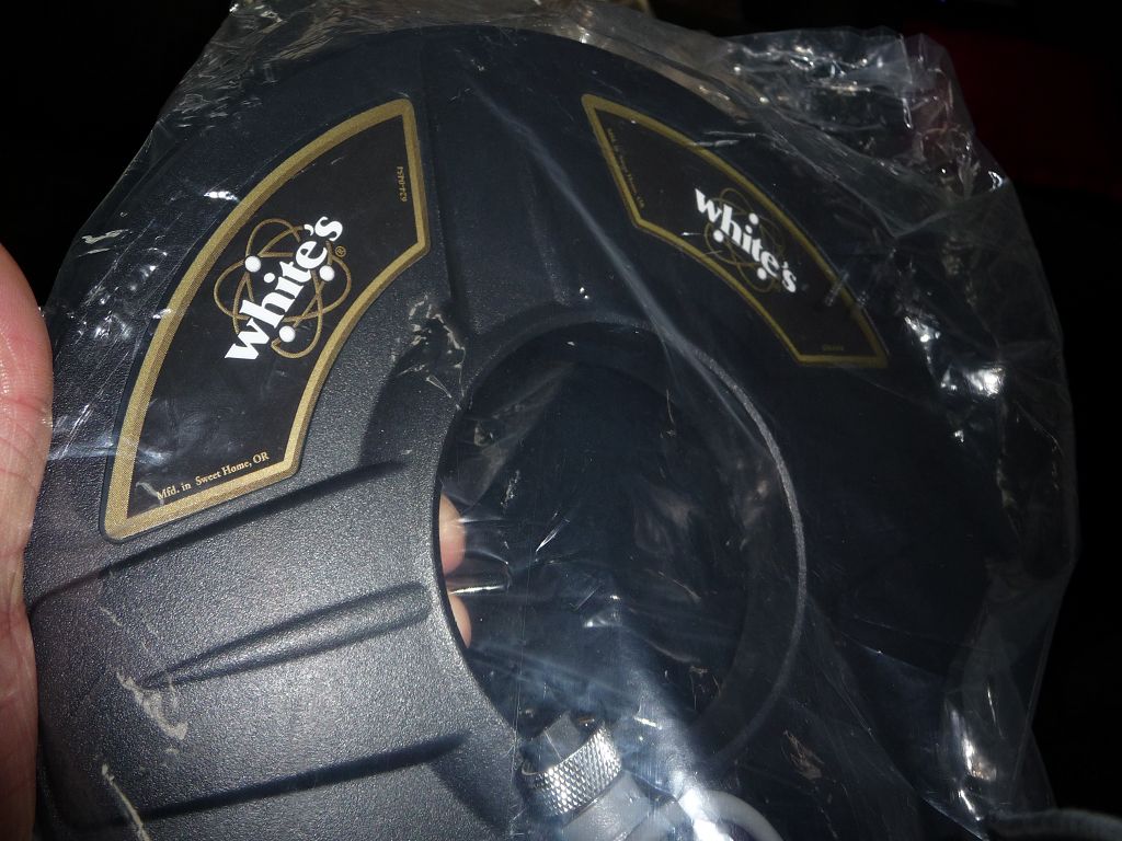

                    • Hi,
                      i have ordered a Whites Blackamx 950 "PRO" from a German Reseller. Today i got it, but it it looks like a other Whites Coil, not like a Blackmax 950.
                      The Part Number on Coil doesnt fits with the P/N Number on the Whites Website.
                      So is this coil really a Blackmax 950 Coil ??? i can´t belive it
                      many thanks
                      Firebox

                          • it is the blue max 950. i got the same....black max are out of sale, i think....
