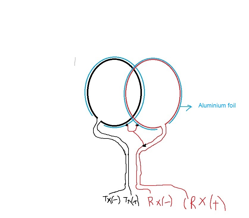

      Well shield connection rx(-) or tx (-) ?
      best regards

        Yes, rx - and tx -, but for idx is much better to shield coil's with graphite paint or spray and connect to -rx.

          On the normal IDX -Tx isn't ground but -V so would stop the Tx from working
          I found better results in wet grass if the shield is only connected at the PCB end. Original Classic schematics show it this way
          Depending how you mount your board and if its in a metal case or plastic and or your connector have a metal shell or plastic as to whether its better to connect the metal shell of the connector to ground or not

          • Aluminium foil shield connection this my picture is it correct ?
            • Originally posted by kuzen View Post
              Yap. Good luck on the next step.
              • thank you CDI,I will try best regards
                • Better ton`t connect both shields down in the head but connect each coil shield with (-) / (end) of the coil and by shielding of the cable connect to the ground on the PCB board. Оtherwise the depth will reduce by half.

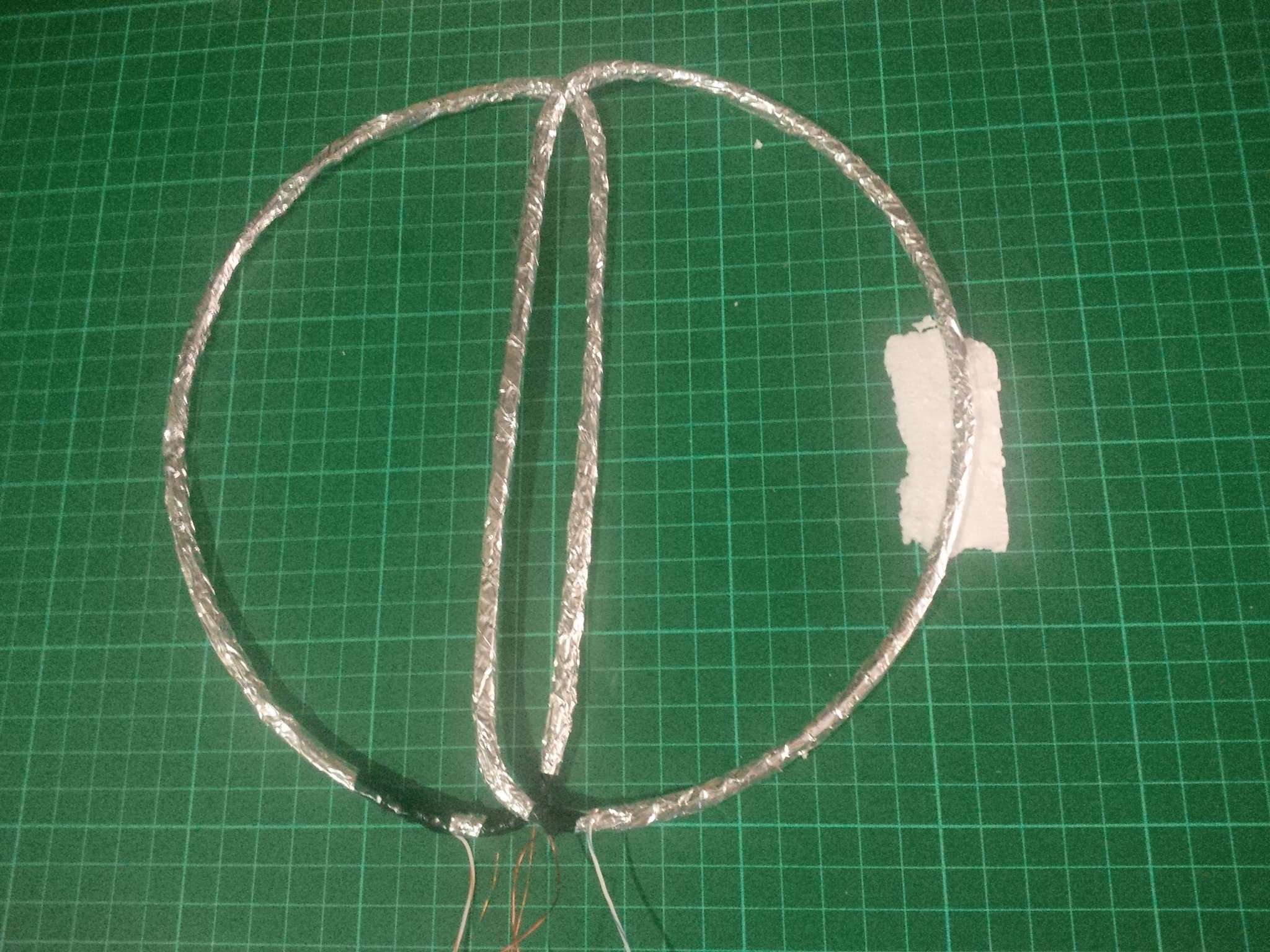

                            • Hello All,
                              Nice project IDX-PRO
                              I have been built this MD, before i shield Coil TX and RX, result is good,
                              Coin nickle can detect upto 25cm clear sound, nulling at pin 6 56mV peak-to-peak, TX 17V peak to peak, i use Hantek USB Scope 20Mhz
                              i have some problem, after my coil shield whit alumunium foil, problem is i can't nulling coil, at pin 6 2V peak to peak, and poor detect
                              How to solve this problem?
                              Thank
                              Wahyu.

                              • Is the shield connected? Had the same Issue with my TGSL.
