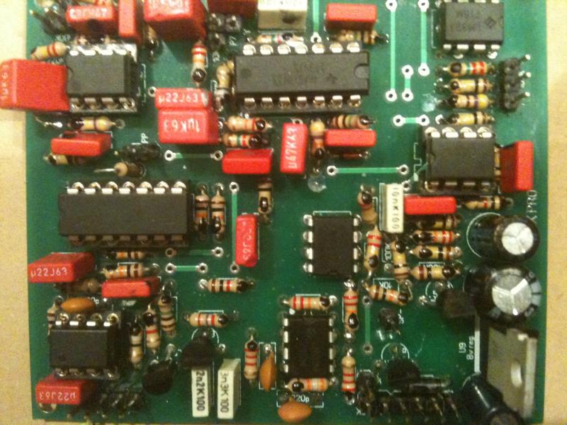

      • Hy
        i have a proplem with my idx board (Silverdog) i use a orginal blue max 950 coil the detektor work but i have no diskrimination i allready try to swap rx tx
        proplem is still the same,where i have to look for
        thanks compadre
        • you need to show us your build so we can see what you did wrong.
          Can you remember fitting a 100k in upright config - if not, t you are stuck in PP which is all metal mode.
            • can you redo with a better pic -- this is taken with good light and focus...Click image for larger version
              • Originally posted by compadre View Post
                Hy
                thanks compadre
                You can check which is the RX with a meter it has a much high resistance. If you get one of the connections the wrong way round you will get a double beep all you just need to swop the RX wires round.
