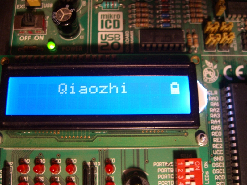

    It's called a custom charactor. Here is one description.
    http://www.geocities.com/dinceraydin/lcd/custom.htm
    Originally posted by holyuser View Post
    I do not mind sharing.
    Using PIC-BASIC looks like this:
    DATA 'Define User Characters into EEPROM
    4,4,4,31,4,4,4,4,_ ' CGRAM 0
    0,0,12,0,12,0,0,0,_ ' CGRAM 1
    14,31,17,17,17,17,17,31,_ ' CGRAM 2
    14,31,17,17,17,17,31,31,_ ' CGRAM 3
    14,31,17,17,17,31,31,31,_ ' CGRAM 4
    14,31,17,17,31,31,31,31,_ ' CGRAM 5
    14,31,17,31,31,31,31,31,_ ' CGRAM 6
    14,31,31,31,31,31,31,31,_ ' CGRAM 7
    FOR i = 0 to 63 'Loading User Characters into CGRAM
    READ i,char
    LCDOUT char
    NEXT i
    P.S. The first two symbols are not for battery.
    Thanks Altra and Holyuser! :friends
    Now it all becomes clear. It's time to go off and play. :good

      • Easier than I thought!
        • Originally posted by holyuser View Post
          And (of course) the first two symbols are the zero VDI marker, and the equals sign, in that order.
            You have to recharge battery!
              There are still a lot of power into the battery while the empty battery starts blinking.
