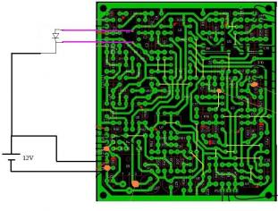

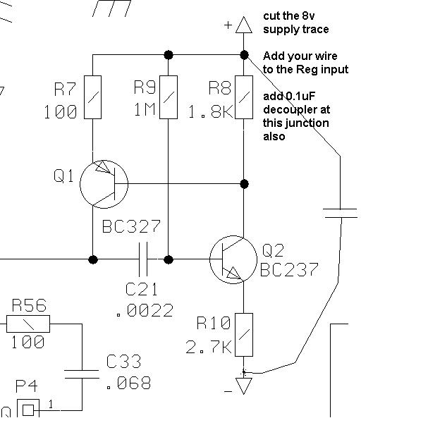

    • No I have disconnected the 12v as I do not know where to place the decoupling cap can you please fill me in
      • This is what I did

        • I cut the 8v line where you did .
          I do not have diode.
          The decoupler is to help strip ac tx signal fron the DC supply line. It will not alter the current flow thru the transistor.
          If yous is running hot it will run hot with the cap too.
          I would say as you have it is as good as they left the factory.

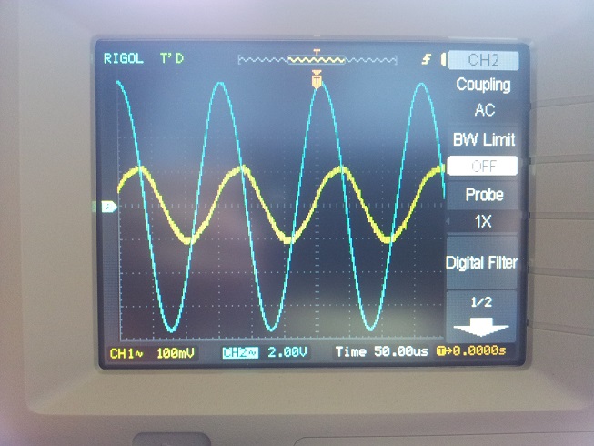

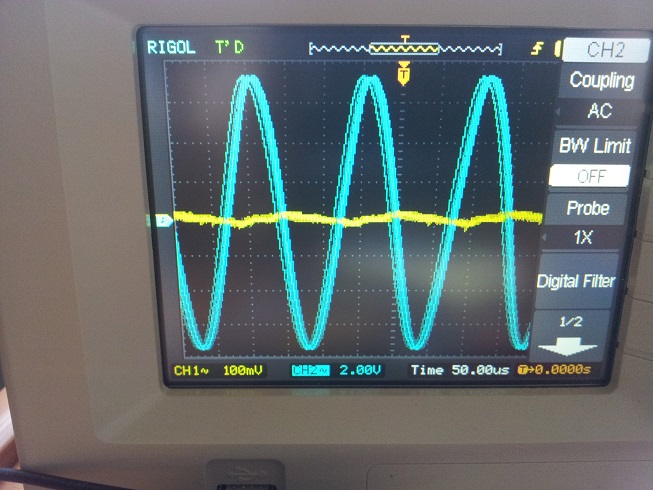

                • Hi guys! I am trying to make a concentric coil, but I do not know how should look the phase shift and the voltage of the pin 6 of the input amplifier. When I tune the coil what should I try to get - about a 200 mV amplitude (picture 1) or about 20 mV (picture 2). The blue line is the TX signal. Which one is better? What about the phase shift? Is it good on my scope shots?

                  • I think the amplitude you got is ok, sub 100mV is fine.
                    The phase delay is maybe a little high. I read on the IGSL / TGSL 20degrees is approaching a limit - if this holds for the idx your about 75deg.
                    This may not be as the design intended.
                    Do you have an IDX to try it on? You could test it and confirm or otherwise if 75deg is ok or not.
