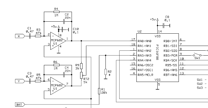

    • Arduino! (And the IDX).
      If there haven't been enough guys building VDI modules for the IDX, here is another one.
      I successfully got an Arduino UNO working connected to the IDX. I could replace the audio section with the Aduino module as well as the TX section, but this is just a proof of concept thing.
      It's not all that sophisticated as I just learned a little C programming this week. The last time I did any programming was some Fortran about 30 years ago ..What the heck.. It works!
      Needs some work to get better resolution though
      Anyway, here is a short video of the Arduino in action.
      http://youtu.be/lIbAG_UFMmM
      Don

        • Thanks for posting that Don. Just spent a good half hour studying your code and think I have your logic figured out. Simple and it functions. Good work!
          Gave me some good ideas to try.
          Jerry

                Yea, pretty simple logic, but then again I have a simple mind. The big problem I ran into was the math using either integers or floating point numbers and they would not always come out right. I played with the arctan funtion as well but I just simplifed things a bit.
                Another thing that I played with a bit to get right was the sampling period. The numbers still come out fairly close with only one sample of each channel.
                Don

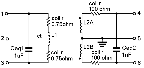

                          Revision of SH (search head) for IDX
                          This is a continuation of my response to Mr SLopov started in post # 570.
                          SLopov, the parameters of your search head are not designed correctly. In general, the parameters of the SH should be analyzed together with TX and RX circuits because TX tank circuit is part of TX end stage and RX tank circuit is part of preamp. It follows that in order to revise the design of the SH, we must first revise design of TX and RX circuits, and then assess whether your search head is suitable for them.
                          However, there are basic requirements for tank circuits, which are valid for all metal detectors:
                          1. Low resistance of TX tank circuit, for example 1.5 ohms. If TX coil has more resistance, the TX operates with decreased power and low efficiency because a lot of battery drain is wasted in heating the coil wire.
                          2. Impedance matching of load (TX tank circuit). For example, the TX power can be increased 4 times if the coil is connected with center tap (noted below as "ct").
                          3. Large equivalent capacitance of TX tank circuit, for example 1uF. If you use a smaller capacitance, you should increase the mass of wire to get the same efficiency of TX end stage. Capacitors must be type MKP (low tan of dielectric loses) to avoid wasting electricity for dielectric heating.
                          4. Enough high resistance of RX coil. If we design RX coil with smaller resistance, the weight and the stray capacitance are unnecessarily increased . In theory, when we use a low resistance coil, the thermal noise generated in the RX input decreases. In practice, this has no noticeable effect because there are two sources generating more noise - the integrated circuit used as preamp and the resistor connected to its inverting input. For example IC NE5534 generates noise as a resistor (or a coil) having resistance 1000 ohms. Additional noise generates the 1kohm resistor R1 connected to inverting input. It increases the noise sqrt 2 =1.41 times. In this case, even a 500 ohm RX coil can not increase noticeable the generated thermal noise in input. However most important is that RX sensitivity is not limited by thermal noise but by AIR & GND signal existing in the input of preamp, which forces us to reduce its gain. Moreover, the synchronous demodulator is not so sensitive to thermal noise.
                          5. Small equivalent capacitance of RX tank circuit. This allows us to increase the number of turns, so that RX coil will generate a stronger signal.
                          6. Balance adjustment by operator. The construction of SH must allow the operator to perform outdoor fine induction balance and minimization of AIR & GND signal. Then he can increase sensitivity to maximum by increasingthe gain of preamp near to its saturation in output.
                          7. SH should have two RX coils connected in opposite direction. The advantages of this "twin loop" design are that no need of shielding and the search head can suppress the GND signal and other interfering signals generated by distant sources.
                          Below is the equivalent circuit of a SH, suitable for all TXs with driven end stage and for the self-oscillating TX circuit used in Classic family.
                          The TX used in Classic family is not correct designed. The self-biasing can not suppress amplitude modulation when the operator changes height of search coil. The design of TX in Classic will be revised in the next my post.
                          • Hi Friends,
                            What compiler was used to convert the file asm into vdi_02.HEX?
                            • I have built the VDI kit from Silverdog and have run into a problem. The PIC microcontroller does not seem to start running. Occasionally it will start if I run my hand across the bottom of the PCB. When it does start, I get a normal display for a brief time. However, within a few seconds the display will become full of block characters and then it seems to lock-up. I have checked the 5V supply and it is good. I get the feeling the internal oscillator may not be running reliably. Has anyone else had problems with this?
                              • The problem could be caused by the LCD or bad solder connecting wires.
                                Internal oscillator works very reliably, if the PIC programmed properly.
