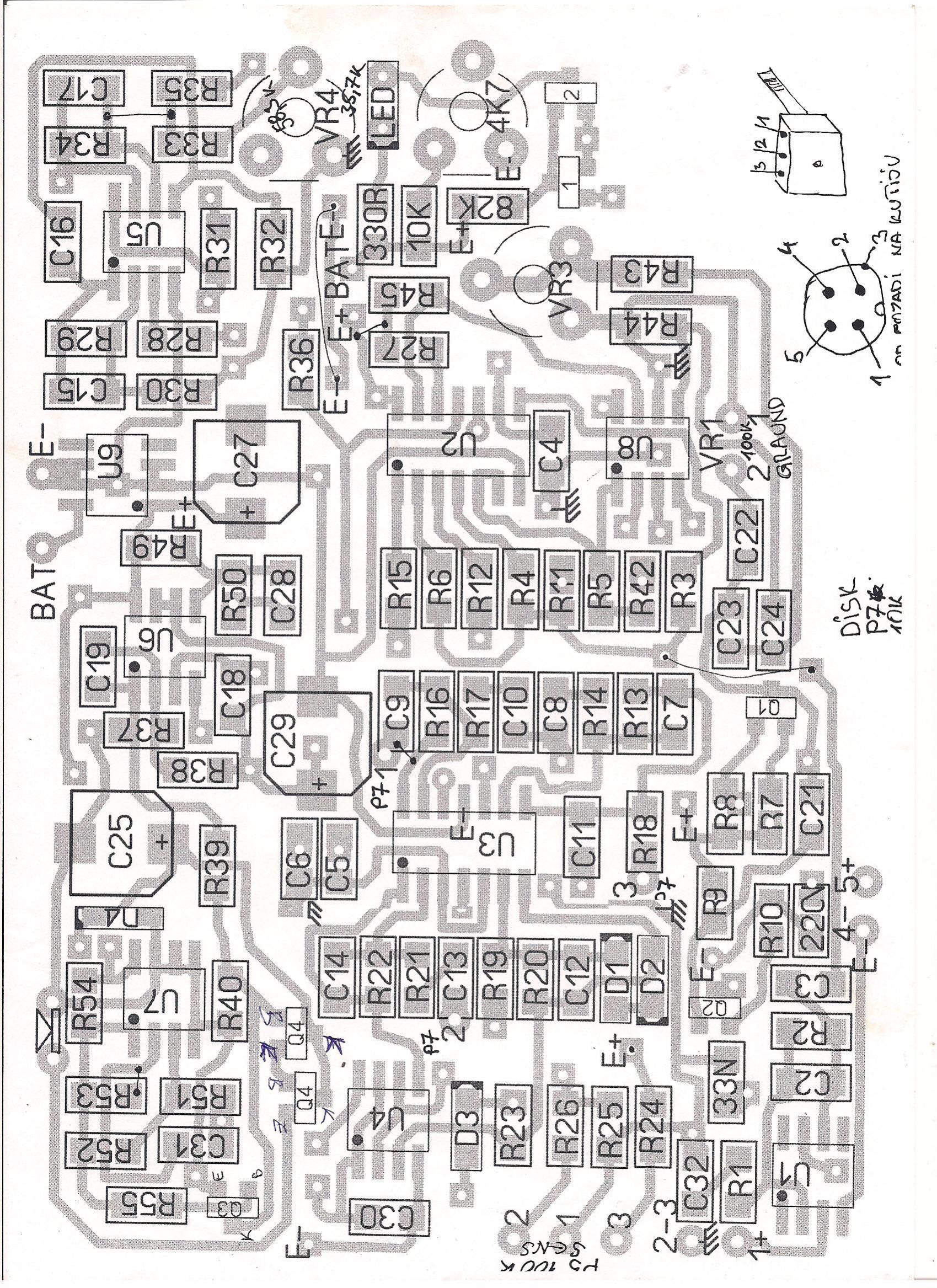

    • IDX-PRO FINAL.
      Hello everyone. I finally tried the IDX-PRO with the DD coil 27cm and is really incredible. 1€ coin to 60cm in the air. I'll post here the connections of potenciomeros because there are people on this forum I wonder how they connect private message potentiometers and everything else. Here everything is correct and guaranteed. Enjoy!

            • idx pcb made with SMD components
              • Orbit Hello! No change in particular. What I did was draw a new PCB. What I want has been to make the IDX-PRO DD coil and see how it works and nothing else. If you are bothered that I have here in the forum my results, I'm sorry, but I understand that this forum is for everyone and I love sharing my projects with everyone. If you have done in the past, this project seems very good, but I quieria take a chance on this project to see how it works. What you are doing now, is that despise my job. In this thread I will not publish anything else. Sorry. Greetings to all.

                        • Originally posted by Sean_Goddard View Post
                          I suspect the protection is nothing more complex than that but of course I COULD be wrong!
                          Yes, You are wrong.
                          ALL this system is doing is measuring the RATIO of X to Y, you will see that one input goes to the Vref input. This is how a simple ArcTAN is done so you can simply enable the appropriate input as Vref and NOT an analogue input, then read the ADC value DIRECTLY to get the VDI
                          Nothing close.
                          Your supposition is very far away from the truth. Take a look at the datasheet carefuly, and You will see that noone input not goes to the Vref input.
                          The system is measuring VDI by calculating arctangent of y/x using math method in 16-bit precision. The precision of A/D conversion is 13-bit using oversampling.
                          So, the final precision is better than 0,3% of degree.
                            Eduardo did you used this data for 27 cm DD coil:
                            TX wire from 0.70 to 35 laps - 0.587 mH - within 1 mF capacitor
                            RX wire from 0.15 to 270 laps - 35.6 mH - 0033 mF condenser inside?

                            • Yes. Air test.
                              • saw a curious thing in the behavior of IC LF347. I have a dozen LF347 and seen that there is one that has less gain than the other and testing in the air I noticed the difference. The secret of the scope of this detector is also is the IC. I recommend putting an IC socket and go for this by checking with several to get the maximum profit. The SMW was the same. Greetings.
