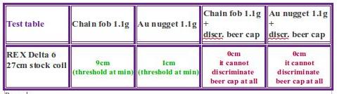

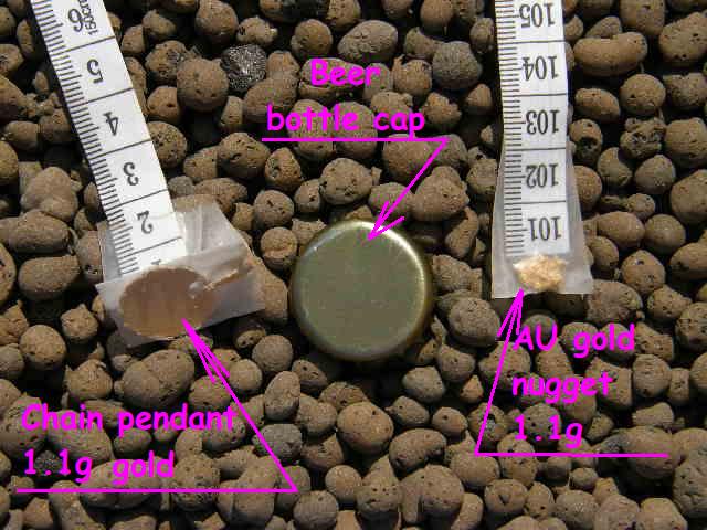

                    Your gold test would be welcome Daniel.
                    I done in past gold test with my REX Delta 6 (another LTC64 Bulgarian cousine) which was promoted by German and Italian dealer as very sensitive natural gold detector.
                    Look at test results. You notice the same weight of gold pendant and genuine Australian gold nugget? The same weight of gold parts but how much different results. I doubt that LTC64 can achieve better results on gold nugget than REX Delta 6.
