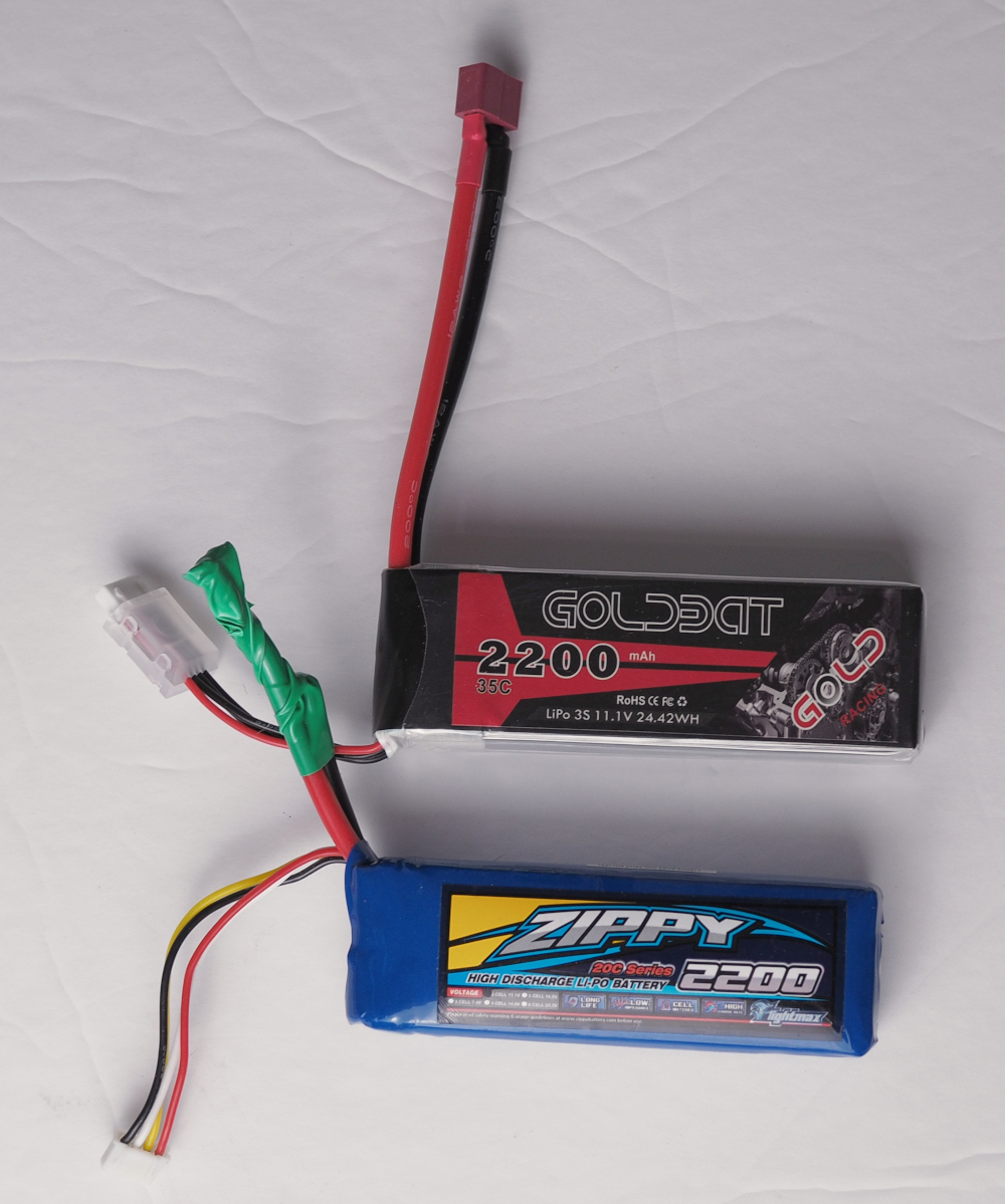

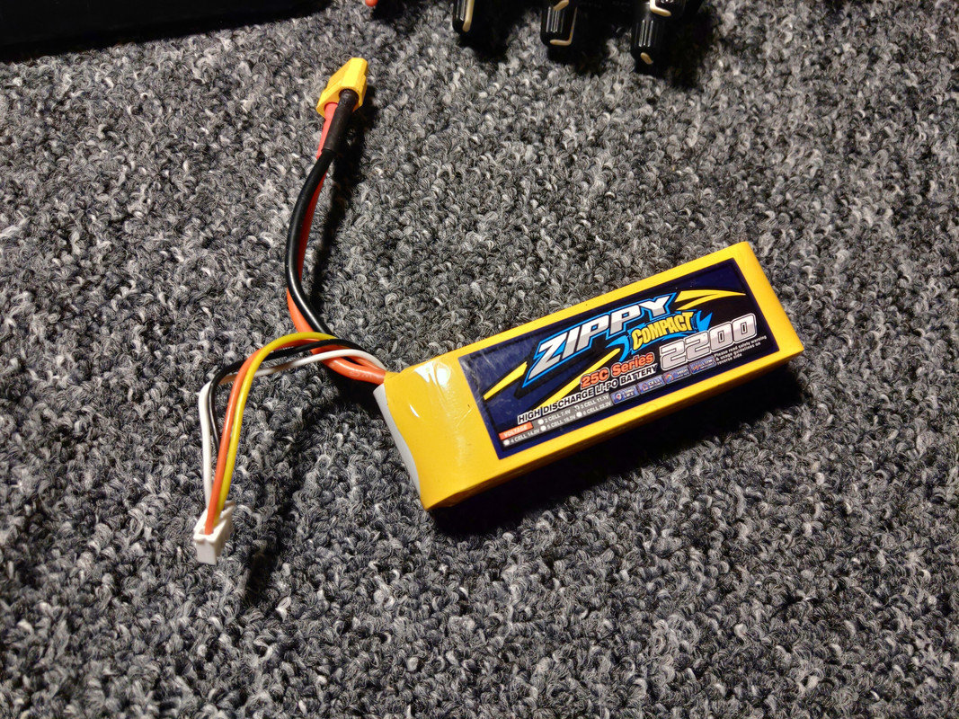

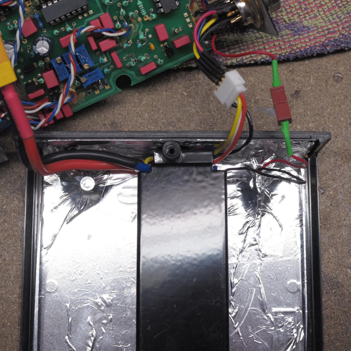

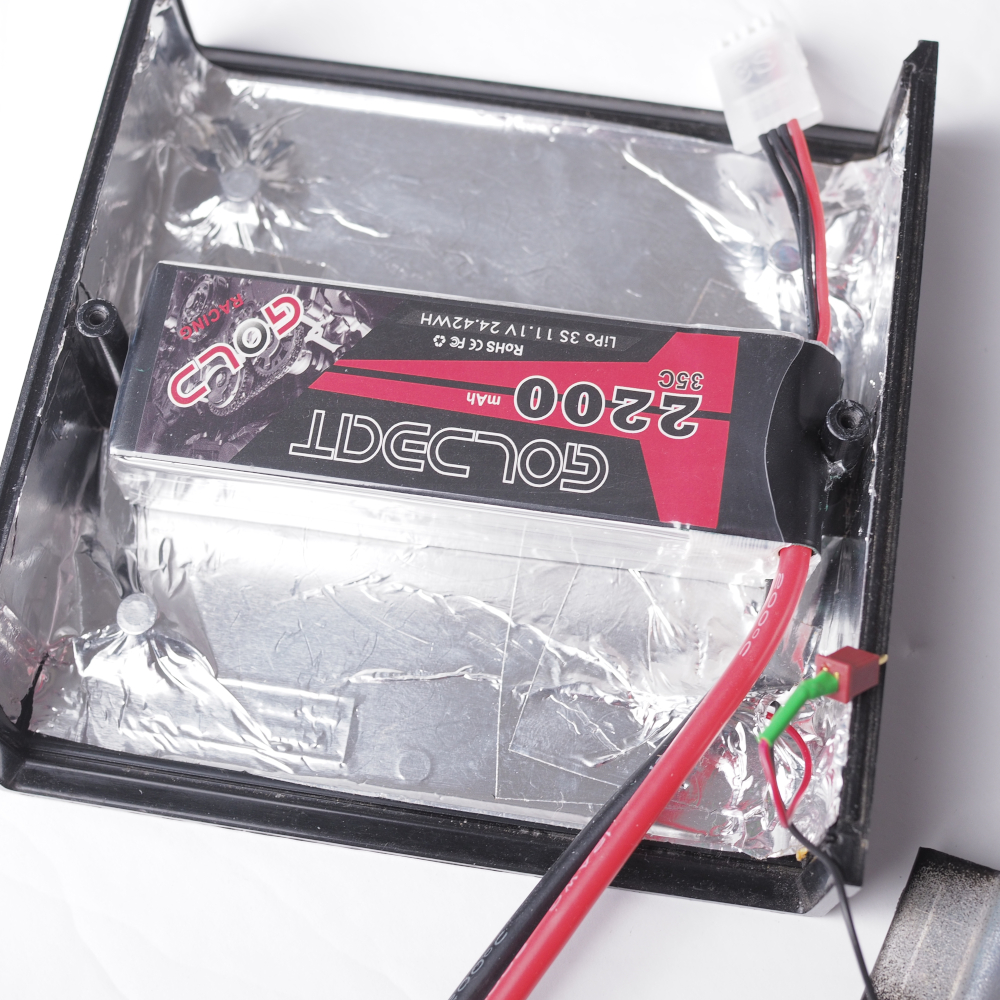

    • I just had to replace my V5 battery (Zippy). One cell in the pack went bad and the pack swelled up.
      https://www.amazon.ca/gp/product/B07...?ie=UTF8&psc=1
Name:	blissV5 bat mod1.JPG
Name:	blissV5 bat mod2.jpg

      • Great job - lightweight, balance chargeable and 11 volts!
        I guess the Blisstool should get at least its 10v to provide enough depth.
        But its better to test this - if the depth will be the same with 7,5 volts.
        Because due to electronic parts, 11v can become reduced to effective 7,5v very fast.
        At locations inside the MD where the voltage really counts.

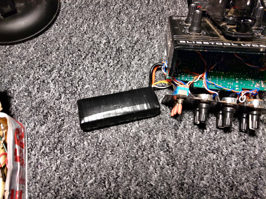

                • Hi Guys.

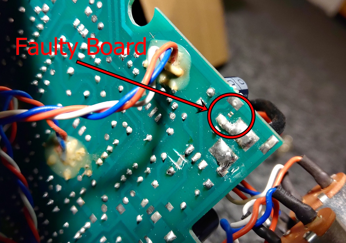

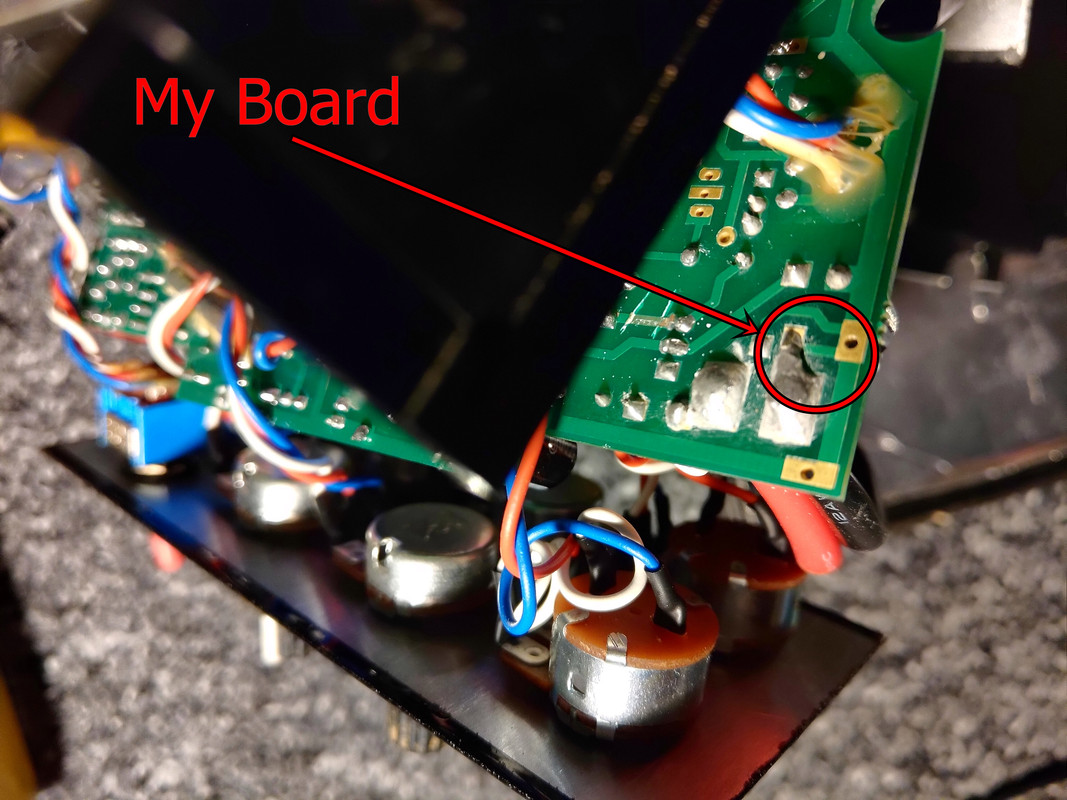

                  quick question. is repairs to a Blisstoool V6 machine and other versions difficult. i have seen some posts on a few forums wear people are saying that no one will take on trying to repair faulty Blisstool machine. is this the case and why would that be do you think. why i ask is that i have a faulty V6 that won't turn on. the battery is good. so it is not that. i did notice on the back of the board that there was a copper trace that had been tampered with. as you can see in the first photo. so i bridged it up with a wire to see if it was that and would bring it back to life in any way. nothing happened though. i do have a another working V6 so i decided to open up that one to look inside to compare the two boards to see if i mite spot something else going on. on exposing the back of the board on the working one. strait away i noticed that the same area on the working board has the copper trace broken in the same way. so that's meant to be like that. i un-soldered the wire that i had put on the faulty board and had a good look at comparing the two boards, but i couldn't see anything that looked odd on the faulty one by just eye balling the two.
                  thanks guys

                  • When you turn it on does it draw any current at all? Best place to start is measuring all the power supplies.

                        Hi again guys. i have getting it working now. tonight i had another look at the two boards comparing with a better eye peace. i saw something this time round that i some how missed seeing the first time round that i looked. here is some pics. i am not quit sure if the owner of the machine before me who had it, when replacing the battery mite of had the machine turned on when the battery was clipped in place and shorted the board on something under neath and never noticed it happened. i am not sure what make my original battery is that is used for the detector as is it all wrapped up black tape. the replacement one is slightly larger and does not fit under the battery cover.
