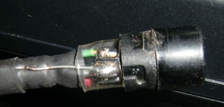

                    But the Blisstool made me trouble, too.
                    All of a sudden huge erratic beeps started while slightly touching the coil-cable.
                    But I found the problem:
                    A tiny free wire soldered to the coil-cables shielding pin was the culprit.
                    This wire should touch the metal-part of the connector to
                    ground the housing while connected.
                    This is an absolute no go! This has to be soldered from the
                    inside and directly. Solution: Rip this wire off (you can see it below)!
                    And the plastic connector of the pole was broken again -
                    repaired this thing already but that stuff is too weak.
