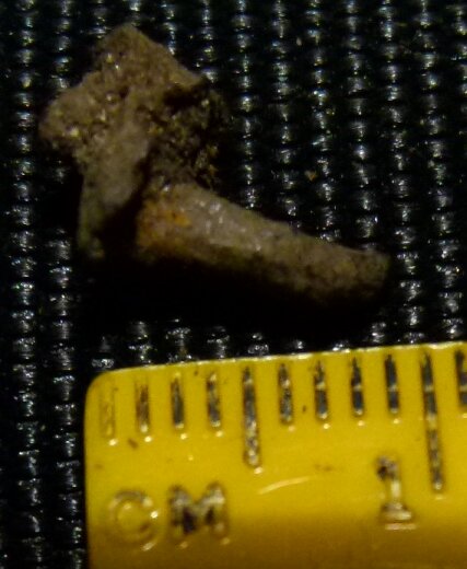

        By pure chance yesterday I found a second nugget-size object. It's not that unusual, because I'm looking
        for very small coins at that site and for those someone also has to listen very closly and move the coil
        directly over the ground.
        This micronail looks big on the foto but it isn't. And the weight is far below 1 gram, perhaps 0.1 gram.
        It was found 5cm below the surface at a region with massive electrosmog. No chance if you don't hit
        the spot within 3cm tolerance exactly with the 28cm coil. But without electrosmog the Blisstool would
        have detected it at 7-8cm.

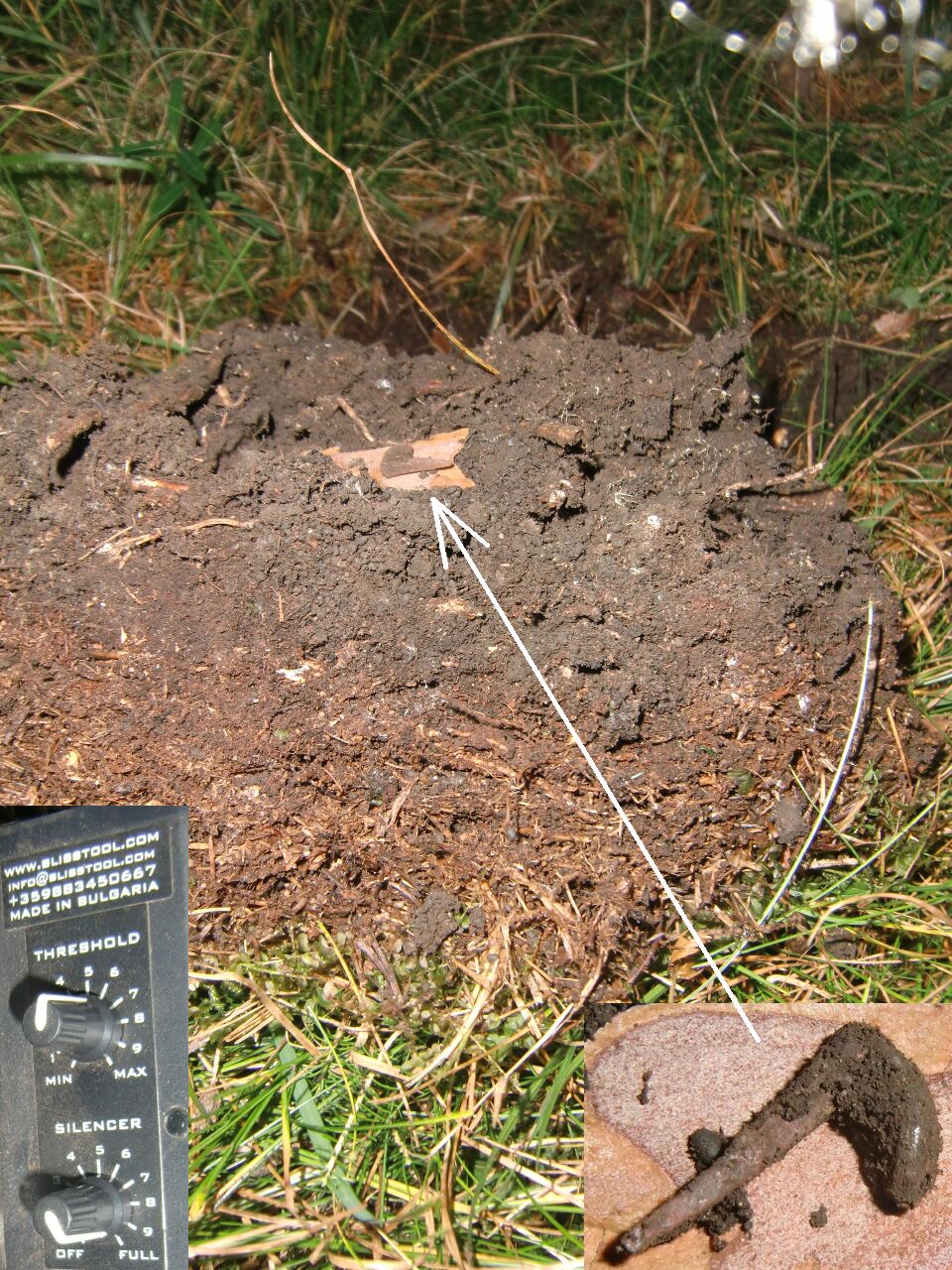

        Another nail I found 3 days ago under the same "extremly noisy" conditions. This nail is 1.3 cm.
        It was detected ca. 10cm below - at exactly the depth where you can see it on the grass bale.
        Only put a thin piece of bark below the nail to show it better. Better conditions depth: ca. 13cm

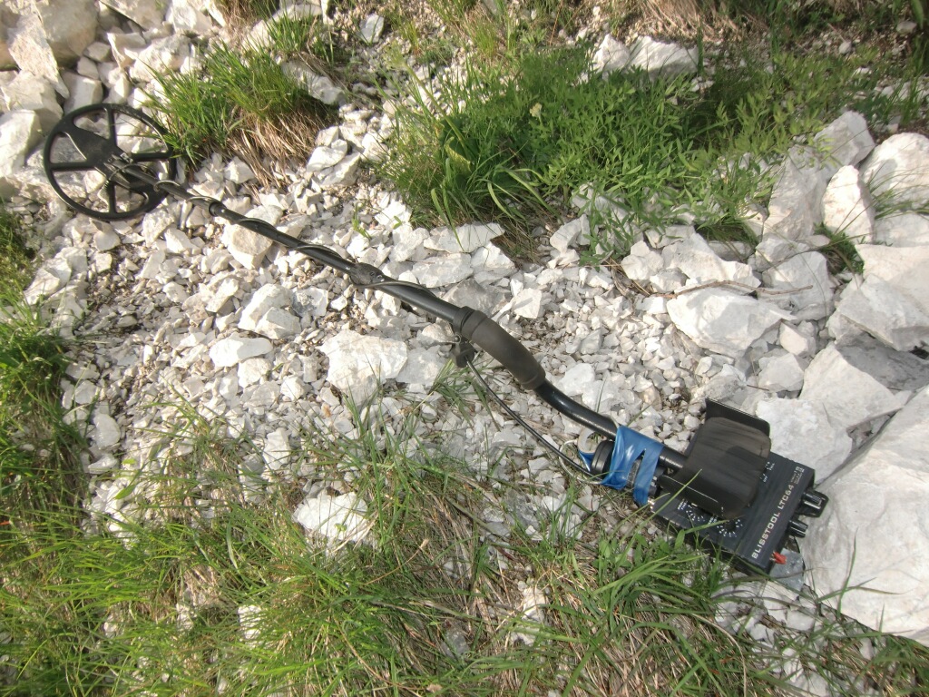

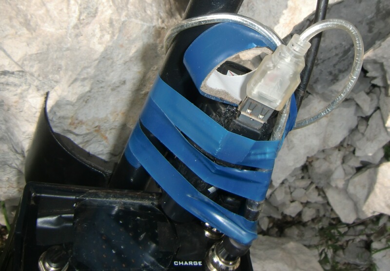

                          • 2 weeks ago I had the first time the opportunity to test the accu-mod outside.
                            After 3 years of my usage of the Blisstool LTC64 the internal accus still are lasting around 70h of search.
                            The accumod worked great - I fixed the pack simple with tape inbetween the coil-cable and stem.

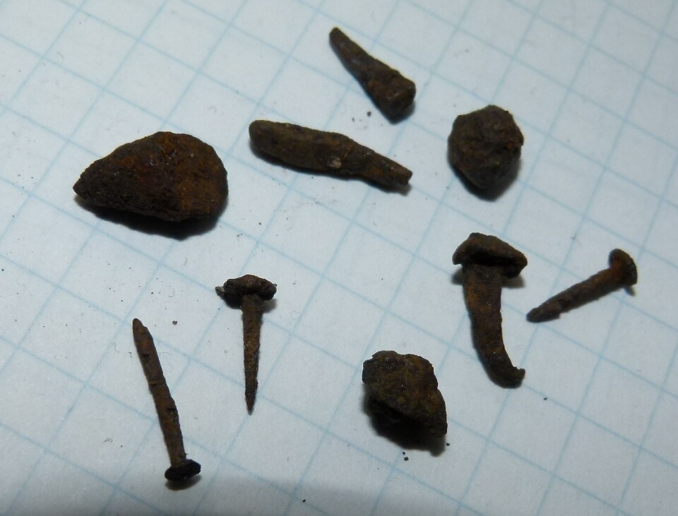

                                below a little selection of micro stuff - each square is 5mm - I found with the Blisstool.
                                Its no problem to detect such things with a usual detector that uses a 4-6'' (10-15cm) coil and if those are close to the surface,
                                but its tough to catch them with a 12'' coil and at a highly infested e-smog area and up to 7cm deep.
