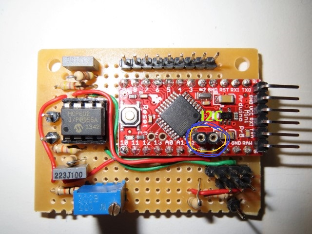

    • Hello,
      can everyone post (or send pm to me) pictures from both sides of the ready build pcb for the arduino?
      • @Prospekteur: I'm not sure what PCB you are referring to, I assume its opamp board as all others are "off the shelf"; I will look if I have a picture of the bottom side that I built; I know I have top (already posted). I have the board glued into the box, so I can't take it out.. If I find it I'll post it in few days (away from home now....)
        • I need the top and bottom side of the attached pcb;-)
          • Yeah, that's the one I meant. I'll look.

              • Originally posted by Prospekteur View Post
                Sorry, I checked. I don't have the bottom view of this board.
