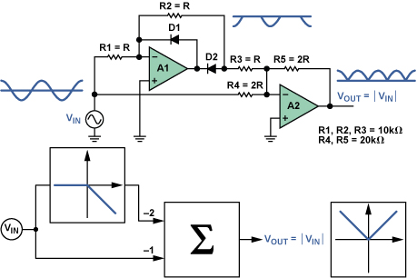

    • Full wave rectification?
      • In principle?
        • Op-amp Inverter?
          • Use the circuit in the link below. It uses ac coupled differentiators to isolate the dc power supplies between the md and micro. It also creates a virtual ground at 2.5v for the arduino. The 10bit adc will read 511-512 for zero signal. Negative signal is < 511 and positive is greater than.
            See post #132 by holyuser, just replace pic with arduino

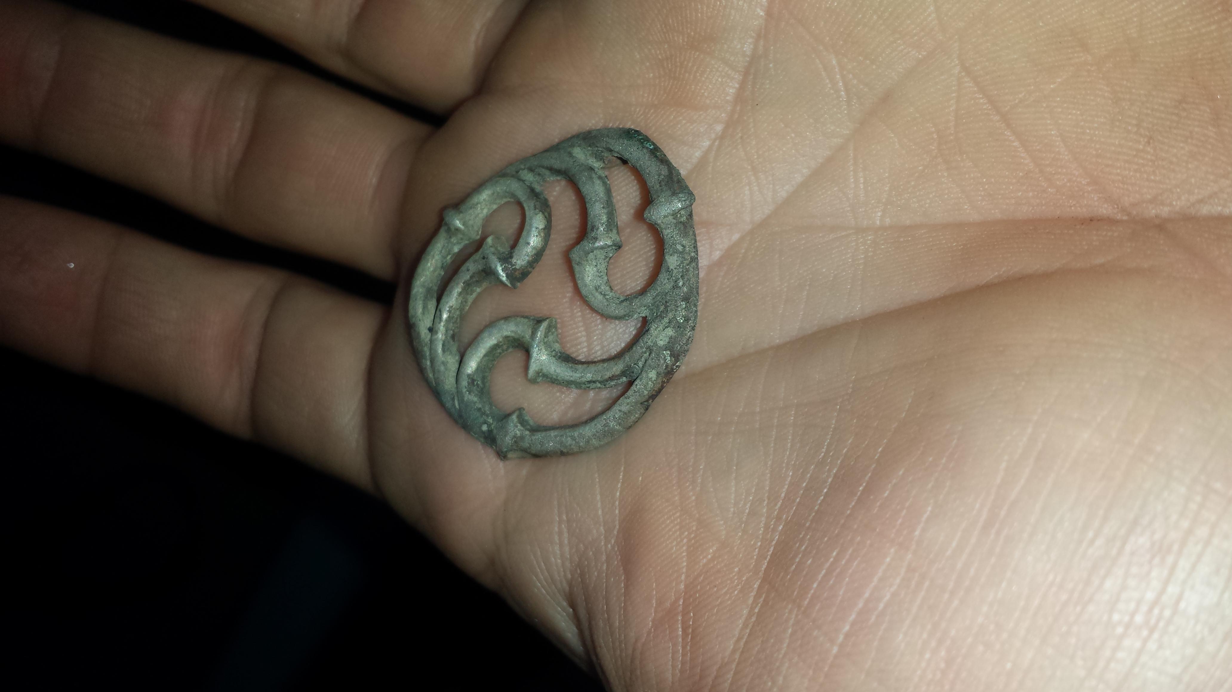

                              I found this at nearly 20" in the Roman field.
