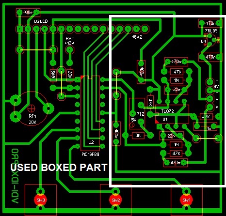

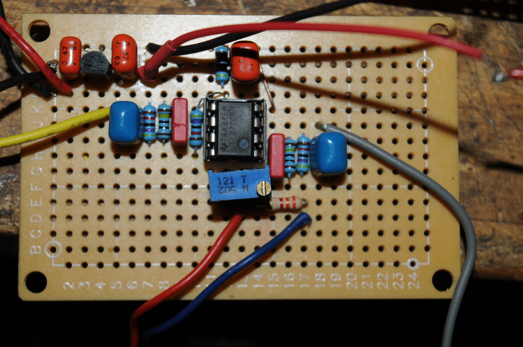

                  • Can anyone offer useful help please, before I start pulling my hair out! I used a portion of the VDI-IDX-PRO to make the preamp (see photos) and hooking up outputs to A0 A1 to a Nano, The problem is I need ground from the IDX to ground to the nano, but there seems to be a power issue, the idx does a odd grunting noise , if I measure the Neg- wire of the preamp board to the ground plane of the IDX I get plus 7V
