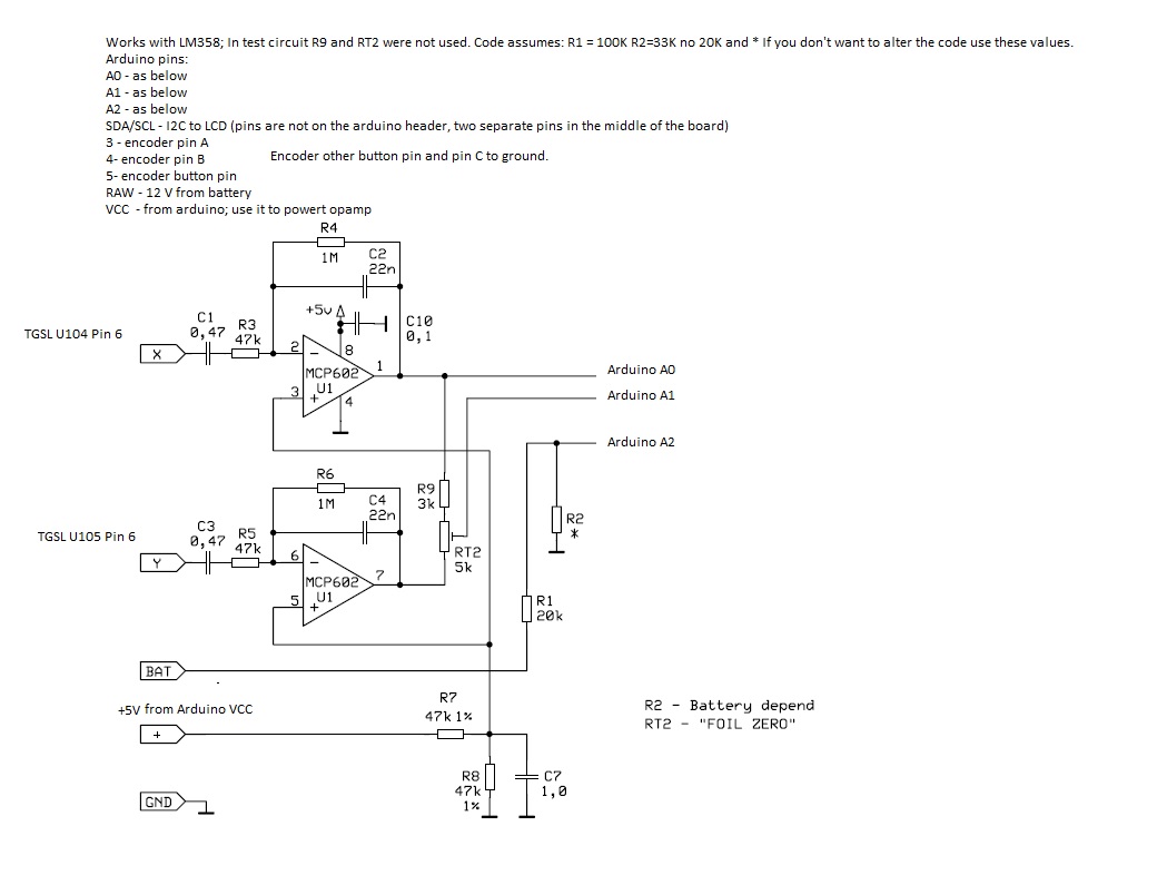

                      The schematic is basically IDX - VDI front-end with Arduino in the back. Don't mix VCC and RAW on Arduino

                        What voltage are we trying to get at A2 ?
                        • #87
                          Va2 = Vbatt/4.124 = ~ 3.9V
                          The ADC scale factor that calculates Vbatt is 4.124, so whatever is at A2 will be multiplied by that factor and used as current battery voltage

                            U104 and U105 PIN 6 are not too amplificated and almost binary to drive another very amplificated stadium of Vdi preamp? Should not be better using previous X and R point of TGSL?
                            For increase output swing of LM358 it could be connected to a more higher positive rail...not 5 of arduino 5V out but maybe a voltage divider + zener from 12V we have...what do you think?

                              To be more clear:
                              I use this mod from Davor on my TGSL:
                              http://www.geotech1.com/forums/showt...9-TGSL-EDU-Mod
                              It showed a nice improvement in my MD.
                              But as you see, feedback in U104 and U105 is limited by 2 diodes (not 1 like original scheme)...this makes things not as linear as before. Connecting VDI here and amplificating with another hi-gain preamp should probably degrade the quality of signal to analize in arduino.
                              Did you tested connecting VDI preamp in U103 pin 1 and 7? You could have less sensitivity but perhaps more precise input for VDI...I'm wrong?
                              To have a output swing of 0 to 5V in LM358 (and not 0 to 3.7V or 4V) it should be powered by something like 5V + about 1 or 1.3V.
                              It could be easily made with 78L05 adjusting output:
                              (image show 1 Ampere LM7805. We could use 0.1A version: 78L05)
                              http://www.rason.org/Projects/regulator/regulator.htm
                              6V for example using R1 = 470 Ohm and R2 = 100 Ohm.
                              Using 12V from battery as Input Voltage for 78L05. It should provide 100mA current.
                              In this manner you can obtain LM358 with 0 to 5V output swing...
                              • #90
                                all you have described should be fine. I'm waiting for 602 opamp to put in, it has 0-5V swing on the output. 358 has output I think 1V less than Vcc, so yeah if you bump Vcc to 6 you will get nice output range. (I think you meant 7806, or just use diods to loose some voltage).
                                As far as the input point for circuitry U104 and U105 outputs were used because I they have good levels (did not look saturated). I intended to make opamp with gain 1 just to buffer signal up. After playing with the circuit 47K/1M gave the output that was OK. Its the 0.022u that affect the gain a lot. I initially by mistake put 0.22u and was scratching my head for a while because I could not get enough gain. In short: you can get your signal from any point as far as the inputs A0, A1 are 2.5V with no target and then swing up/down preferably without saturation.
