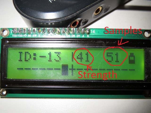

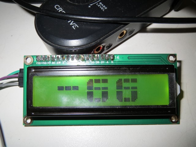

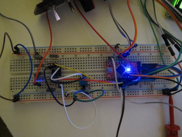

                    I got the VDI to work. Signal is shifted and both positive and negative sides are used. The arduino program is done from scratch; GUI is based on 16x2 LCD and rotary encoder. Almost all options of the algorithm are exposed trough LCD user menu. Min signal strength, min sample count, max sample count, digital filter size, filtering method (avg, median), real time signal strength monitor, ADC calibration, battery voltage, VDI indicator style, end of signal detection params, oversampling control.
                    I use LM358 single-side powered with 0 and 5V. It swings 0-4 on output. Circuit is like the one for IDX-VDI minus balancing resistors (R9, RT2 i think).
                    Seems to work fine.
                    Arduino Mini Pro 16MHz, 5V with LCD (dimmed with 1K) and opamp takes 12V/25mA. Arduino is powered using TGSL's 12V and it suppliers 5V for the opamp (mini has a 5v regulator). I'll swap in MCP602 when it comes from china; it should have 0-5V output swing.
                    VDI range is -90 to 90; Signal strength (average sample value) and number of samples is displayed.
                    Code has comments which pins on arduno/TGSL are used.

                      Is this the right board ?
                      http://www.ebay.com.au/itm/Arduino-P...item417e33ba11
                      • #71
                        Yes. That's it.
                        You will also need USB to 5V serial to connect it to PC. Just search ebay for "USB to serial TTL arduino"
                        I had 16x2 I2C LCD and that;s what is coded up. But you should be able to change it to any LCD with not much effort....
                        The code should work with shifting and non-shifting circuitry. The ADC calibration should to "the right thing" regardless.. (But I have not tried it...)
