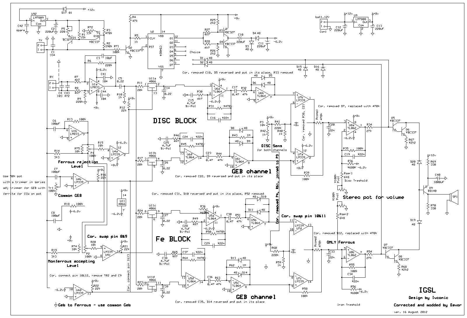

          • Thanks for you response, I expressed wrong, I understand ,and saw all code. and was amazing,I used this code for improve with other hardware in protorboard... is very full, but I wasnt undersntand that the proyect is about modify the silverdog, and I asked for the schematic (pcb)for hardware I mean I looking build the pcb for silverdog and I asked about this schematic or similary. Thanks hyena...
            Maybe is the picture that upload hear that Im looking for buid, but I like that somebody confirm is such as silverdogClick image for larger version
Name:	IGSL MUSK-coils_Davor's mods.gif
            • I can not understand what you exactly mean. I think you have IGSL and want to wire VDI? If so, this is what you are looking for:
              http://www.geotech1.com/forums/showthread.php?17861-IGSL&p=162010#post162010
              Or? It looks like you are using translator...

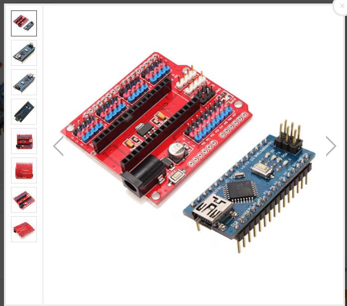

                • You all should just order some of these. They can do everything a Uno can do and are 1/4 the size. Ordered three and the came from China in about 7 days.
                  There small enough you could fit them in the case of some detectors.
                  Use a LM78L05 regulator. Coming from a battery you don't even need any other components just the regulator. TO-92 ...
                  All drivers available. See Description on link above for USB driver. Had mine up and running programs in about 10 minutes tops. Arduino site has your program / compiler ready for you ..

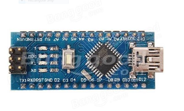

                  • Actually you dont even need redulator. Arduino Nano has 5V regulator on the bottom side (in link you posted). Just wire 12V to pin VIN and turn it on...
                    • Originally posted by Hyena View Post
                      +1
                      • Yep it sure does. I didn't know AMS1117 was a Regulator. Well that saves 10 Cents ! LOL
