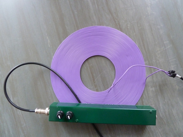

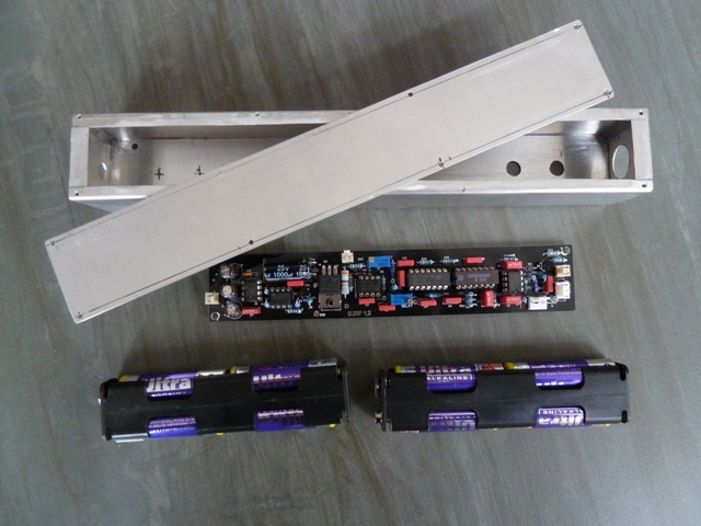

          I also bought the fine kit from Silverdog . It was difficult for me to find a suitable housing for the circuit . So I built it myself. Made of aluminum sheet.
          There was a problem when installed in the housing. Every time the circuit was installed - nothing worked. I was almost in despair ....
          I have searched persistently for the cause.
          It was the metal housing.
          The headphone jack must not be connected to the "ground" (metal housing). After isolation of the Headphone jack -- the Surf PI works perfectly!
          I love it. Nice small and fits perfectly to the detector - rod.

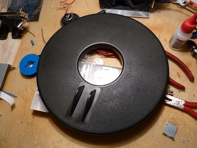

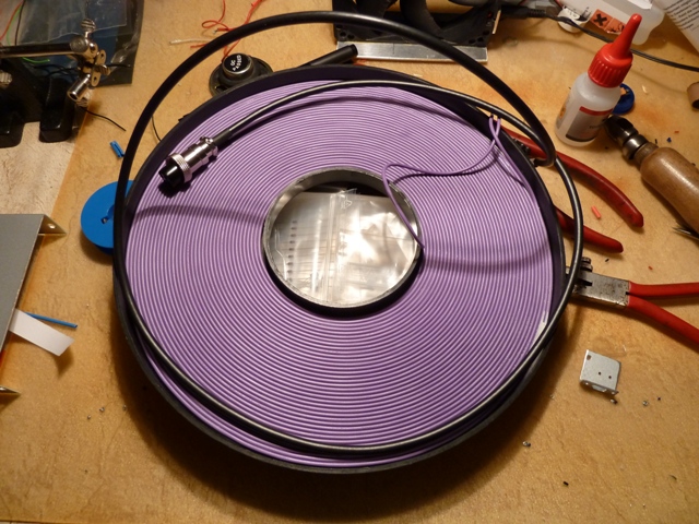

              The coil I want to installed in a coil housing from Georgi Zehlev.
              But I still do not know how I can shield the coil. So I will only test "without anything." (Resin, etc) Maybe the Surf PI works even without shield ....

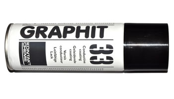

                Yes, it will work without a shield, but you will notice that your detector will react to ground minerals. For a simple shield you can use graphite spray. it is not cheap, about 12 euro for a can...

                      Yes. I know the Graphite - Spray (CONRAD). I have read much in this forum about shielding. There are so many materials (Mylar, lead tape, copper tape, aluminum foil, etc).
                      Mylar I have tried. (Space blanket). But it does not conduct. I tested it with a continuity tester.
                      Kitchen aluminum foil I have also tried - coil has a very damping. A few inches deep loss ....
                      HOWEVER, I got me a couple of weeks ago, fine graphite - bought powder. Very Inexpensive. I will mix it with boat varnish.
                      Whether shielding even in flat spiral coil works ...?

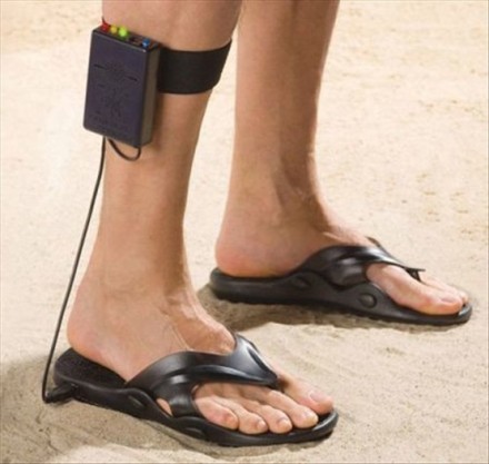

                            Good idea to use in your country: Slippers are equipped with metal detectors can sense the metal object. It is powered by a 9V battery to sustainable work for 6 hours.

                            • #44
                              Genial idea with the sandals! (Although the plug bottom right will not hold long in real use, I think).
                              If I can something can build myself ...? Certainly.
                              A little flat coil with a shoe insert. best glue with silicone. I will certainly try.
                              No more stupid questions from viewers on the beach ...

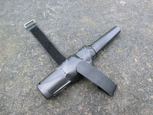

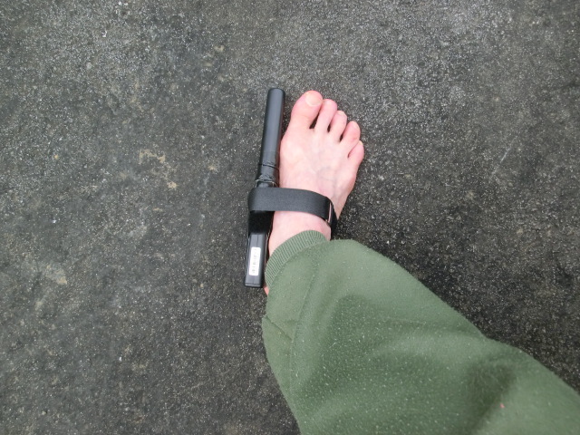

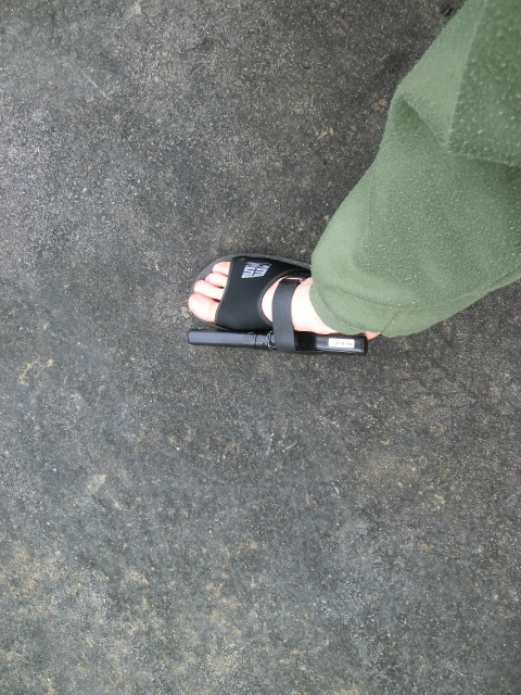

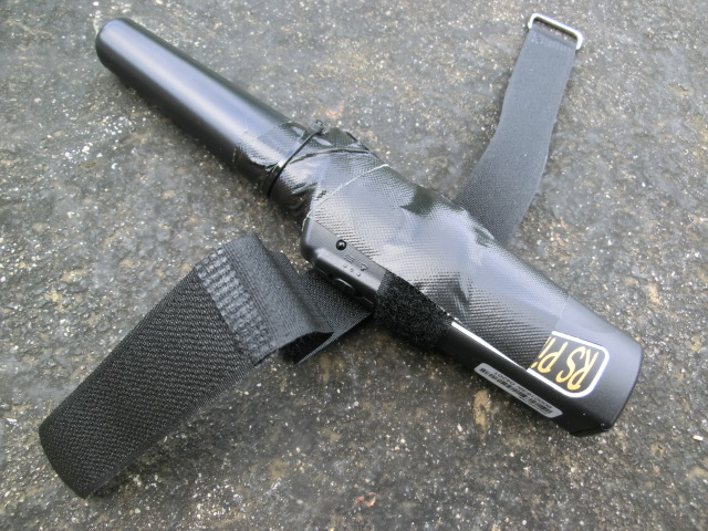

                                My holidays beach "invisible" solution with Nokta RS pinpointer in vibro mode:
