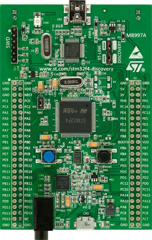

      ...new toy ...even cheaper than the UNO32 ..twice the power and specs
      • STM32F407VGT6 microcontroller featuring 32-bit ARM Cortex-M4F core, 1 MB Flash, 192 KB RAM in an LQFP100 package
      • On-board ST-LINK/V2 with selection mode switch to use the kit as a standalone ST-LINK/V2 (with SWD connector for programming and debugging)
      • Board power supply: through USB bus or from an external 5 V supply voltage
      • External application power supply: 3 V and 5 V
      • LIS302DL, ST MEMS motion sensor, 3-axis digital output accelerometer
      • MP45DT02, ST MEMS audio sensor, omni-directional digital microphone
      • CS43L22, audio DAC with integrated class D speaker driver
      • Eight LEDs:
        • LD1 (red/green) for USB communication
        • LD2 (red) for 3.3 V power on
        • Four user LEDs, LD3 (orange), LD4 (green), LD5 (red) and LD6 (blue)
        • 2 USB OTG LEDs LD7 (green) VBus and LD8 (red) over-current
      • Two push buttons (user and reset)
      • USB OTG FS with micro-AB connector
      • Extension header for all LQFP100 I/Os for quick connection to prototyping board and easy probing
      ....and many more features ...you will have to read the chip spec.
      (eg 4 quadrature encoders, 17 pwm generators, DAC, 7.4 msps ADC, ethernet, multi SPI )
      ...for only $20 at farnell
      THIS NOT A BOARD FOR BEGINNERS ...you have been warned. LOL

        yup, likes nice but.......
        too bad it only has 12 bit adc's on board,
        if it were 24 bit at 7.2 MSPS in triple interleaved mode

          ....yeh they dont seem to integrate fast 24 bit ADCs however the SPI will run at 40 Mhz and the chip has DMA which is handy for getting samples into the chip without processor overhead. ( The UNO32 has no DMA ... have to move to its bigger brother the MAX32 )
          I only posted it out of interest as a cheap CPU board ... the development environment is not as easy to set up as MPIDE.
          moodz.

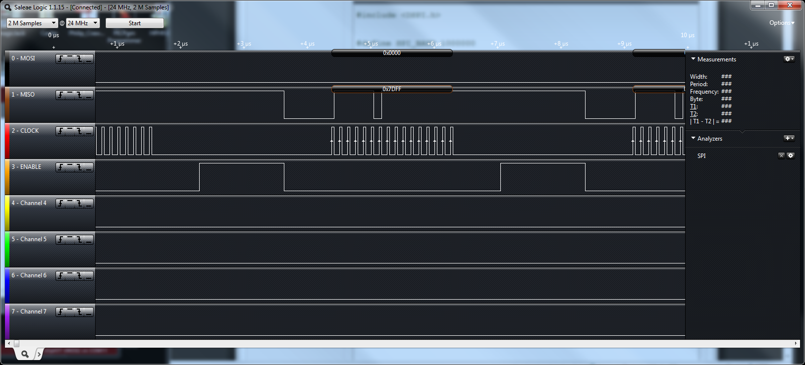

            oh, the post office just delivered the 8 ch logic analyzer.......

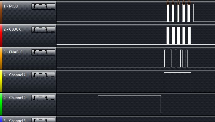

              16 bit success !!
              a quick update:
              i finally got rid of the gap between the 2, 8 bit samples. this should add a little more speed to the sampling process.
              next step: increase spi bus to adc rated spec
              in the picture below, spi is running at about 8 mhz
              Philip

                                here's an update,
                                This is a screen shot of some of the timing pulses,
                                1 adc data out spi
                                2 spi clock (16 bits)
                                3 the logic "high" would be the sampling window
                                4 logic "high" controls a switch to allows the adc's preamp to be connected to the coil.
                                5 TX pulse
                                I've been working on the code for the sampling averaging. some of the ideas I've been thinking about are:
                                if theirs no detectable sample, start the TX pulse again.
                                only update the display with an valid sample.
