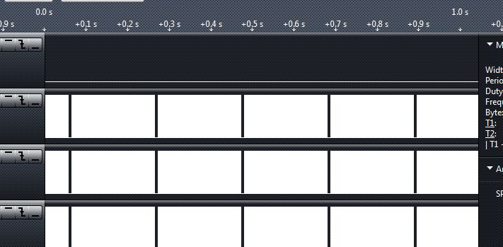

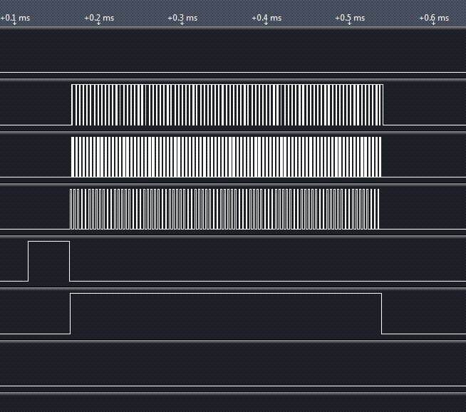

      hear's the latest,
      The white areas is where I'm sampling,
      The black areas is where i'm writing to the LCD display which is 7.62ms, which is about 5 times per second,
      so, in conclusion, black areas= missed GOLD!
      In my code, i'll only write to the LCD when i have a target,
      and on my LCD, i'll display the target decay. thats the only way i can figure it on a single threaded cpu............
      I'll be posting my code up to this point soon!

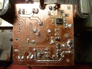

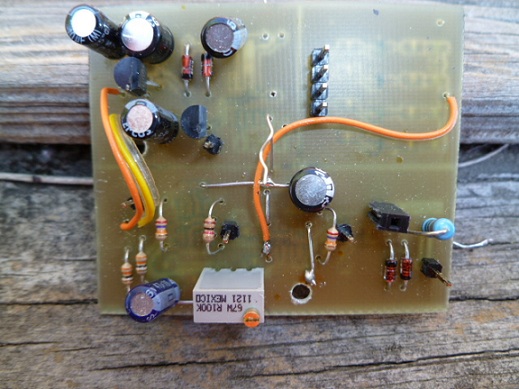

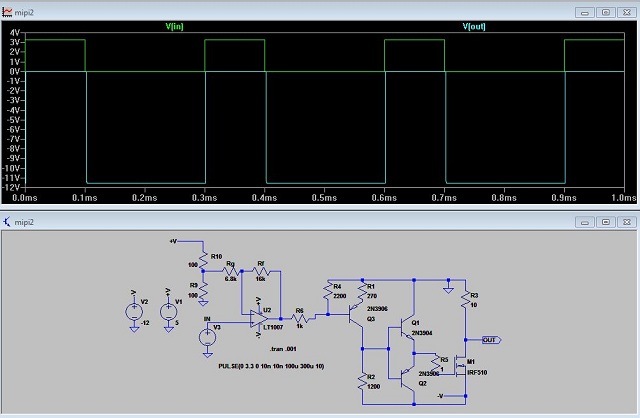

            well, i've been busy,
            I built the Xpi computer board, it's going to take a bit more time than I thought, to figure it out.
            So to test my chipkit metal detector idea, I now need to build some sort of coil drive, for this, i'm going to use carl's hammerhead 2 mosfet drive, it's pretty easy to build, great for starters.
            But I had a problem, I wanted to drive it with an 0 to 3.3 volt drive, and the circuit was made to run on -12 , even the pic12f683 was between -12 and gnd.
            so i came up with this circuit, i did a Ltspice sim, and it work, so i went ahead and made a pcb and it worked
            next step, mount the driver board to my project board see if it works, if it does, i'll go ahead and throw a few diodes in, a resistor, hook up a coil see what happends,
            Then I'll work on the software a little more, i want to see the target decay on lcd screen, that's the goal for now.
            attached are pictures.
            and my LTsim file.

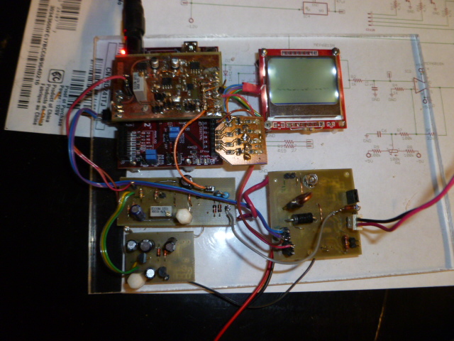

            • #51

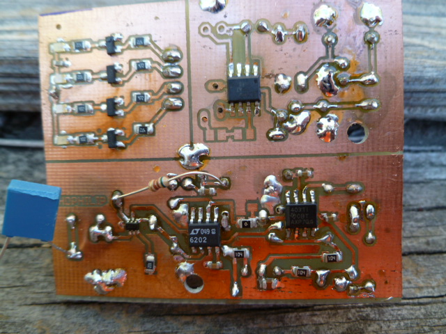

              another update:
              on my driver board last post, you can see some PC board tracks UN-populated, those are
              for adum3220 isolated mosfet driver ( i want to try out Jon's idea a few post back) it has 2 channels, so i'm planning to use a channel for the TX drive mosfet and the other channel will control a damping mosfet. this damping mosfet will have a resistor in series with it, not sure about the value yet.
              The pictures below are the coil preamp, basically it's Carl's hammerhead 2 circuitry, the op amps are Lt1602 and the second stage is a THS4031, the input is controlled by a DG4157 switch.
              also on the board is a 7660S power supply for the +5 and the -5 op amp supply.
              now comes the fun part..........
              The corner board is 4 LED's yellow,orange,green,red
              here's my idea,
              i'm planning on having many different TX profiles, or what i'm calling events, each event may have a different TX pulse length or a different averaging algorithm.
              So when an event detects something, it will light an led, that way i'll be able to figure out which event works the best, and i'll be able improve on it.
              the resistor on the copper side is to keep the mosfet switch close for testing on my bench
              Philip

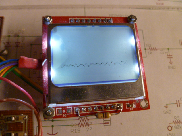

                well, it's been a little while sense my last update, now that a few threads of excitement has settled down, here what I've been working on.
                one of the goals i wanted to do was be able to display the target time constant on my LCD screen, finally got it working, it's kinda crude right now, but interesting, i,ve included a few pictures and also the timing diagram for reference, the TX pulse is 50 us long, the other logic diagrams are from top to bottom
                mosi- nothing their yet, future, audio out via spi dac
                miso - spi data in
                clock- for spi
                enable- conv pin on 16bit adc
                TX pulse- 50us
                input switch- a spdt switch on the front end

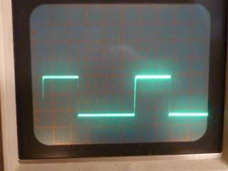

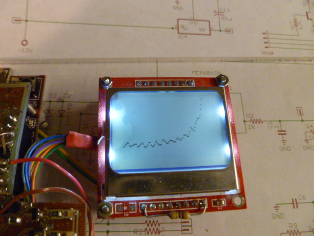

                • #53
                  hello
                  just to add on my last post,
                  The reason I'm displaying the target decay on the LCD screen is , I wanted to be able to "see" the information that the computer is looking at, kinda like having a window looking into the microprocessor.
                  the way it's set up in the above picture, each horizontal pixel is about 4.5 us,
                  The middle picture seems to show a somewhat of a sine wave, interesting, i'll have to see why
                  Right now, my front end only has 1 op amp, but i'm planning on making another board.
                  my next version I'd like to include a Low Pass Filter and a High Pass Filter, the LPF I'm thinking 1.5 Mhz for the LPF but I'm not sure about the HPF.
                  anyone have some ideas about front end filtering?
                  Philip

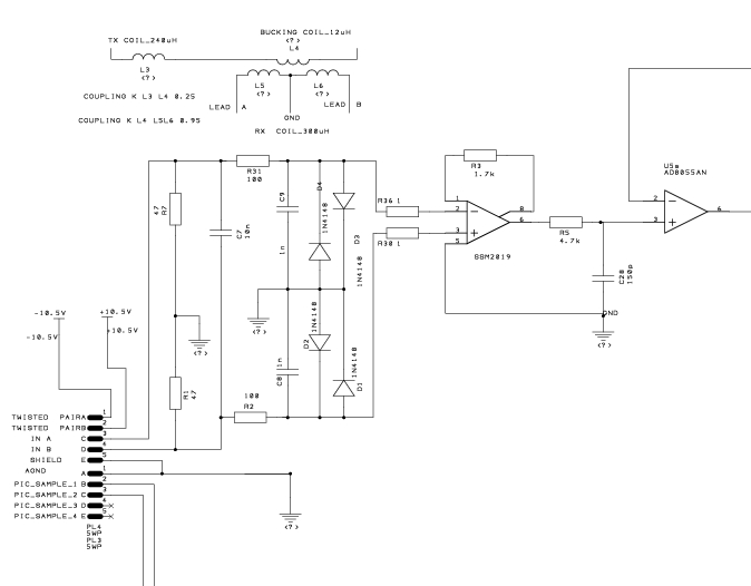

                  • #54
                    Originally posted by hdphilip View Post
                    hello
                    Philip
                    Attached is the differential input filter I use, limiting the bandwidth to the needed frequency.
                    Tinkerer

                      • #56
                        hi Tinkerer
                        I was looking at your schematic. i see your usuing r5 and c20 as a low pass filter, I'm thinking i'll need to do the same, right now i don't have any filter in the preamp section, so on the next board i'll leave some space for it.
                        what are your thoughts on adding a high pass filter or would the benefit not worth the trouble?
                        Philip
