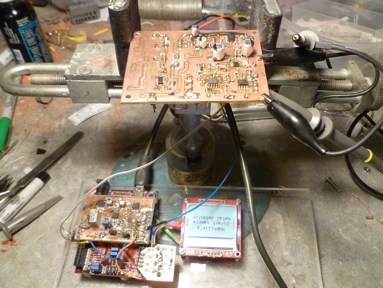

                    Here's a picture of my new front end board going through some testing.... So far so good!!!
                    • #85
                      Originally posted by hdphilip View Post
                      chudster,
                      An metal detector os would be great, on the software i wrote, i'm trying to do it by having a bunch of different subroutines, which i can put together like "LEGO's" building blocks to try different ideas
                      hopefully in a fews days i'll have my new adc board ready for testing..
                      Wow that looks like a great test set up!
                      Could you describe:
                      a) What is the board that hooks over the chipkit (Power?)?
                      b) What is the board on the side of the chipkit (ADC?)?
                      Chudster
                      • #86
                        Could you describe:
                        a. that's the adc board it has a buffer amp
                        b. that's the LED board, i use it to indicate different triggers i set up in the software,
                        one of the Experiments i want to try is using an comparator inside the pic32 to determine when the fly back ends, and maybe show the time in nanos on the LCD screen, it could be usefully, who knows, never seen it done before.
                        on my test board, i have a un used op-amp to act as a buffer between the trigger input, what do you think?
                        Philip
